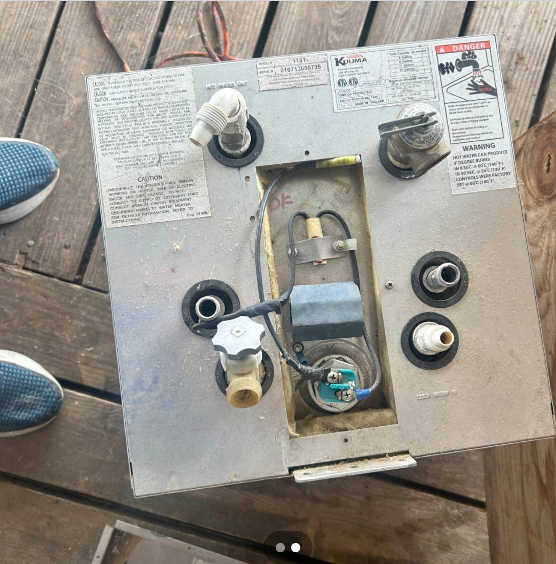

Nice. Kumma was not known to have much insulation around their tanks. I’d replace the element and be sure the proper fittings are screwed into the inlets. Some folks used the wrong thread. They then leak. Might want to pressure test the tank and the water coil.

Thank, It hasn’t been used much. Serviced it. Guy wanted $200 for both but we traded him for this drawing I did of a Buzzards Bay 25 by N.G. Herreshoff instead.

There is nothing wrong with a Kuma heater. In fact it is the only company that has made the effort to have their water heaters UL listed. As your photo shows, the tank is pretty well insulated. A Kuma much more affordable than a Raritan. Check FisheriesSupply.com and Defender.com for prices.

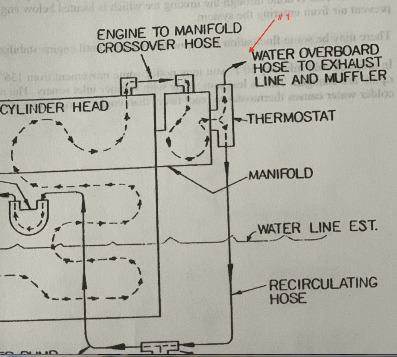

Look at Post #14. The water exits from the engine block, enters the HW tank and returns to the exhaust manifold. Use a good quality heater hose. Trident.
