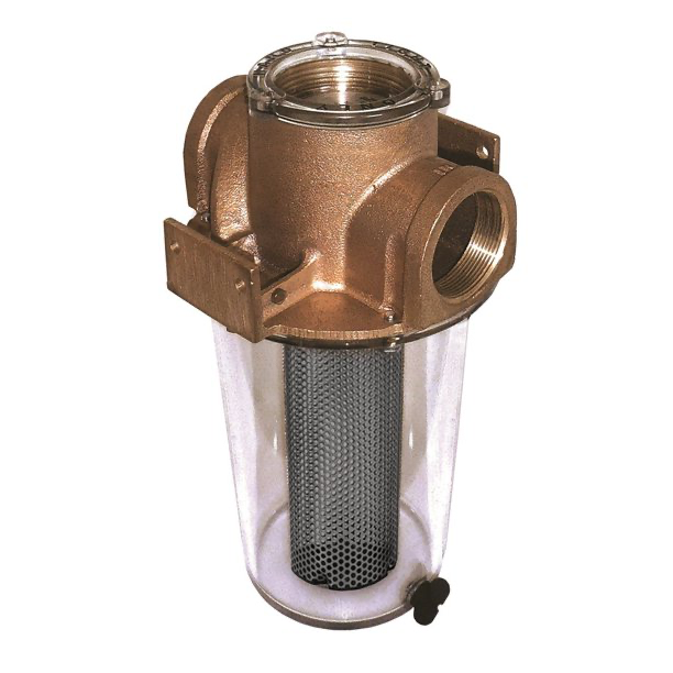

I used a filter like the one you show, on my new to me boat for about 6 months. It was readily available and not expensive. It was when I tried to clean it I realized it was not appropriate to the purpose. The plastic was degrading due to saltwater exposure and temperature. I removed it, tossed it.
I installed a Groco ARG-750 . Substantial construction able to take the boat conditions of near freezing waters and simple to maintain. Now in it's 7th year of service without any issues.
Cleaning from the top. Filter basket slips up and out. Hand tightened cap. No leaks.you can drain the jar using the bottom plug.
ARG-750 Series 3/4" Raw Water Strainer with Monel Basket
Features:
  • Mounting System Allows Removal Without Tools
  • Bonding Connection Both Sides
  • O-Ring Seal All Joining Surfaces
  • Filter Basket Options: #304 SS (Standard), Monel & Non-Metallic
  • One-Piece Molded Sight Glass Eliminates Tie Rods and Gaskets
  • Improved Drain Plug
  • Non-Metallic Cap Magnifies Internal Viewing
  • NPT or BSPP Threaded Ports
  • Improved Basket Design
  • C84400 bronze head casting
  • UL Listed 255-D

Oh, and going back to the "filter". I've always seen instructions that show the strainer mounted in a vertical orientation, with the bowl on the bottom. I agree with @Captain Larry-DH ... the "filter" being substituted for a strainer and not mounted properly could be a problem.

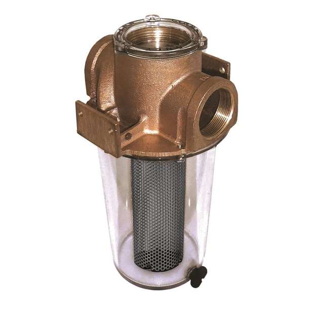

Features:
  • UL Listed 255-D

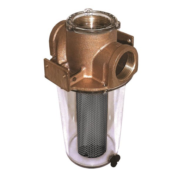

nice but a little pricey for me. But I would absolutely like to not only replace but also upgrade the 100% plastic strainer I currently have
ill see if I can find something in between
