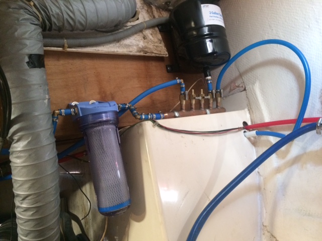

Hello Smunkey, my wife and I are in a similar situation to you. We bought a 1984 Hunter 31 last August and are fixing it up. We are finding most all the hoses are near the end of their life. Even if they are still functional, there is peace of mind knowing they are brand new!
For the freshwater system we replaced all the original polybutylene with blue/red pex. I think it's a good upgrade and is easy/fun to do. I bought the crimp tool for about $50 and crimped all the fittings. One feature of our new system is I installed a five port manifold from pexuniverse.com that has an on/off valve for each outlet. This allows us to isolate any faucet while leaving pressure to others. May be something you want to consider doing?
I actually just ordered an accumulator on Amazon today, the 2 gallon model instead of the 21oz shurflo one, which is probably overkill! I can post a picture after it's installed.

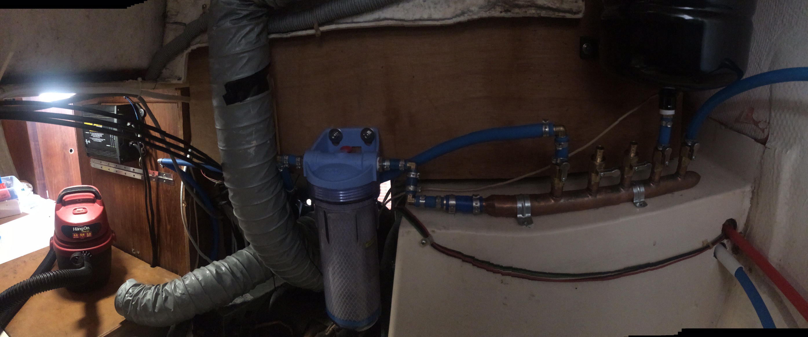

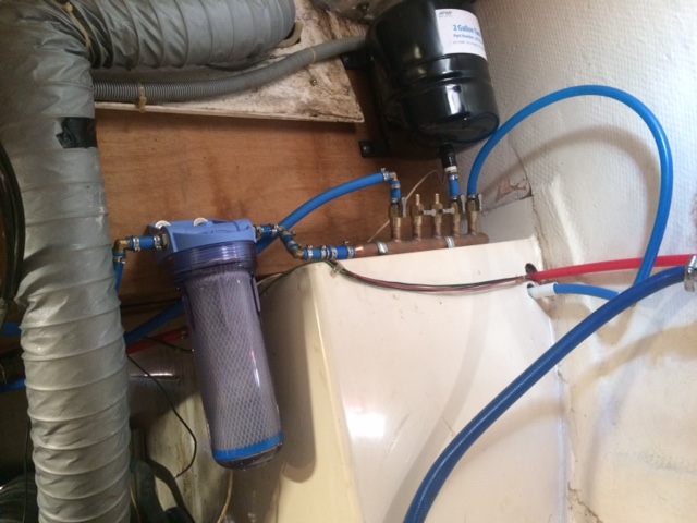

As promised, here are some pictures of our install of the 2 gallon accumulator ($40 on Amazon) as well as the water filter ($28 for the housing and $25 for four 1-micron carbon activated filters).
I can now run the tap on full about 20 seconds or low for nearly a minute before the pump kicks on. Note that instead of putting the accumulator in-line before the manifold, I attached it directly to one of the manifold outlets instead.
The manifold still has two empty outlets. One will be for the hot water tank, which I don't have hooked up yet, and the other will be for a deck shower. For hot water, I pulled the old hot water tank out and threw it away, even though it was still kind of working. It was rusted out. Now we just need to save our pennies for a new one.
