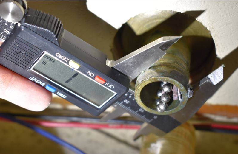

Our hoses from the water deck fills to the fresh water tanks along with their respective vent hoses are both likely original are almost black inside from gunk. I measured the OD of these hoses and found they were 1.25 inches for the fill hoses and .75 inches for the vent hoses. However, I failed to take into consideration the inside diameter.
By any chance does anyone happen to know the inside diameter of these hoses?

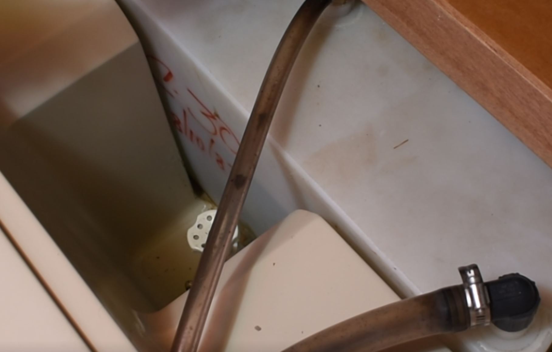

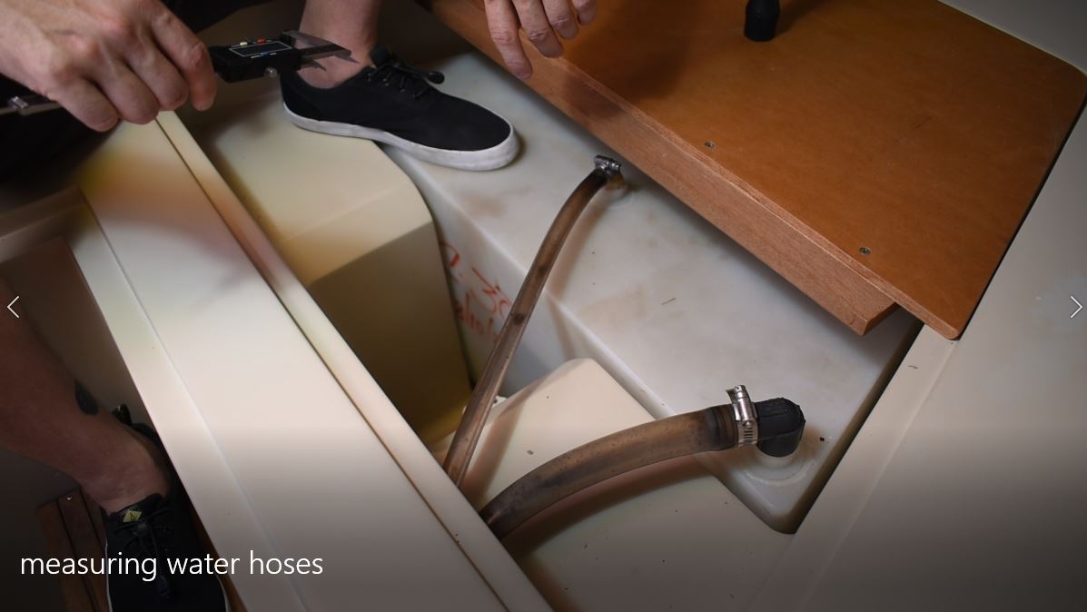

lpbosch, our vents are on top of the tanks, and the hoses go into the bottom of a stanchion. I will attach a picture from when I was measuring the hoses.
Thanks for the info Peggy. I have read tons of your information. You are the reason I bought a new water heater and an anode to go in it. I am still a little confused in regards to the hose size though. I used a caliper to measure the diameter of the pipe and it was 1-1/4" OD. If the standard size for fill hoses is 1-1/2" ID, then I must conclude that my hoses are not standard. But I think the information you provided gives me the answer. Thanks!

If it's 1.25 OD, it has to be 1" ID....which isn't the standard size for a fill hose. Neither is the clear nylon hose shown in your photo...although the fresh water plumbing can often be clear nylon hose, tank fills and vent lines are flex PVC #148 on every boat I've ever seen. So I have a strong suspicion a PO has replaced the water tank and spec'd non-standard hose sizes AND type. What's more, the hose that appears to be the vent line is running DOWN and--assuming the tank is in a settee lying against the hull-- away from the hull. If that's where it is, it should go up to a stanchion. How old is the boat? What does the writing in red on the tank say?

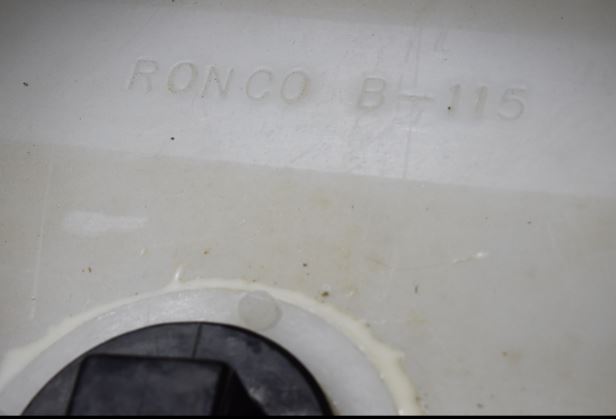

Thanks Peggie, the boat is a 1988. The writing on the tank says C-30, then under it says 8/10/87 (which is the production year if I remember correctly). Here is a closer look at the writing. I am happy to learn that the standard is flex PVC #148. I will surely replace this with that.
The pictures are a bit misleading in terms of where the hoses go. This tank is in the v-berth and the picture is taken from aft, so the hoses go horizontally, and then turn up towards the fill and the stanchion as soon as they 'leave' the picture.

Ok...it's an OEM tank, almost certain to have been made by Ronco...they've supplied all the water and waste tanks to Catalina for at least that long. It's highly unlikely that those clear water hoses are original though...I suspect a PO replaced 'em and went as cheap as possible 'cuz clear water hose is about half the price of #148. But I'm baffled by the 1" fill...I've never seen one before--water, waste or fuel--that wasn't 1.5", but that tank fitting is obviously original and Catalina has always done some unique plumbing...for instance, they're the only production builder (US anyway) who runs vents into stanchions (took 'em 20 years to realize that's a good idea for water and fuel, but not for waste and start running holding tank vents to a thru-hull). What size is the deckfill fitting--1", or is there an "adapter" at that end to make it fit a standard 1.5" deckfill?

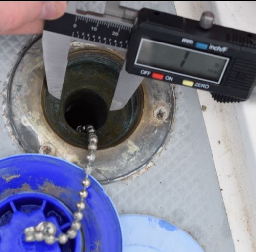

I braved the chilly 26 degree wind and precipitation (that's pretty cold for Texas) to go measure. I wasn't able to get a good measurement on the top of the fill under the cap, but I could see there was no adapter or anything. Here is a picture of that:
(you can sort of see the hole is 1", the threads on the cap seemed 2")

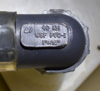

Anyway, since I will be replacing all associated hoses anyway, I took off the panel to access the underside of the fill, and it was in fact a 1" fill tube somehow. Here is a picture of that:
I also grabbed a pic of the model number that was on the tank:
as well as a close up of the elbow part that the fill hose connects to:
There did not appear to be any adapters on this end either, that elbow goes directly into the tank.
Now that know the sizes for certain, I can source some flex PVC #148 and make it right, or as close to right as I can. I plan to add a filter inline on the vent as well.

Nothing wrong with a 1" fill hose. The garden hose to fill it is no more than 3/4. My 2 cents is to take the chain off that links to the cap. you'd be able to get a hose in there and not have to hold it. While you're at it, chamfer the outside of the deck fitting to make getting on the hose that much easier.

In 30 years, this is the first 1" deck fill I've ever seen. Now that I have, owners of older boats that have 'em will prob'ly start coming out of the woodwork!

Not so sure about that, Peggy. It's hard to tell from his picture, but if he measured the THREADED cap, he might find it the same size as 1.5-hose deck fittings. His one-inch caliper reading suggest the pipe throat is,say, 7/8? I don't think a garden hose with a metal fitting will fit in there enough to allow it to sit on it's own so the crew can go do other stuff while the tank fills. If he keeps stuffing the hose into the fill, sooner or later the chain will break- trust me on that one. My waste cap- and I'm sure others- do not have the chain because the pumpout hose has to either screw in or form a seal around the fitting. Other readers, does you waste have a chain on it? My waste cap does not even have a screw-hole for a chain. In 10 years I've not lost the waster or water caps, even with bi-weekly fills and pumpouts. It's just common sense to put the cap down on the seat, not on the deck.
