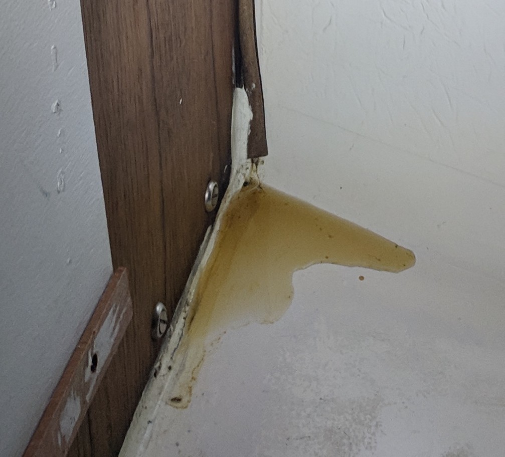

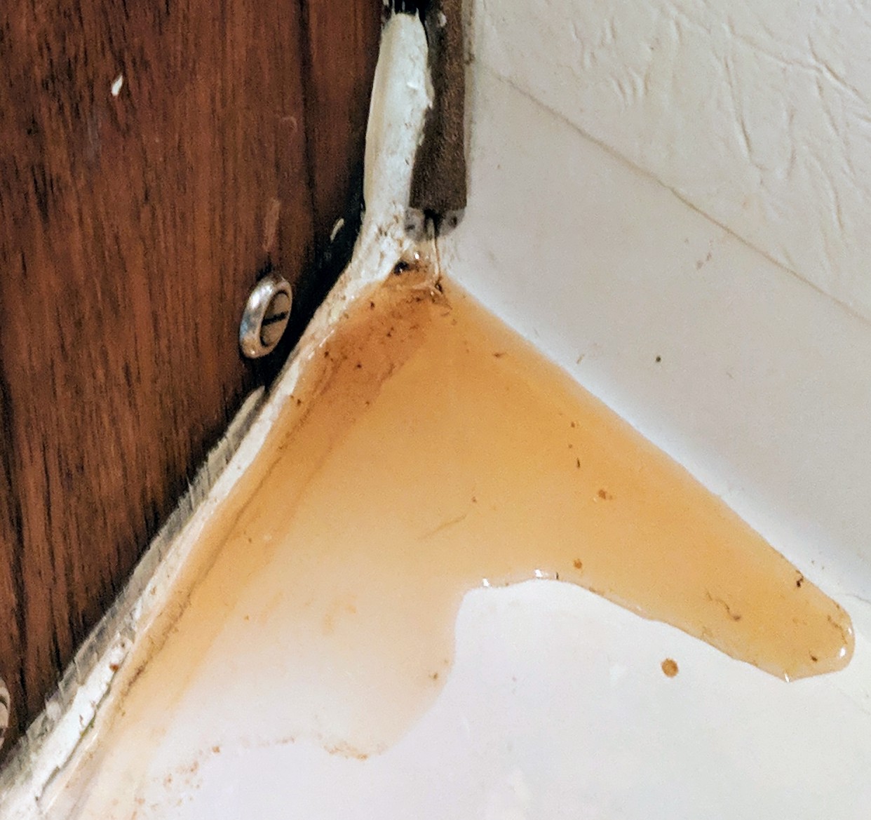

Adding photos.
Looks like the sink tubing is dry. Isolated leak
to the base just above the puddle.

If that tight pic is the top of the vee berth liner that’s not a source area. Unless its salt water and you have a hole in the hull. Then you have a larger problem!
Is there staining down the bulkhead (indicating a leak from above like a deck or hatch source) or just water at the bottom (indicating it’s coming 1) under the bulkhead or from 2) the anchor locker or 3) a forward stanchion)?
If you have a bedding leak and n the deck water can travel thru the core and appear somewhere else.

That looks to me like it could be coming down the bulkhead. The first place I would look is the forward shroud chainplate attachment.
As Ken says, any leak at any deck fittings can travel a bit but this far forward I still think the forward shroud deck attachment. That and the mast tabernacle. Does the mast base look a little sunken, kind of a like a bird bath? If so that is a sign the deck in that area is wet.

I would try putting powder or a sidewalk chalk line on the vee, or laying paper towels there. That corner was the low spot of my vee, and when my anchor box leaked it puddled there.
