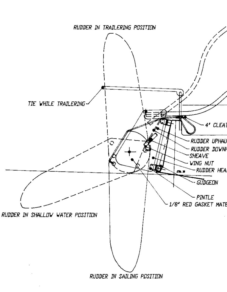

Is this pic what your looking for Dave? This is for a H23.5. The drawing is pretty busy, but you get the idea. I never used the setup on my boat. Id just move it up and down by hand. But I normally only had to do that at the beginning and end of the season.

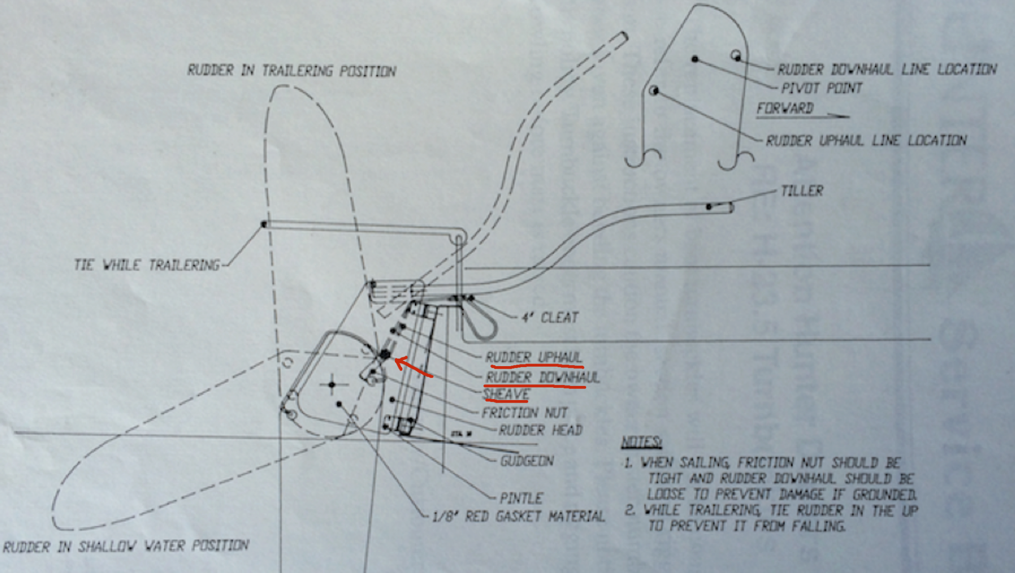

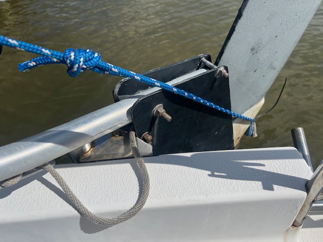

Dave, On my H23.5, I don't see any blocks on the rudder uphaul line. I attached a picture of my rudder, in the UP position. I also attached a copy of the rudder drawing from the Owner's Manual. I don't see any blocks, unless I'm missing something. I hope this answers your question. The blue line is just to hold the rudder in the UP position.
Cheers,
-Adrian
