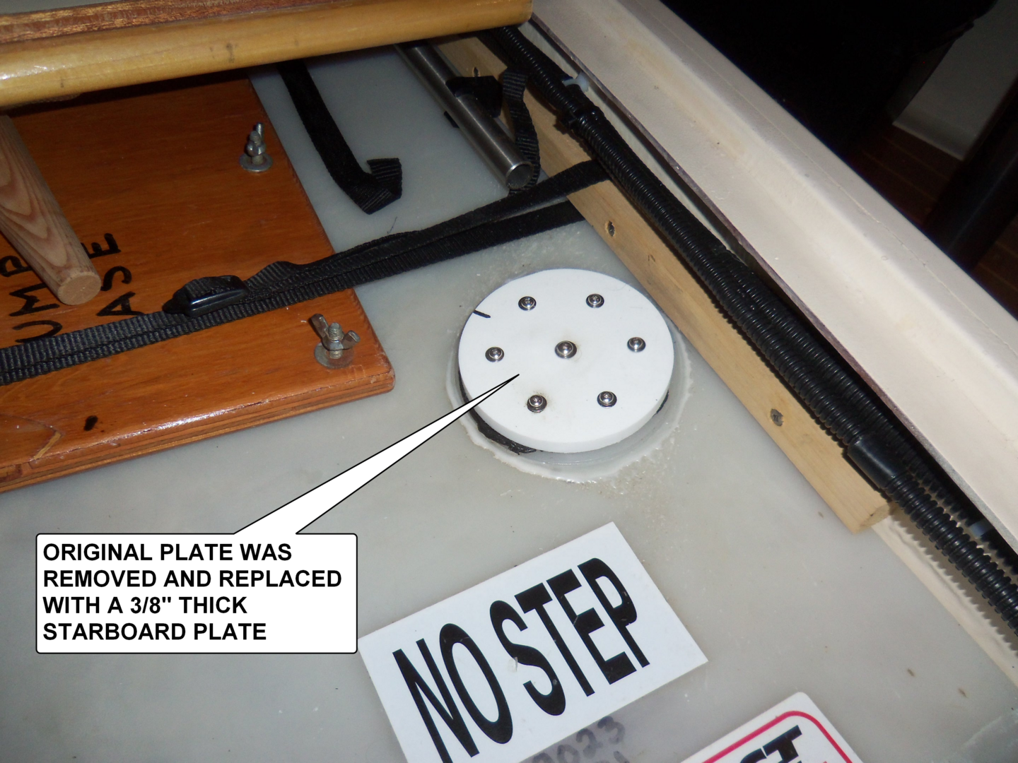

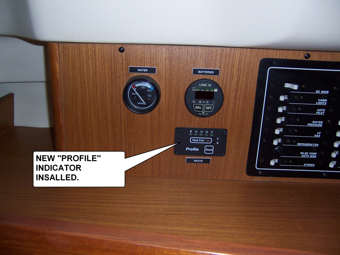

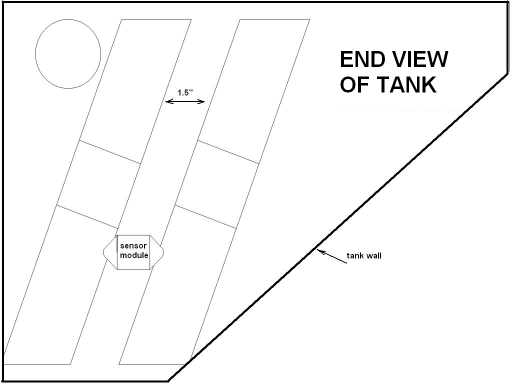

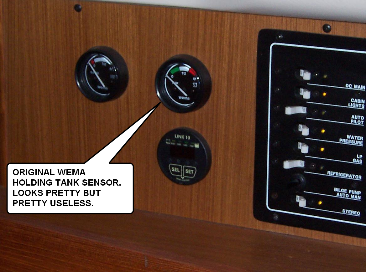

I am wondering if i can change the level sensing to the same as the water/waste tanks (outside copper strips (measuring capacitance, i guess). This way i don't have to mess with the inside sensor.
That's exactly what I did a couple of years after getting the boat new in 1999. If your current sensor relies on a float in a cylindrical cage, mine never worked for more than a few weeks after each cleaning. You can use your existing wiring but the sensor and indicator will be all new.
The above should say "ORIGINAL SENSOR".
Due to the shape of the tank, the sensor strips were mounted at an angle on the recommendations of the manufacturer.
