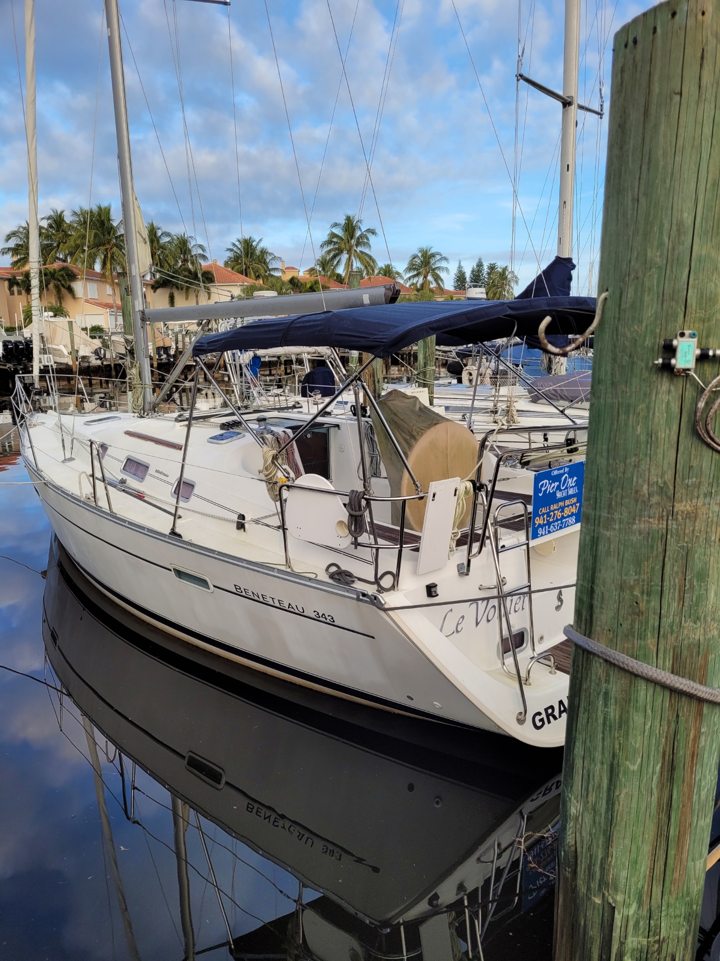

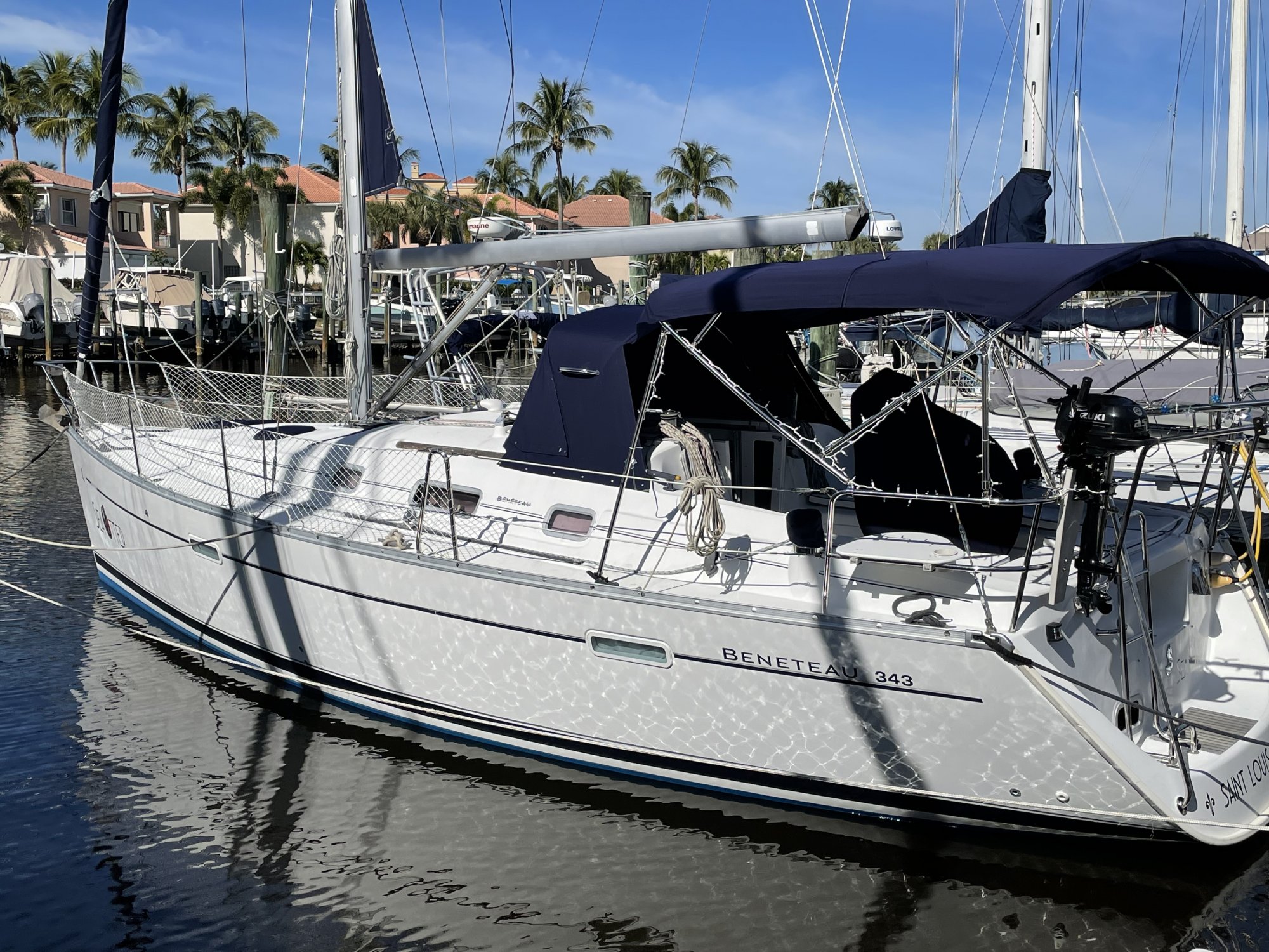

I can see you take great pride in maintaining your boat. She looks nice.
