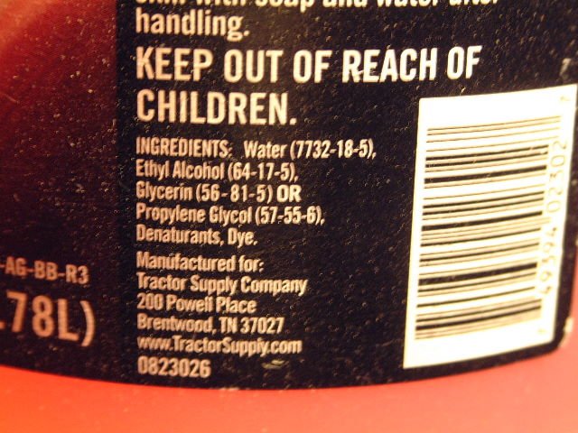

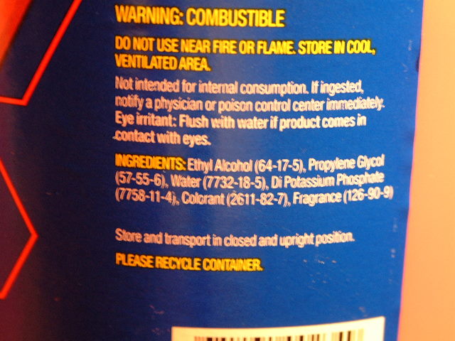

Sure enough, the label on the Super-Tech WalMart brand says it is combustible and has ethyl alcohol as well as propylene glycol. So I looked at some left-over stuff from last year that I bought at Tractor Supply Co and it is also combustible and contains ethyl alcohol as well as either glycerin or propylene glycol. Both products have a -50 F rating. Both are "pink stuff".
So I have been using this stuff for at least one year and possibly many years. Thus far my boat has not combusted nor have I noticed any evidence of any rubber seals vaporizing. I only use it in my toilets and maserator. I don't use it in my water system, A/C systems, or engine raw water loops.
Educate me please. What is the concern? See pix below for the labels. The blue label is the WalMart Super Tech that I just bought.

The Prestone RV Antifreeze at Wal*Mart is a PG product (SuperTech is NOT pure PG)
The Dow RV antifreeze is a PG product
Pah-Nol is also a PG product
If you are paying less than about $4.99 gallon it is cause for suspicion. In a PEX based water system the cheap stuff should be fine but if your system has PVC hoses you may want to opt for the PG/Water blend..
