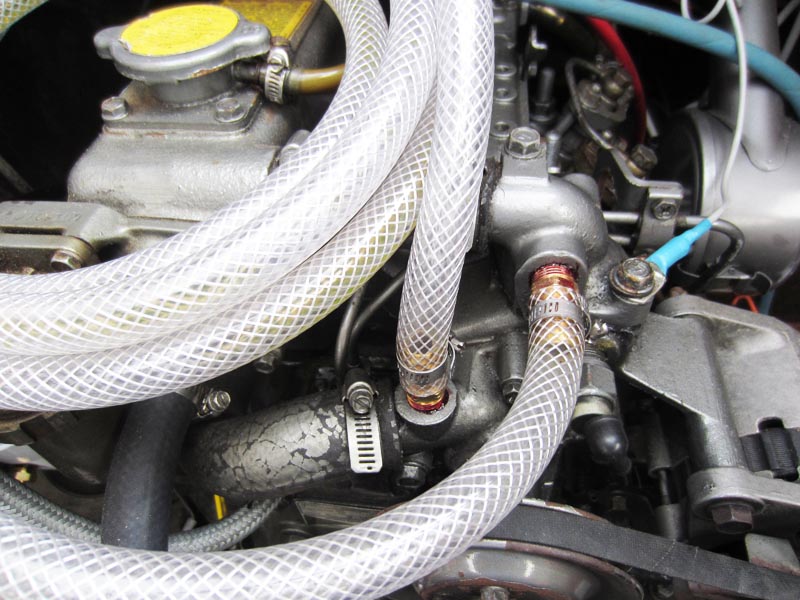

I've recently added a new water heater to my 30 foot sloop (S2 9.2A). The original water heater was not connected to the engine, but, since the new one offered that option, I looked in my manual, found and removed the two plugs on the FWP and thermostat housing, and ran half-inch hose from them to the new heater. Yesterday I fired up the Yanmar, which started reasonably well considering the mid-40's air temp and 50ish water temp. Despite running it for nearly half an hour (mostly around 2K+ RPM, with and without the prop engaged), I was seemingly unable to get it hot enough to open the thermostat. When I first removed the plugs a month or so ago and put in the 3/8" fittings, I temporarily ran a loop between the two fittings (the heater wasn't yet in place), ran the engine maybe ten minutes, and was able to see, toward the end of the run, some coolant coming from the port on the thermostat housing. The weather was admittedly warmer, but I should think that a half an hour of running should be enough to get the thermostat to open. I've got a digital temp gauge bolted to the thermostat housing. It read about 135 degrees, max, during the run. I'd left the coolant cap off so I could add coolant as it started pumping through the hose to the heater. I don't think that ever got over about 80 degrees. I suspect it might've gotten hotter if I'd run it closer to idle, but I thought that wasn't good for the engine.
Is it typical for the thermostat to not open under these sorts of conditions?
Any recommendations on what sort of procedure I might follow to get it hot enough to open, rather than waiting for spring time?
I'll attach a shot of it when I just had the loop set up, for what that's worth. Once this is done, I promise I'm replacing all those hoses, cleaning the heat exchanger, putting in fresh, extended-life coolant, etc.!
Thanks.

John two things here first the hose to the right of your pic is after the thermostat and should be before ...there is a plug lower down on the t housing that you need to tap in to
second i would not trust that hose on a permanent install you need to get hose rated for heater hose ......you may need to burp your lines when you install them in order to fill the lines with coolant.....

after getting the plumbing straightened out, it may work better....
BUT.. about the thermostat,
if it doesnt open, the engine will over heat.... if its stuck open and does not close, the engine will NOT come up to temp without being moderately worked...
so after getting the hose routing correct, if it still does not come up to temp, you may need to install a new thermostat.
also, do you know what the temp of the thermostat is?.... it may be so low that the engine temp will never come up to an acceptable temp to produce a reasonable amount of heat from the heater.... 160degree would be a minimum in my opinion... 175 nor 180 would be optimal, but ONLY if is acceptable for the engine.
In most cases wire reinforced heater hose is used, presumably so it can't collapse when under vacuum as the engine cools. I've never seen that clear water hose used on an engine, it may work for awhile but I think it's very dicey.

The thought with this hose was that I could watch the coolant move through it to ensure I had the right ports, etc.. Woody, I pulled the plugs per the manual. I'll post the relevant page shortly.

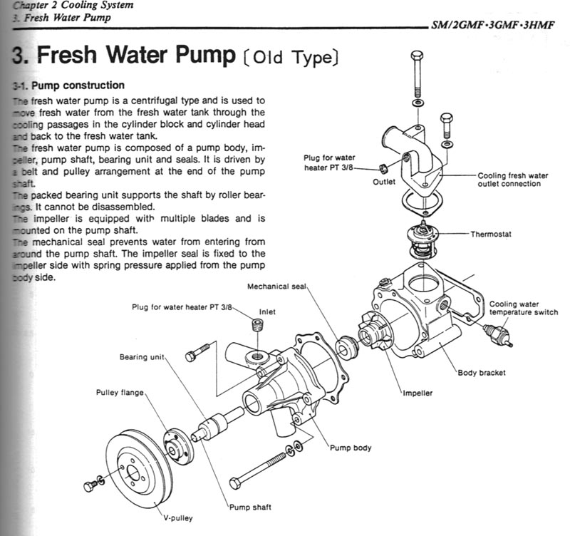

Here are the two relevant pages from the manual. I went with the older-style pump for the plugs to remove, based on my serial number. I think my temp sender, though, may be in the newer models position. I did try to remove the plug that Woody's suggesting I use, and it rather promptly stripped the hex fairly badly. I have an EZ-out to try, but don't want to go that route yet, if it's not totally necessary.

Got back to the boat. Took print outs of both pumps and, despite the old serial number, I do have the newer FWP. I'll work on getting that stubborn, stripped plug out and move the heater output barb to that port (which, as Woody said, is before the thermostat). I'll go ahead and put in the new thermostat and hoses while I'm doing this. I'll also get some decent Trident heater hose ordered and installed. Once that's all in, I'll try the warm up procedure and will report back. It may take a bit as I'm still hoping to service the heat exchanger before putting in the new coolant. That's something I've not yet tackled.
