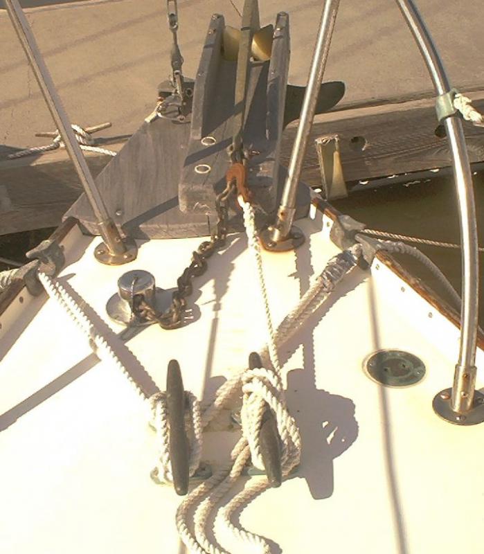

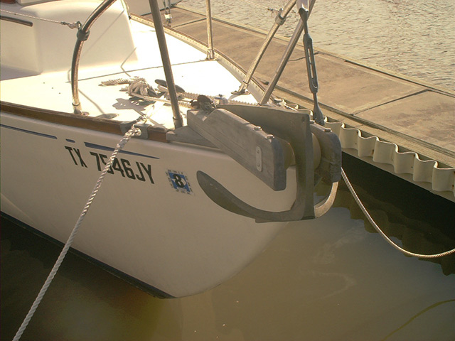

The bow of my 25. Those are 12 inch cleats
