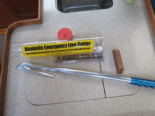

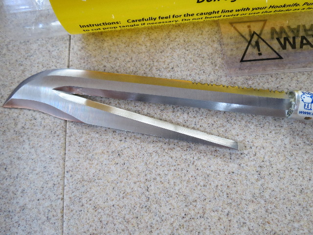

We rigged a line from one side of the stern to the other so that I could pull myself down to the prop. Using my hook knife I cut and ripped at the line taking pieces out until it was all gone.
This is the second time that I have used this hook knife to free us from lines that have snagged us. I can’t say enough good things about this knife.

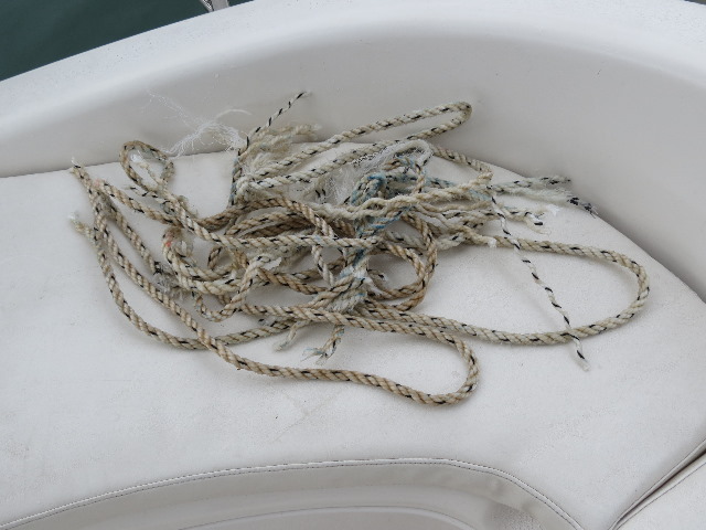

Below is the offending line and the “save my bacon” hook knife.

We leave NEH, again in the dead of fog, and motor to Campbell Island on the southwest side of Eggemoggin Reach. I decide I must go in the water. I have to be sure the prop is clear or clear it. As I feared, there was a wad of line around the prop and hub. It effectively jammed the prop so that the blades would not feather or go into reverse.
