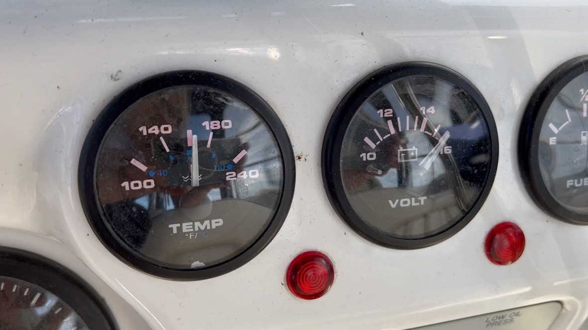

My Catalina 310 has an ongoing issue related to voltage readings.
My voltage meter pins itself (15-16) from time to time. Usually when a load is introduced.
After replacing battery 1, things seemed to settle down. Then I activated my auto pilot the other day and that sent my volt meter into hyper mode.
I have 2 Interstate SRM 4D batteries. Just replaced Battery 1 as the issue seemed to be isolated to it. Now the issue has reared itself with both batteries. Replaced the alternator as well (regulator is built in to alternator). The issue is intermittent. Sometimes it works fine and sometimes not.
Wondering if the Volt meter is the next swap out.
* Yes the batteries have been load tested resulting in replacement of Battery 1. All connections have been inspected and secured. Don't think its the regulator as it is built in to Alternator and that is brand new.
Any thoughts are appreciated.

Our 310 has a bum voltmeter in the engine panel, it shows 14.0 volts with just battery power, 15.5 - 16V when the engine is running. The small voltmeter down below at the electrical panel is normal.
Checking at the terminals on the back of the meter with a calibrated DMM shows normal voltage in both cases.
Shopping now for a replacement meter.
The point is, the meter can easily go bad with age, step one is confirm what it is telling you before changing other parts.

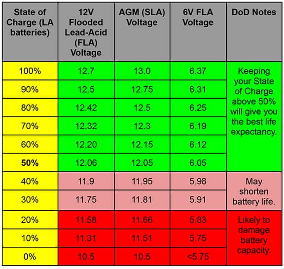

If replacing a voltmeter, consider changing to a digital display because you really can't tell state of charge with a sweep needle. The difference between 12.7V for a fully charged battery and 60% at 12.2V is somewhere around a needle width for a meter like shown in the OP. Roughly. Perhaps.
The meter at the nav station where the battery test switch is has a narrow needle but accuracy is still a guess so when I replaced it I changed to a digital meter. (The big square old meter simply covers a round hole so just measure the hole diameter before ordering the new small round display.) Then I used the Demo label maker to make a small list from a chart like above and stuck it to the top of the panel. It's a small white font on clear tape so is hardly noticeable along the white line at the top of the breaker panel. When I check the batteries it's now easy to refer the digital number to the label and actually know the state of charge for each battery.

Bear in mind the voltage does indicate the SOC, but tells you nothing about the batteries capacity. An old battery that has lost much of its capacity can still have voltage readings indicating it is fully charged, it will be fully charged but may have only a small portion of its initial capacity, amphours, left.
