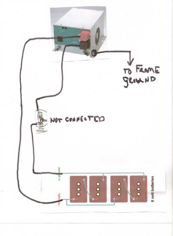

23,526
The photos are nice, but I've suggested many times that answers to almost all electrical questions require a wiring diagram. How about sketching one up, doesn't need to be too fancy, but should be correct as far as what you're doing, scan it in and post it. Could be we could help a lot more that way, 'cuz I've been following this and between the different wire colors and your statements about "that's not what I did but what I'm going to do," I'm confused at best.
Just to confirm that you're doing it right, in addition to your installation manual, http://c34.org/bbs/index.php/topic,6032.0.html
Thanks for the suggestion Stu. How is this?
23,526
AHA
Well, that's certainly helpful.
And exactly why it is NOT working.
The shunt doesn't go anywhere near the (-) for the I/C.
The shunt has to go between the (-) on the battery bank and the engine ground.
RTFM.
Again.
Maine Sail did a writeup on how to install a shunt. Go check on the musings with Maine Sail under Featured Contributors.
Here it is: http://forums.catalina.sailboatowners.com/showthread.php?t=125606
Good luck.

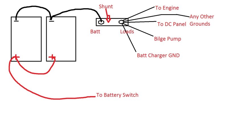

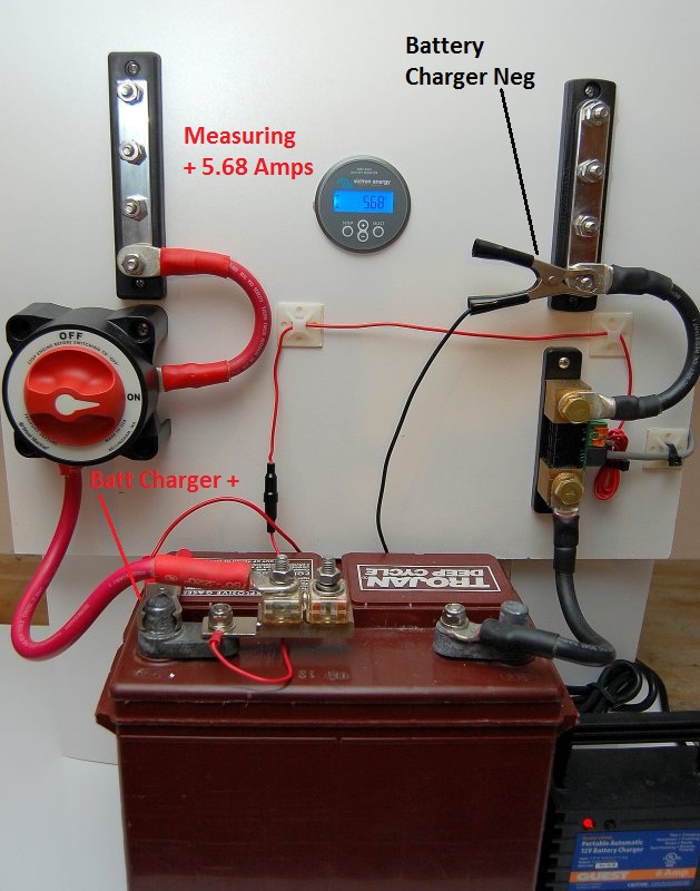

Thanks for the reply! I read the post that MS did on "Wiring and Installing a Battery Monitor." That is where I got the attached picture.
I am not sure where I would hook the negative cable from the Inverter/Charger? It has to go to the batteries.
Can you tell me where that cable would go if not to the shunt? It was connected to the battery directly. All I did was remove it from the battery and placed in on the shunt.

Do you see where is says, quite prominently, BATTERY CHARGER NEGATIVE?
Your I/C is a battery charger.
That's where you connect it.
Notice that it is downstream from the shunt, and on the wire from the load side of the shunt to the engine ground.
You should purchase a bus bar or a Power Post to make that happen. For the time being, to make sure it works, use a couple of washers and a bolt to hold the connections of EVERY OTHER NEGATIVE WIRE ON your boat.
Battery negative to shunt (battery side of shunt) only ONE wire allowed!!!
Shunt
Shunt to bus bar (from the load side of shunt)
Bus bar holds ALL other negatives
Bus bar to engine ground
Pretty much what the picture shows, and what the manual shows, too.
Look at the NEXT picture down on MS's article. It shows that.
Am I missing something?

If I do that RAD then the charge would not be monitored. Putting it on the other side would be the same thing as putting it directly on the battery?
The attached diagram shows how I have it hooked up now.

That line should be mine. "Am I missing something?"
With the exception of the bus bar that is the way mine is connected. If I put the charger negative on the "load" side of the shunt, isn't that the same as connecting a bus bar to the negative "load" side of the shunt and then connecting the charger negative to the bus bar as illustrated in the picture??
Yes, it should be, but that didn't seem to be what your sketch showed. The sketch implied that the shunt was between the I/C (-) and the bank. And the sketch didn't show the engine ground. Why not complete the sketch showing all the wires?
Whoops, you just did. Looks right to me.
