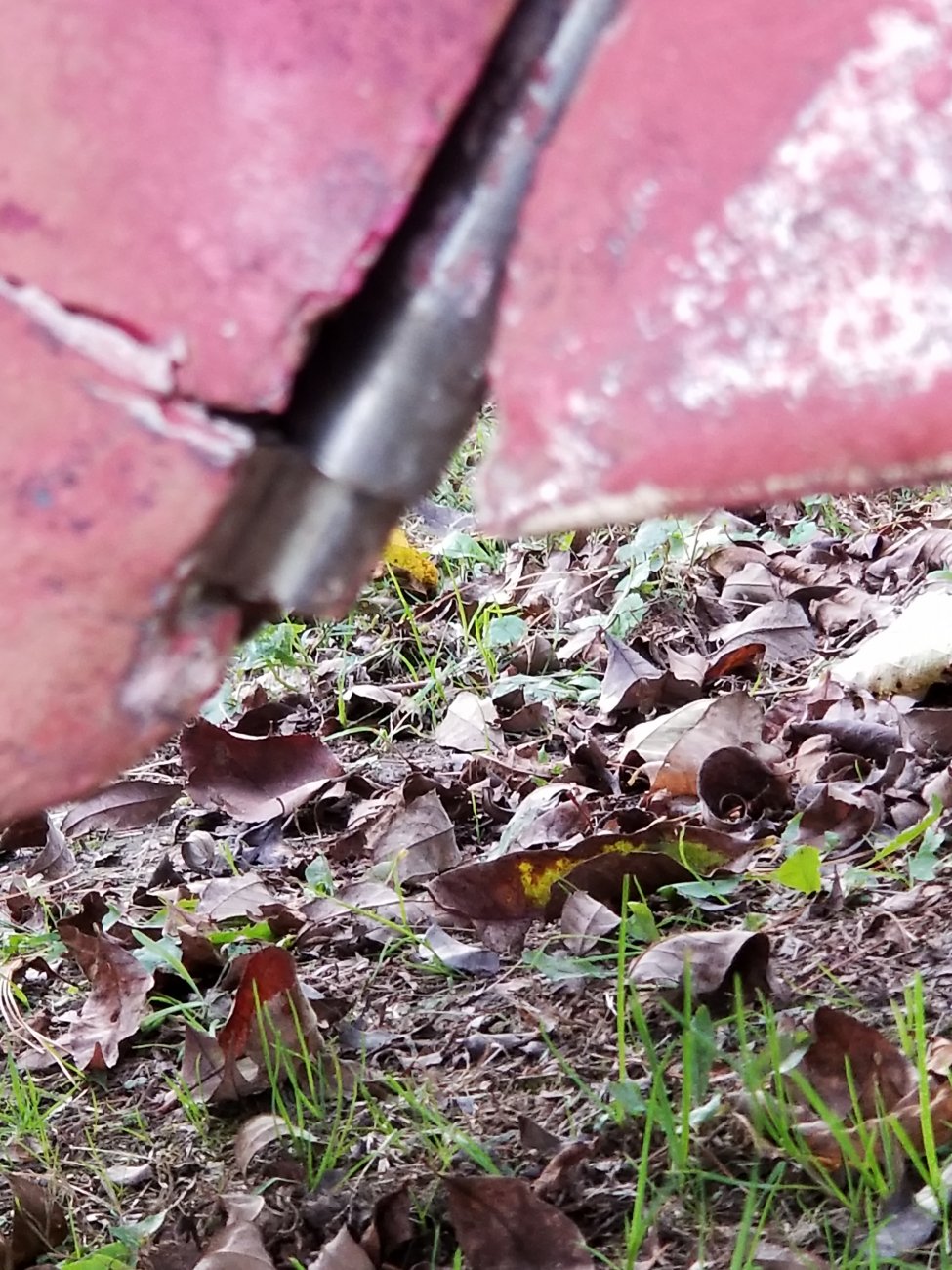

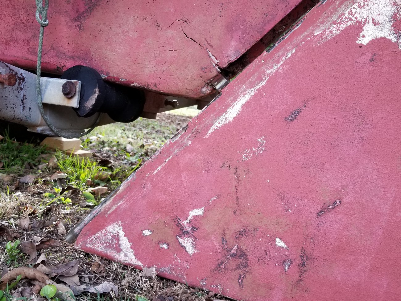

Ok, finally got pic. Rudder is hung at angle. To the left is toward bow. Leading edge of rudder has a solid stainless red with a shallow hole in bottom. It sits on the gudgeon but there is no pin or pintle or bolt to hold it in place. I used a screwdriver taped in place to get it home from lake w/o swinging around.

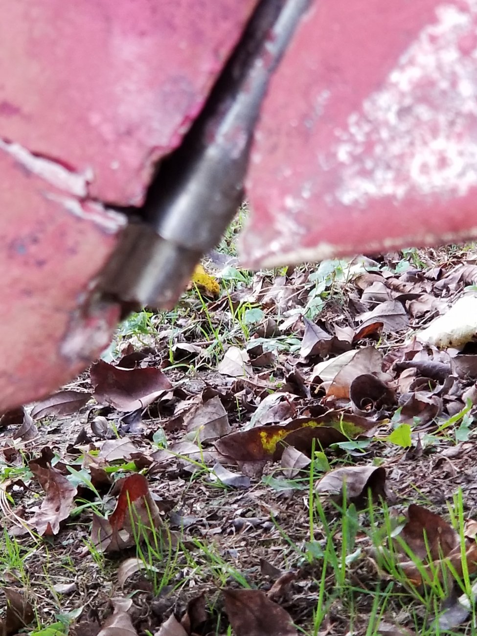

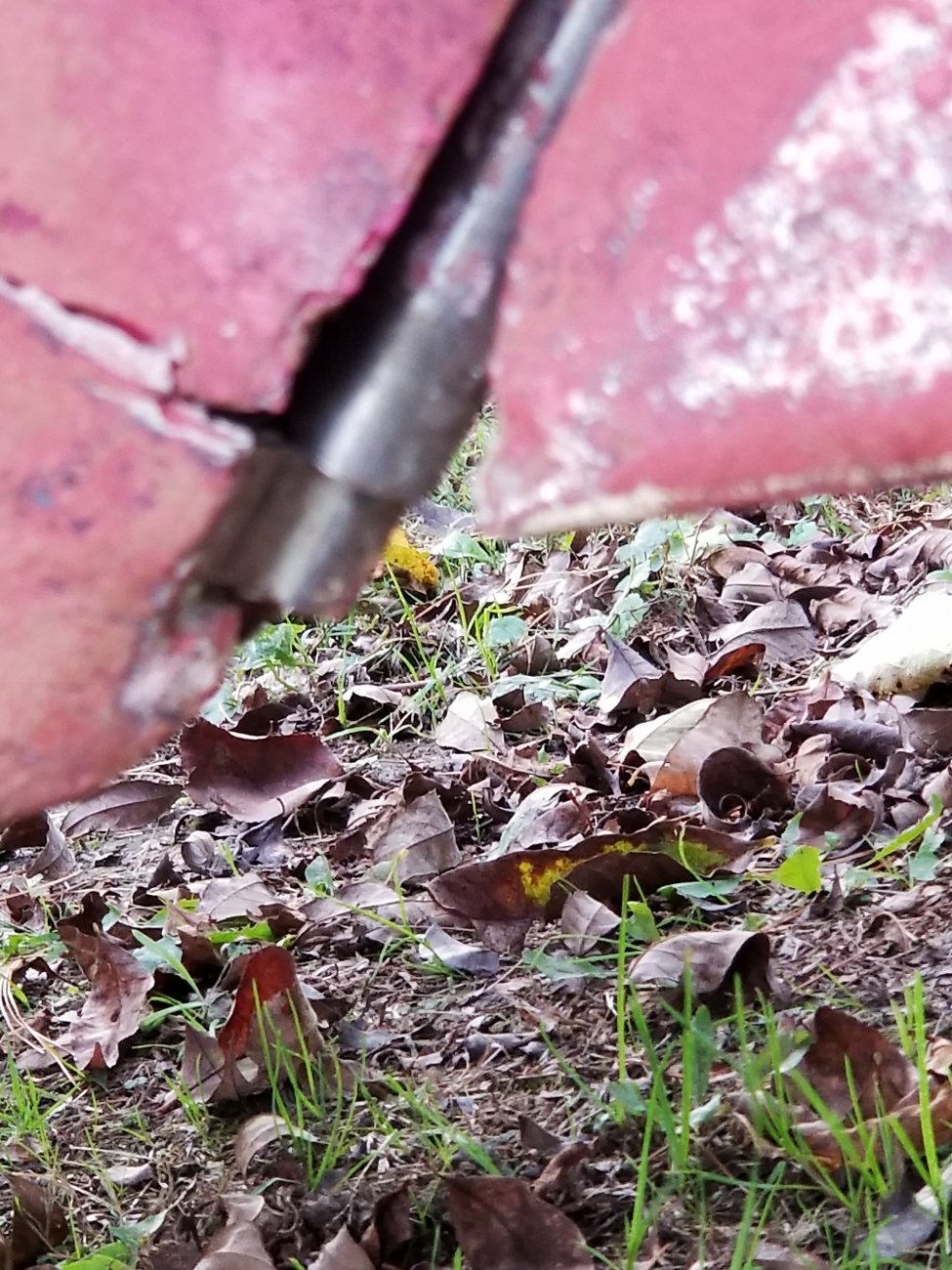

Here are four photos of the rudder. There is a stainless 3/4 inch rod that is attached to the leading edge of the rudder which extends all the way up through the deck where the tiller is attached. A set screw on the tiller hardware holds the rod in place. The bottom end of the rod has a shallow 1/2 inch deep hollow center. The gudgeon is like most gudgeons, a stainless piece where you would insert a pintle of some sort. The pintle is what is missing and it is, I think, a piece that is neither attached to rod or the gudgeon. Unless it WAS attached to the end of the rod and broke off. Or maybe it was a pin or bolt that simply rode in the gudgeon somehow. In one picture you see that I put a screwdriver up through the gudgeon and into the end of the rod and taped it in place for the trip home from the lake. My question is does anyone know what that piece (pintle) looks like and how it was attached to the gudgeon.

14,293
The weight of the rudder should hold the pintle in place. There may be something at the top of the rudder or the rudder head that helps to hold it.
The photos you posted didn't get posted... Oh well.
What does the top of the rudder look like? Especially the place where the tiller attaches.
It may also be the case that the lower gudgeon has become loose and needs to be repaired.

Time to get the grinder out to see what the gudgeon is no longer attached to. The problem does not seem to be a pin too short, rather a gudgeon too low. Finish taking the rudder off and then get to work with grinder, chisel and hammer.

Hmmmm... The gudgeon actually feels solid, despite the cracks you see. The problem is the pin that goes through gudgeon and into bottom of rod that is attached to the leading edge of the rudder is not there. I am hoping someone who has a Victoria 18 can look at their rudder and tell me what that piece looks like and how it is attached to the whole assembly.
From an earlier post. Not sure if this a typo, the pintle should go into the gudgeon not on to it.
The gudgeon may feel solid, but it might have moved.

I appreciate your staying with me on this. Normally you would have a pintle on the rudder that slips into the opening on the gudgeon. But this rudder has just a rod with nothing at the end. It is the same diameter as the gudgeon. It would make sense if this rod would taper down into a pintle like end that you could then insert into the gudgeon. But it doesn't have anything. Just a shallow hole in the center. Either the tapered end or a bolt or a some sort of pin needs to go down from the rod and into the gudgeon. You may be right about the gudgeon, but again, it feels solid. I can take a photo of the tiller where it connects to this rod on deck. It is attached using a set screw so that you can move the whole rudder up or to take the rudder off the boat completely. Here is a photo of the rod on the front of the rudder sitting on the gudgeon. The crack in the fiberglass on the keel is right where the rod is sitting on the gudgeon. The rod is six feet long! The gudgeon is about an inch long. Thanks. Mike
