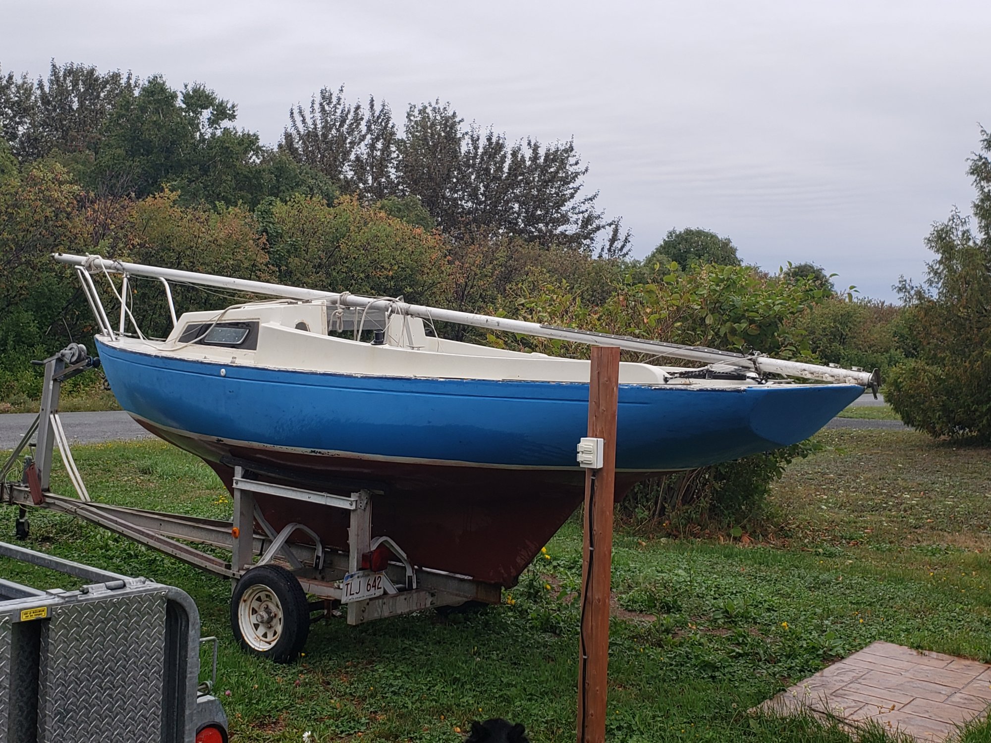

I just acquired a Victoria 18 which is missing the rudder completely, is there a design or pattern somewhere showing the size and how it is attached? Also if someone had one for sale at a reasonable price let me know.

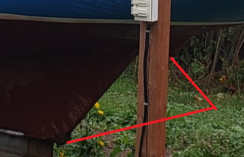

The attachment points will be here

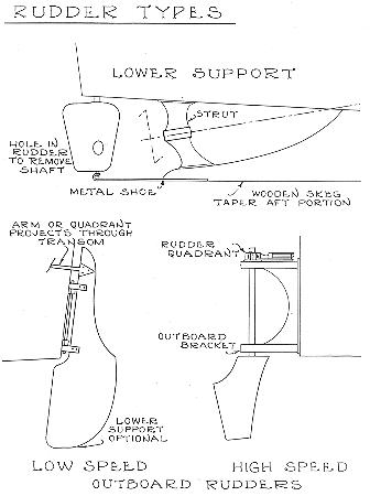

Post some close up pics of these areas. You should have gudgeons and pintles for the skeg and rudder respectively. Something like this...
You may need to build your own rudder. The search terms you will need are "skeg hung rudder" and then try "design" or "specs". I'd do a google image search if it were me and when I see something close, click on that link.
For example, I found this rather quickly

Welcome to SBO. The fastest resolution to your dilemma might be to find the previous owner of the trailer that the boat is parked on because it looks like someone may have started to take parts off of the boat to repair them. I notice that your starboard winch is also missing have you looked inside? I know this may seem as a spurious question but I ask only because I don't notice a ladder in the picture and your perfect placement in your picture of the power post. Besides a rudder you may also need a rudder shaft and tiller. Because of the apparent age of the design you are not likely to find parts that you can order off the Internet and will likely have to create your own.:)
