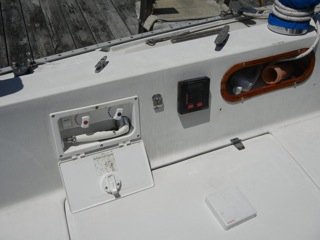

Yeah...however, I just re-read this thread and I have decided I like Joefusa's idea about mounting it in the coaming..then it can just live in there! I wonder if the cable is long enough to get from the chart table all the way over there?:confused:
Nov 5, 2014
73
lockley-newport 23 sarasota
it's plenty long. i mounted the mic on the coaming next to the autopilot. it's a little easier to grab when you want/need it. note the clip on the attached pic - it's between the autopilot and the shower. thought about going through the pedestal, but too much junk going through there already.
