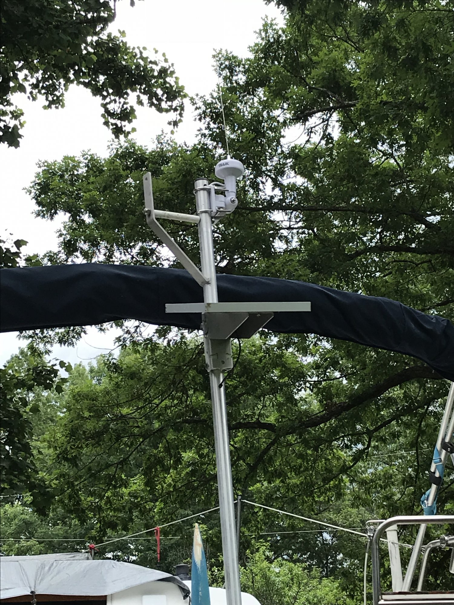

The GPX2200 is the radio I went with. The manual said I might need an external GPS antennae if I mount the radio down in the cabin, so I installed this dual combined antennae...HOWEVER! When I put the radio in its new location, it picked up the GPS satellites without any problem. So I am actually only using the VHF part of the dual antennae.

The GPX2200... picked up the GPS satellites without any problem. So I am actually only using the VHF part of the dual antennae.
:plus: My GX2200 is mounted below the deck (FRP + plywood core), and I've never had any problems with reception.

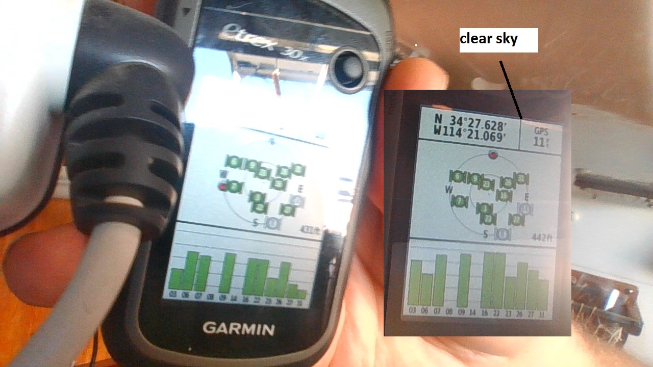

I did a quick check at the boat (1990 Mac 26S) with a Garmin hand held GPS unit and I do get less signal where I plan to put the VHF receiver but I dont think I will have any issue. The picture shows the clear sky GPS display on the right and the VHF radio location GPS readings on the left. This is under a spot where this is likely a plywood core but maybe 30 years and living in a really hot place during the summer chased out any moisture from the wood. Im not exactly sure how to interpret the display results but the GPS worked fine the whole time.
Im going to go ahead and order the GPX2200 unit and the RAM3.

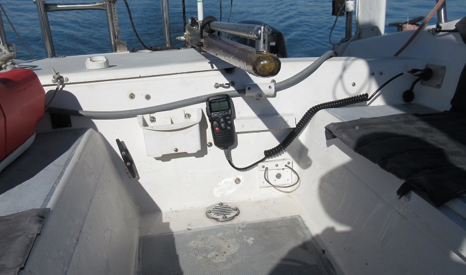

This boat is a 1990 Mac 26S with the Laz and outboard well / transom and I finally settled on the spot in the picture for mounting the RAM trying to minimize the risk of breaking the socket/ plug off while sailing or loading something in the Laz, stepping on the mic, accidentally snagging the cord or losing some seat space. Still a compromise..
The RAM seems to very nicely solve all the problems I had in the first post. The RAM speaker volume is plenty loud to be heard while Im running the outboard. I can almost completely control the radio from the RAM, even turning it on and off. The volume control of the RAM is independent of the radio volume control which is something I was hoping for. The AIS screen on the RAM is small.. but at least without ever actually using it, seems large enough to be useful.
