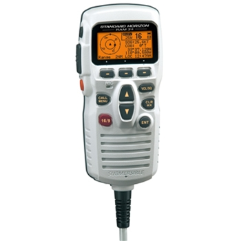

It is called a RAM (Remote Access Mic). Most base VHF radios have a place in the back to set up a RAM. You then run the cable to the cockpit and you can operate the base from the RAM.
Likes: walt
13,096
Here is an example for standard horizon
BTW: I have the black version of this same mic and like it very much.
Likes: walt

Standard Horizon CMP31 RAM3+ Mic
Standard Horizon CMP31 RAM3+ Microphone features a louder speaker and 75% longer mic cable than the previous model, now 24". Included in the box is a 23' routing cable, rubber cap, mounting bracket, microphone hanger, and ferrite core.
Im liking the RAM solution in post 3 using the speaker internal to the RAM. No extra batteries to keep charged and I think the cable wont be a big deal. It would live in a protected area inside the Lazarette. Has a three year "water proof warranty" according to the manual so would be fine for extended periods in the cockpit.

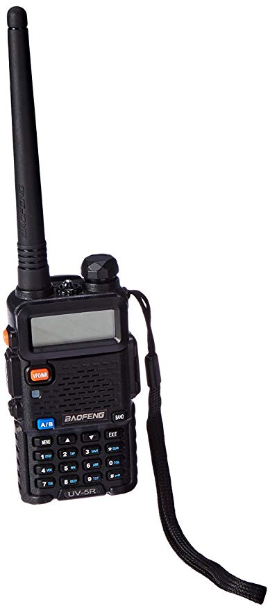

Inexpensive, usually around $30 or so. Can be programmed on Marine VHF, or, you can program for MURS
and GPRS use which require no license. If it breaks (which mine haven't, yet) just get another one. They also have accessories such as ear buds and speaker mics. It is called a Baofeng UV-5r.
Likes: walt

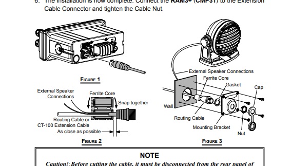

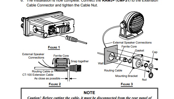

Thanks for the reply's! Understand about the solution using the hand held VHF receiver and rechargable batteries. Its what I have been using for the last few years. Its the cabled RAM3 Im interested in now (see the links in previous posts), not the wireless version.
But.. another question.
The wiring diagram at the bottom of the post is for the RAM3 version we have been mostly discussing.
Now Im wondering. If I first dont buy the external speaker, I still have a speaker in the main receiver unit plus a speaker in the RAM. Do they both put out sound at the same time? What if I add the remote speaker. Do I now have three source of audio? Seems to me that I would still want all speakers to be working.
Also, there is a Mic in the main unit plus a a Mic in the RAM. Do both still work?

With SH ram mike (Ram4) it controls all the functions as if at the station this includes the speaker volume. What I found is at the helm the ram mike is just as good as a external speaker.
