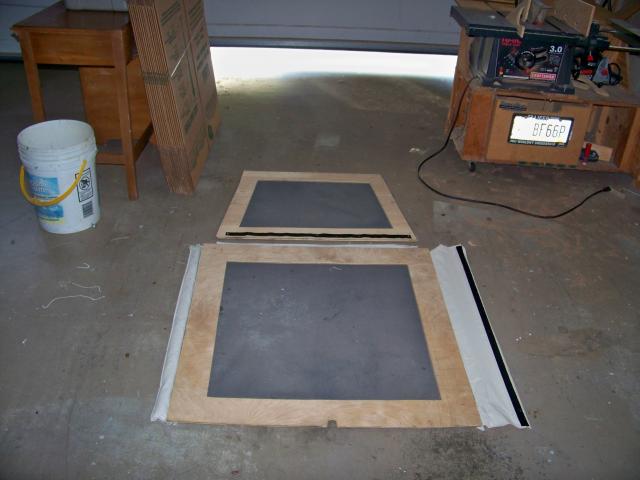

I made a framed screen to go over my gangway hatch. It is a piece of screen sandwiched between a plywood frame and the plywood is glued together with epoxy to hold the screen. one side is weighted with a "bean bag" of rocks, and the other has a Velcro strip attached to it and i attach it to the boat so that it forms a hinge. Then i raise it up to go in and out of the boat. . i made another on to fit into the hatch board slot, and it can attach to the framed screen with Velcro. I don't have a picture of it on the boat, but i have it here at the house with me, and i will post a pic of that. I brought it home and modified it this week. If i am on dock, i attach a window fan to the hatchway screen, if out on the water at hook, i have a battery fan that i can put there.
