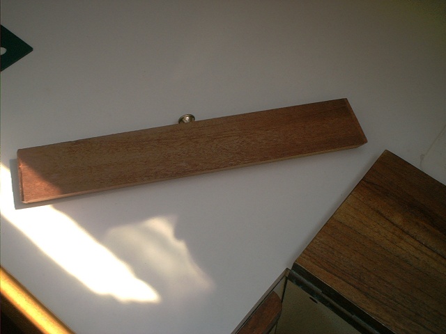

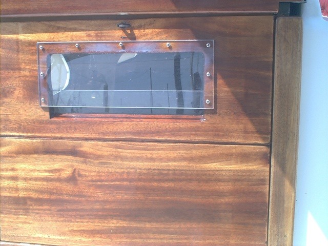

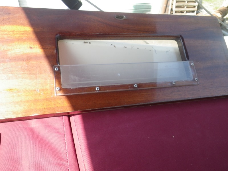

I have a Nicro Day/night vent in my fore hatch. I also have a vented drop board, so can get flow thourgh. Hatch vent looks like this
and I have a plug for cold or heavy rains
