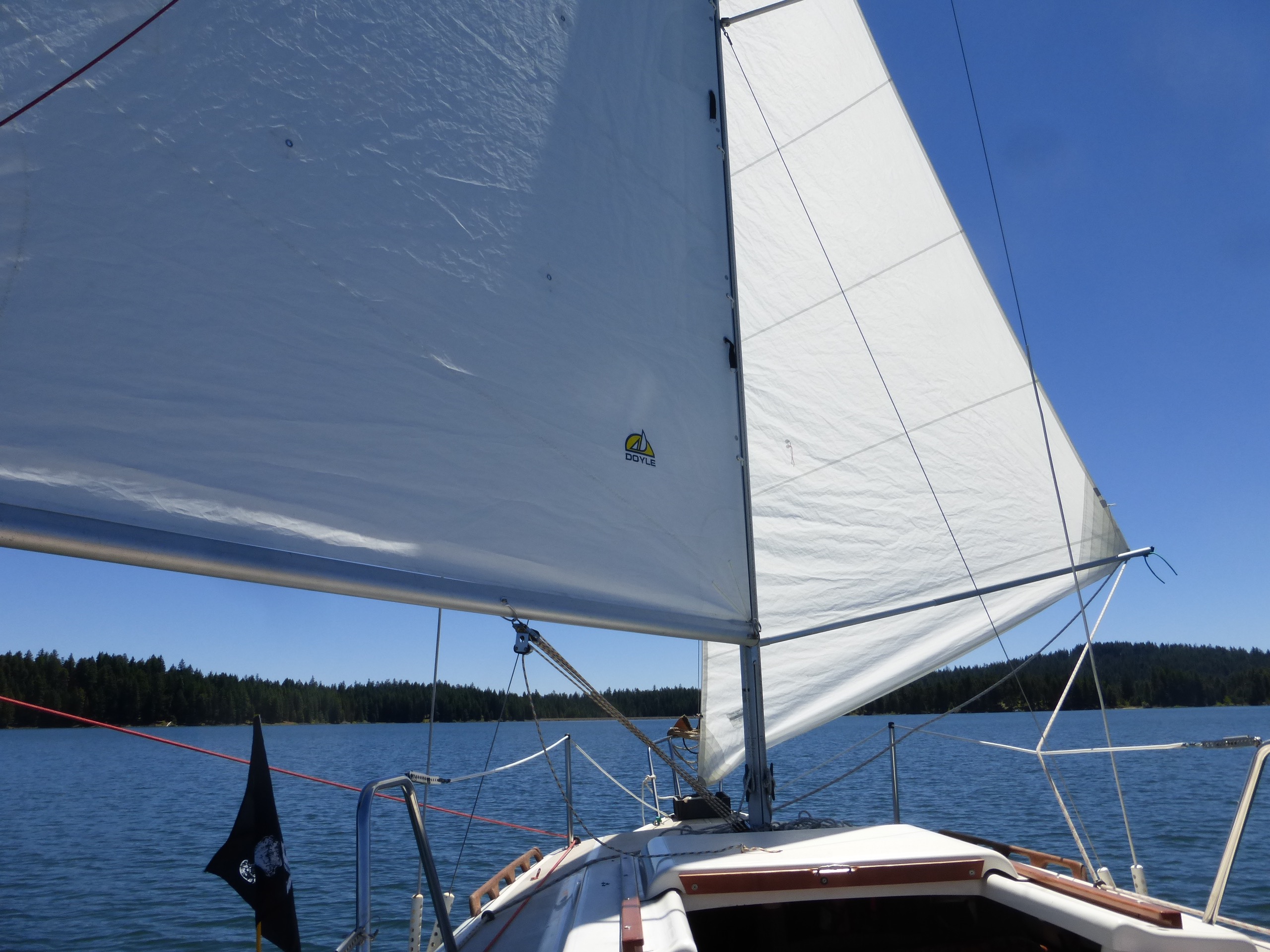

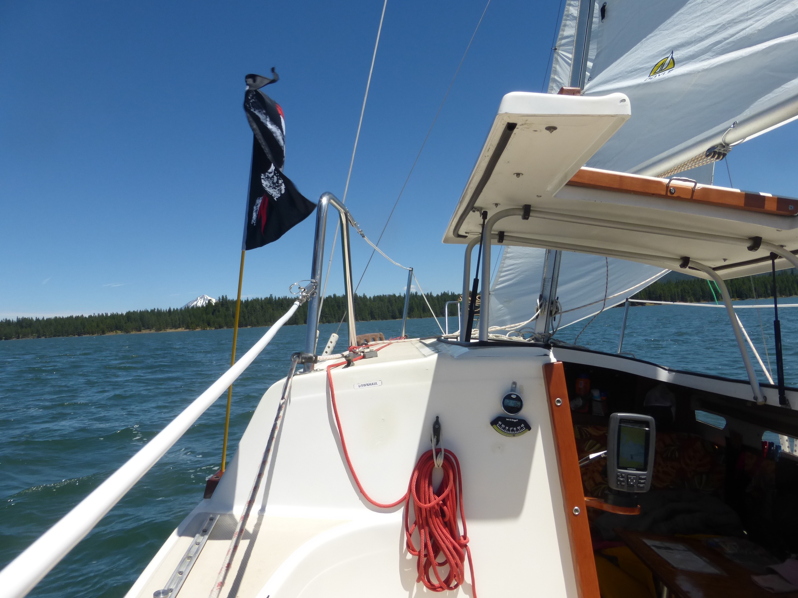

I like having a dedicated system. the coil of red line is our preventer, and it stays at the ready. a quick clip on one end clips into the end of the boom, wile and a cam cleat on the cabin top controls the set and release end. the forward portion of the line is in a small eye block near the base of the forward stanchion. Can be set or released in seconds.
I just have one on the port side, but I only use it when DDW and always set as shown anyway. easy enough to put one on the starboard side also if desired.
