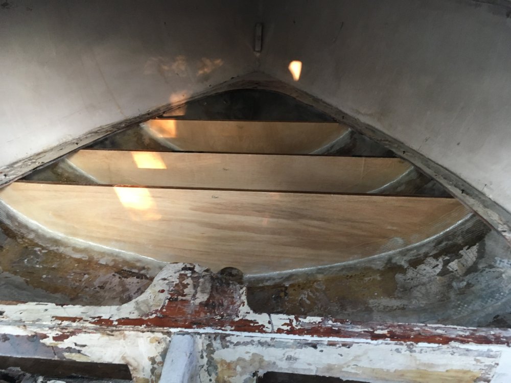

So I finally got three bulkheads filleted and tabbed in today as per the picture. I still have to replace the aft bulkhead of these (visible at the bottom of the picture). At that point I’ll cut out the v-berth edging and try and keep it whole as a deck template to replace it (I left it in play to screw into the tops of my bulkheads to hold them in place).
So when it comes to fitting the deck - should I include some vents? Is it worth thinking now about using some storage space in there? Any advice/help is appreciated.

I wouldn’t place any vents, but I would build the deck with some nice access panels over those partitions.

There appear to be good sized limber holes between the floors, so there is no need to vent between the floors.
Adding a small vent on the last floor to the cabin won't hurt, but I don't think it is necessary, if there are access panels built into the deck. As @Gunni said, the access panels are a good idea for both storage and to periodically inspect and/or clean that area.
