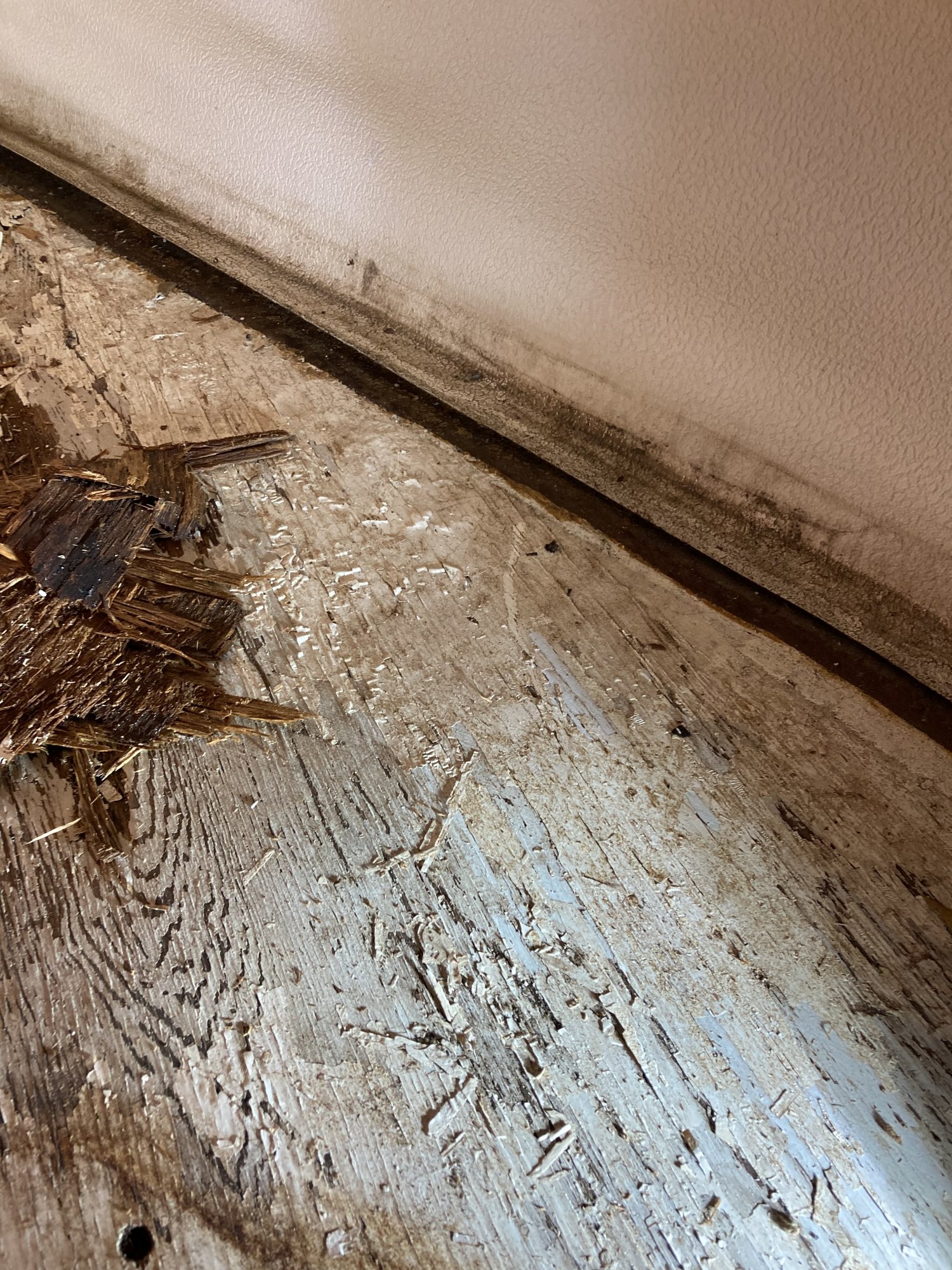

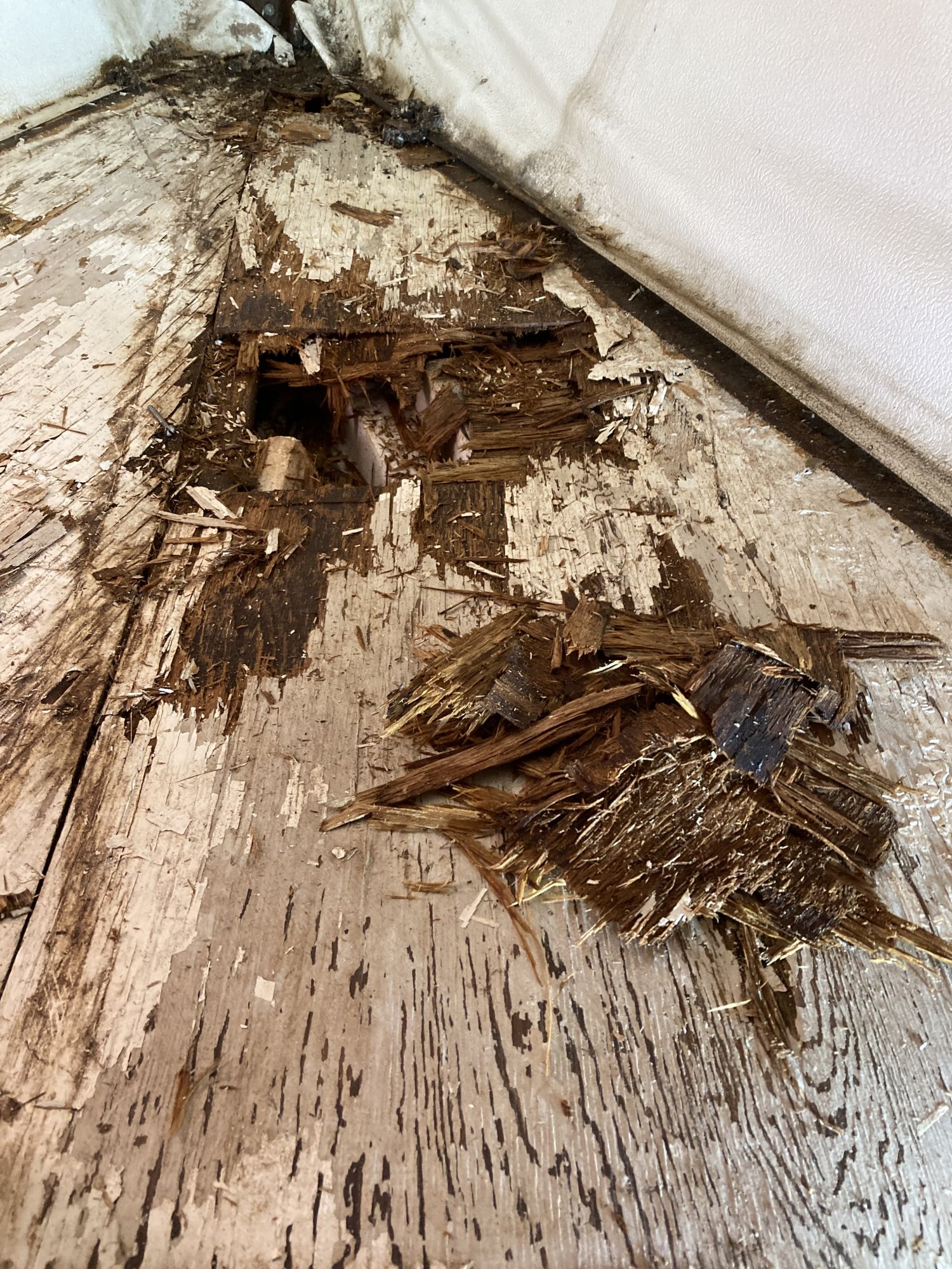

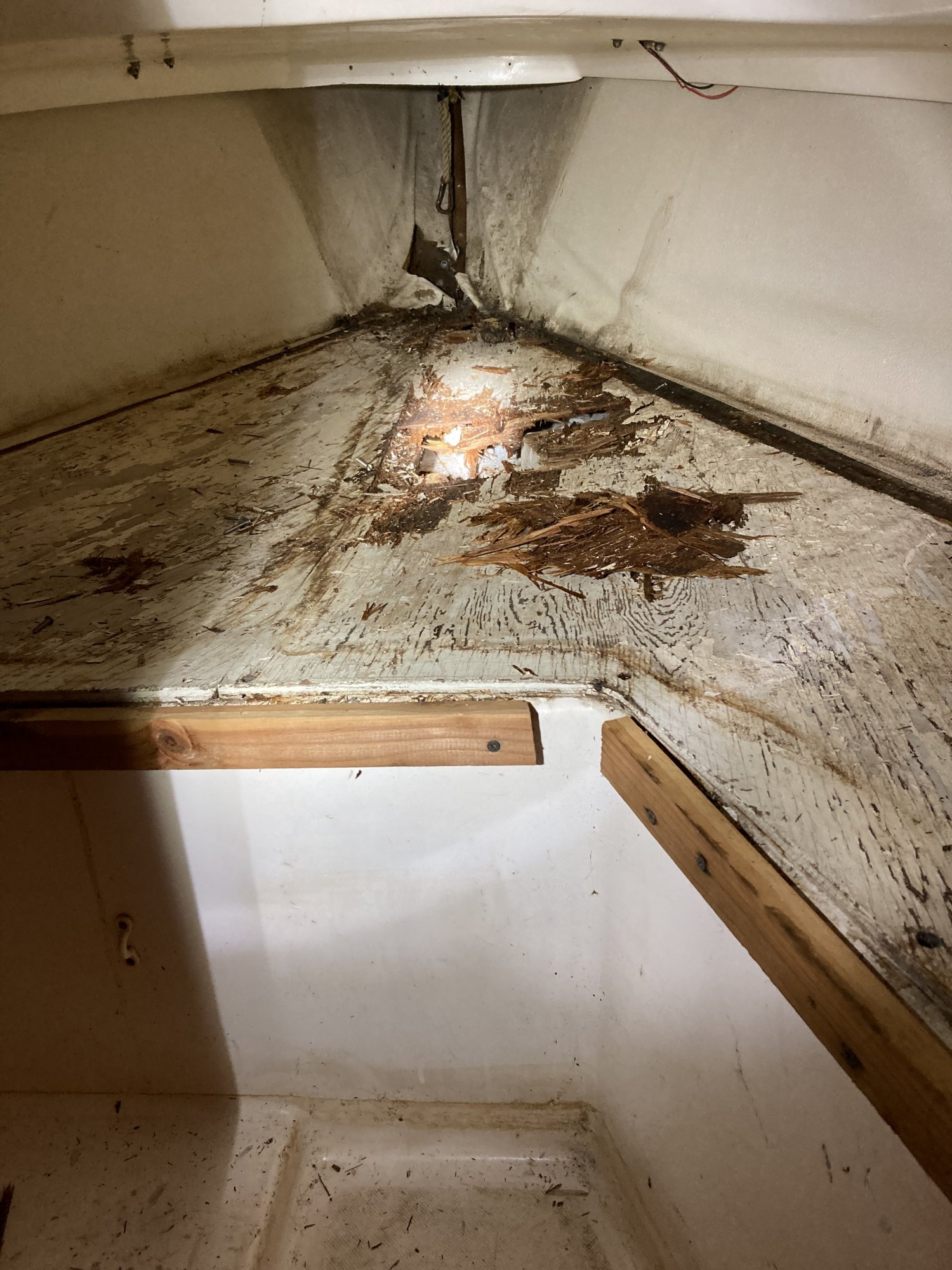

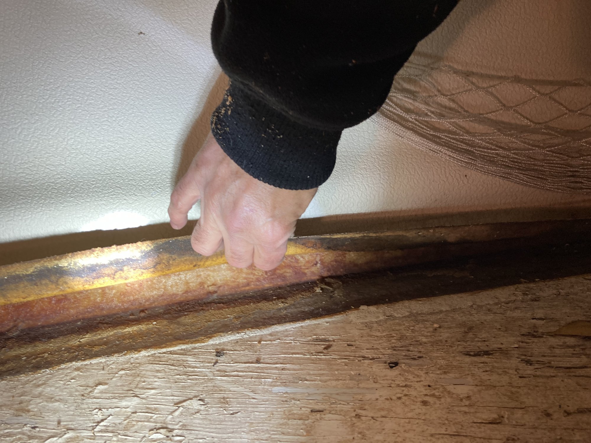

Hi. Just recently acquired a 1974 O’Day 20 that needs some interior work. The v berth plywood appears to original but is seriously degraded and needs to be replaced. There are screws down the middle of the plywood pieces. However, the plywood doesn’t appear to be screwed where it meets the hull. It looks it might be secured to the hull with epoxy.
I am worried that just “yarding” on these will damage the interior hull surface.
I would love to hear from folks who know more than I do on this.
Thanks,
Randy

What if you cut out the plywood about an inch or two off the hull. This would leave a strip of the plywood around the edge. You could use it as a ledger to install a plywood V- berth over the area. You can also attach the new berth plywood to the hull it would be very secure. The one downside would be the V-berth would be about 3/4inch less high.

Do not cut the plywood to fit against the hull. You will create a hard spot and damage the hull. The connection is flexible with the joint being connected with fiberglass tape, connecting the hull to the bunk with a 1/4 inch gap. John has a solution. Another would be to remove the existing fiberglass tape with a Dremel and carbide blade. Replace the bunk with new wood and attaching it with fiberglass tape as mentioned above. Have fun!

Hi. Let me make sure I am understanding this. If I remove the existing fiberglass, I should attach the new v-berth plywood to the hull by using fiberglass tape and epoxy. I should leave a 1/4 inch gap so that it doesn’t create a hard spot on the hull.

Hard spots occur when you force pieces against the hull i.e. a bulkhead.
If you fit the V-berth board to the hull and do not put any pressure against the hull it will be like putting on a compression sock just the correct size meaning no compression. If you have to force the V-Berth down into place then you will be putting pressure on the hull and you will form a hard spot.
Your V berth boars should sit down on a frame underneath and then you can tab the edges in place, this fibergass and epoxy.
