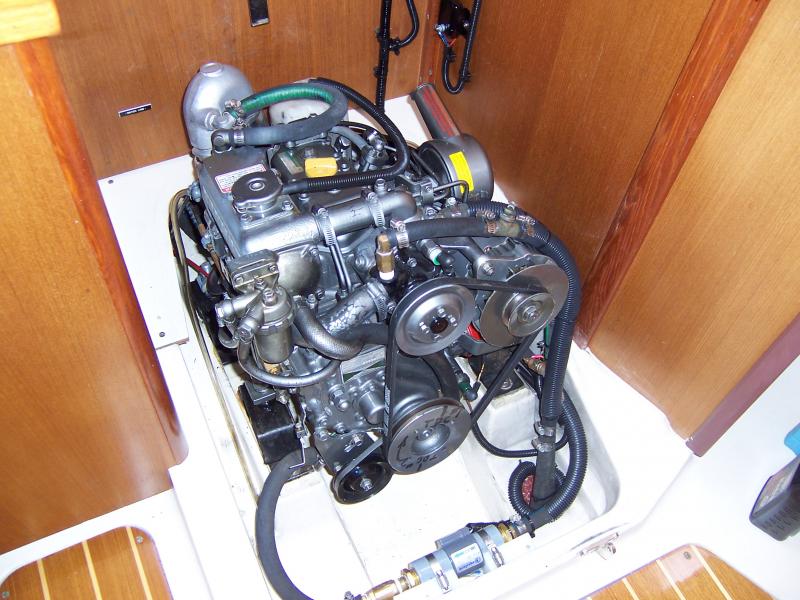

Ever since I changed out my belts to Gates, there's not a trace of belt dust around and I'm back to preparing meals on top of the engine block.
Jul 1, 1998
3,062
Ralph -
WoW! I'm impressed.
When I used to work in the woods we would often put, say, a can of beans, on the engine block or in the engine compartment for something warm for lunch. Never tried fried eggs, though.
Carried this over to boat cruising and my wife often do something like that, especially on our Alaska cruise. Needed to conserve stove fuel too, plus after a long leg and anchoring the dinner was ready to go.
Man, that sure looks clean.
23,523
Ralph, whether he knows this or not, has just volunteered to do my engine room. What time, Ralph? :)
