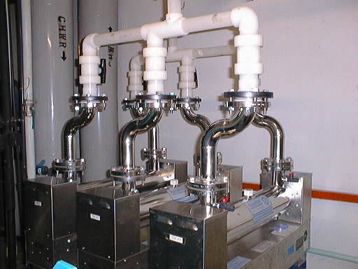

UV is used in clean water systems for semiconductor device processing and making media for disc drives. Two predominant wavelengths are used...254 nanometers to kill bacteria and 185 nanometers to oxidize organic compounds that would otherwise contaminate surfaces. They take lots of power to run and have to be in stainless housings with light traps (i.e., a couple of 90 degree elbows on each end of the light housing) as stray light leakage degrades any plastic piping typically used in clean water systems. The bulbs themselves are in quartz tubes isolated from the water. That was the only material that was transparent to UV. Glass tubes absorbed too much and the desired effect was canceled. Here is a picture of three UV sterilzers in our factory in Penang, Malaysia. You can see how the light is not allowed to reach the plastic. The water would continuously circulate from the storage tank through these and we would pull from the storage tank for our process needs.
I would think exposure of diesel to UV for any period of time would lead to crosslinking and the formation of extremely gummy residues that would really bugger the fuel system up. Stick with the chemical additives and have the tank cleaned every few years.
