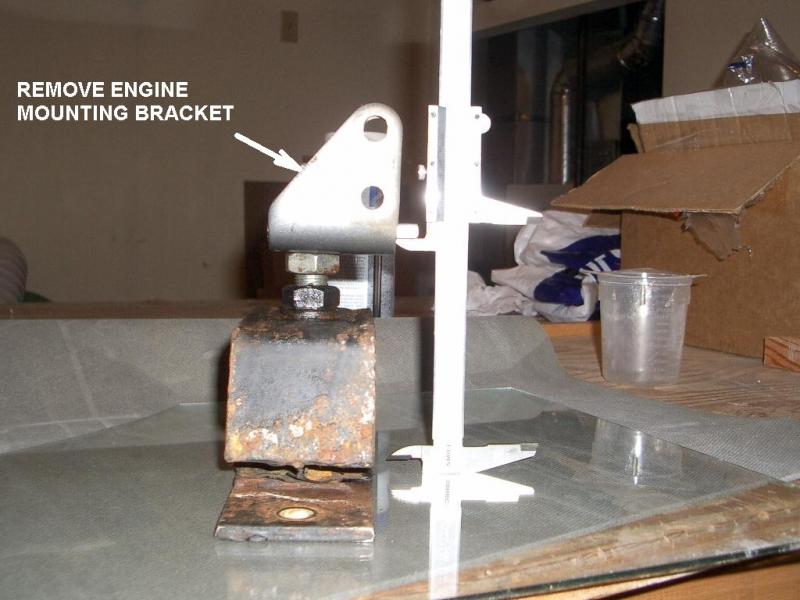

First, check the radial and angular alignment of the shaft flanges so you'll have a rough idea of where you want to get back to. Next, measure all existing motor mount vertical and horizontal locations (before anything else is touched) so the new ones can go back in the same location.
The attachments to the engine block are removed in order to remove the mount without lifting the engine. This is where some gentle lifting is required to remove the attachments. I used wooden wedges to lift the block just enough to take the shear load off the attachment bolts.

I did mine with the scissor jack and piece of wood. It worked fine. As said you need to disconnect the coupling and it is wise to measure the height of the mounts all around to get you back in a general area before you do a realignment. On my 29.5 I was able to get all four changed in a few hours, not that big of a deal.

What we finally did: Raised the engine using a full size basketball and an old school bicycle pump. we prepped the task by uncoupling the shaft, applying penetrating oil to each mount nut, used calipers to measure the elevation of the bottom of each engine bracket to the base of the threaded mount shaft, and backed out the nuts on the old mounts most of the way. To replace the aft mounts we removed their mount nuts, deflated the basketball, slid it under the engine far enough aft that it would mostly bear the load of those mounts, and slowly pumped up the ball. After the engine brackets were raised above the mount shafts, we removed the old mounts, cleaned the rails upon which the mounts sit, bolted each new mount to the rail but did not tighten, and gently deflated the basketball as the engine settled onto the new mounts. Repeated for forward mounts and then aligned the engine.
