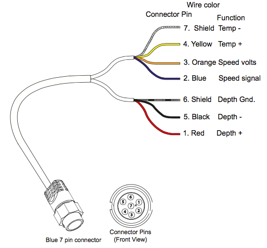

I have successfully connected the transducer from my old Standard Horizon DS10 to my new Simrad NSS8... old transducer was 200 Khz ... Simrad has 200Khz as one of the selectable parameters. Pictures are the label on the old transducer wire:
Sep 2, 2009
339
Hunter Vision-32 New Hamburg, NY
Thanks Ron, did you make a plug for the back of the chart plotter or do you have a breakout box of some sort?

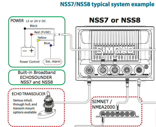

MLindberg ... the NSS8 came with a plug/lead .... I spliced coax shield to 5.Black and coax + to 1.Red.
for the echo sounder ... I spliced the transducer coax onto the plug for the NSS8 ...
