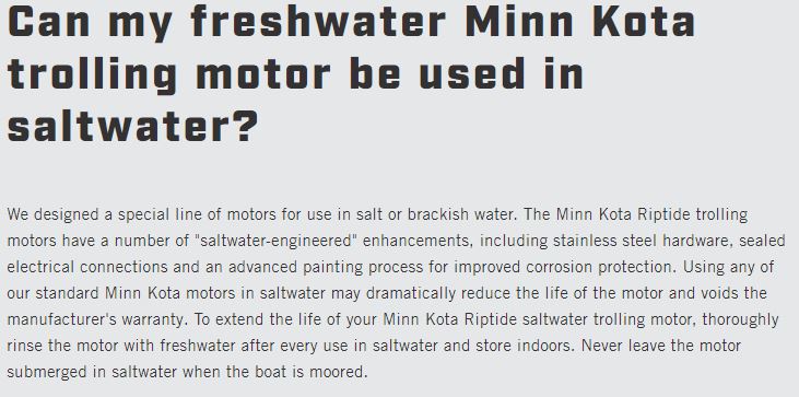

I looked up the difference, it seems like it is the paint for the most part and a zinc prop nut that you should be able to order. Guys are using regular trollers in brackish & salt water. I would beef up the paint, grease cover the prop nut & shaft once in a while & fresh water Rinse it after use. For a $50-100 used one I wouldn't worry, a new $800-1000+ I'd be a little more particular about.
