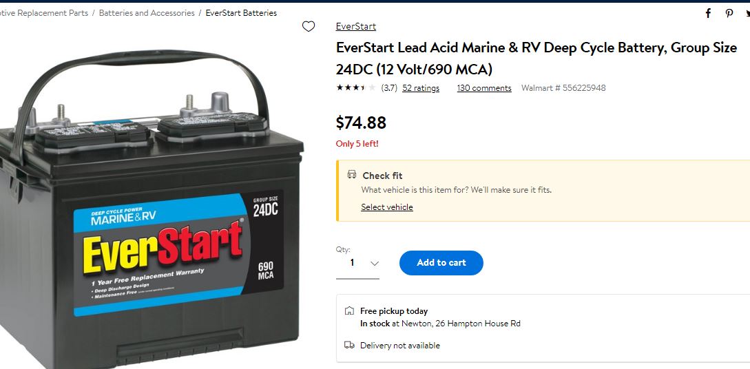

I think a trolling motor will work well if you aren't in big wind or strong currents. I use a cheap Walmart marine battery, I have two of them with my solar set up but I'm sure I could get by one battery for joyriding with the trolling motor. "All day" is with long times at anchor or just drifting while everybody is swimming or paddleboarding. One time while camping overnight anchored out I woke up and made breakfast, as I finished breakfast I noticed the wind really picked up, so much so that I decided to not raise my sails in it or dare try to troll-motor out of there as I knew that the electric motor wouldn't do it in that heavy wind. I waited it out two hours for a break in the wind and then trolled my way back to the dock.
