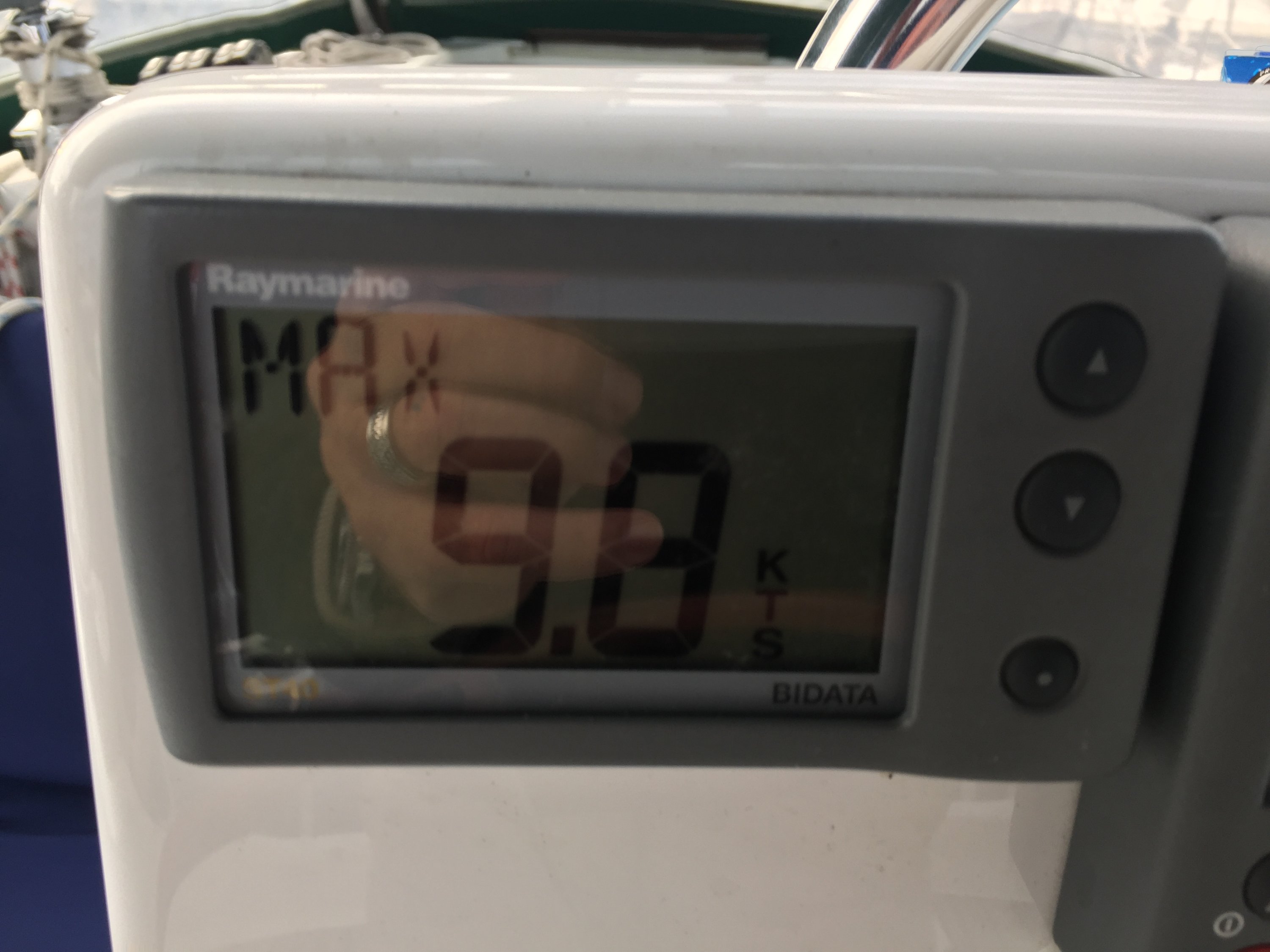

taken after a 4.5 hour sail this summer with an average from dock to dock of 6.5 knots. The speedo is perhaps a bit optimistic but certainly well within a half a knot. To be fair, a friend sent me an email saying they had just remarked that it wasn't fit to be out in that weather and then saw us glide by on our way into the marina after surfing into the entrance. I was dead set on a 40'er as I had owned a 375 Legend before but after owning this boat for a little over a year, I am perfectly happy with her for Lake Ontario.

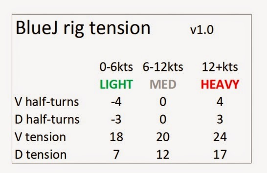

Your boat is fractional with swept shrouds. While its a static setting while sailing, rig tension will greatly effect your forestay sag. We adjust ours every time we go out based on expected conditions. We use a fixed number of 1/2 turns from a baseline to simplify.
So Clay, do you return settings to medium after you return to the dock or do you keep a log so you will know where to go from where you are set? The tuning guide for my boat with the mid setting at 10-12 knots of true wind but the norm is quite a bit less than that so if I pick a spot to return to it will likely be more like the light setting though this guide has 6 increments.
Interestingly the guide also has settings for forestay tension (-7 full turns thru +10) and I am not sure that is very easy to do in my case as the furler is set flush to the deck!
Nov 8, 2010
11,386
@danstanford ,
We used to dial to medium after sailing every time. Over time we developed a system where we leave the rigging and note where we left it. The only exception is if was set to max, then we turn it down unless we know for sure we will use that setting again within 24 hours. If we forget, we simply set the loos gauge on the rigging (V1) and the reading will tell us what setting we are in.
Normally a rig setting set with a forestay setting are for non-fuller boats, and you’ll have a different set that sets the forestay via shroud tension if you have a furler. Have a look around.
