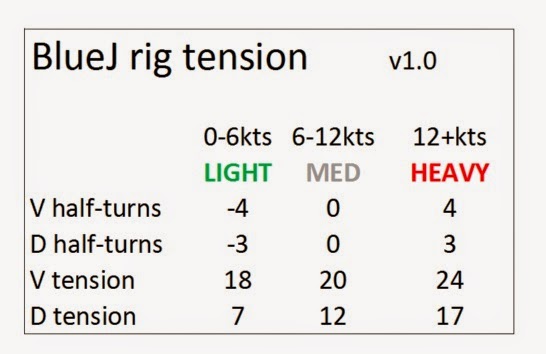

Your boat is fractional with swept shrouds. While its a static setting while sailing, rig tension will greatly effect your forestay sag. We adjust ours every time we go out based on expected conditions. We use a fixed number of 1/2 turns from a baseline to simplify.

If you look at the chart I posted above, the baseline value is centered on the vertical shrouds set at 20% of breaking strength, a common value for this. In breeze the tension goes up, which also increases forestay tension. In lighter air it goes down. The difference in forestay tension across the range is immense.... at the high setting its very tight; at the low setting the forestay can be swung in a huge arc.
Note that those values are with backstay off. Adding backstay to any of them will flatten the main yes, but also tighten the forestay and lower the shroud tension slightly.

I can see the value of a chart but I can't decipher what this chart means. I assume the bottom numbers are in rig tension (% of breaking strength). I don't follow what "V" & "D" are. I don't follow "half turns". I adjust backstay simply by feel right now. It would be good to have a system. Mine is masthead with split backstay. I simply pull line in on the blocks to pull the adjuster down the split shrouds and draw the shrouds together. I don't really have a baseline except to draw it down far enough to create 'moderate' tension when sailing in 'moderate' conditions. It would probably be a benefit to measure the loos gauge tension at various settings so I know where the baseline should be and how to adjust more precisely to conditions. I suppose I could then mark the shrouds for the correct positions of the adjuster.
I do notice that when sailing upwind in stronger conditions (20 knots of so) the leeward shrouds are slightly more slack than normal as I increase forestay tension with the adjuster. My spreaders are slightly swept back. Uppers and lowers are fixed to the deck at the same location (just one set of lowers).

Sorry we switched gears here. The OP was asking about forestay tension on a boat with a non-adjustable backstay. So.... this data is about adjusting RIG tension.
V=vertical shrouds, D=Diagonal shrouds. 1/2 turns are on the turnbuckles, it allows us to adjust from one relitive position to another without having to break out the gauge.
As we discussed earlier above, adding backstay tension (to a true fractional boat) will ADD to the amount of forestay tension created by the rig rig tension, with a slight decrease in rig tension.

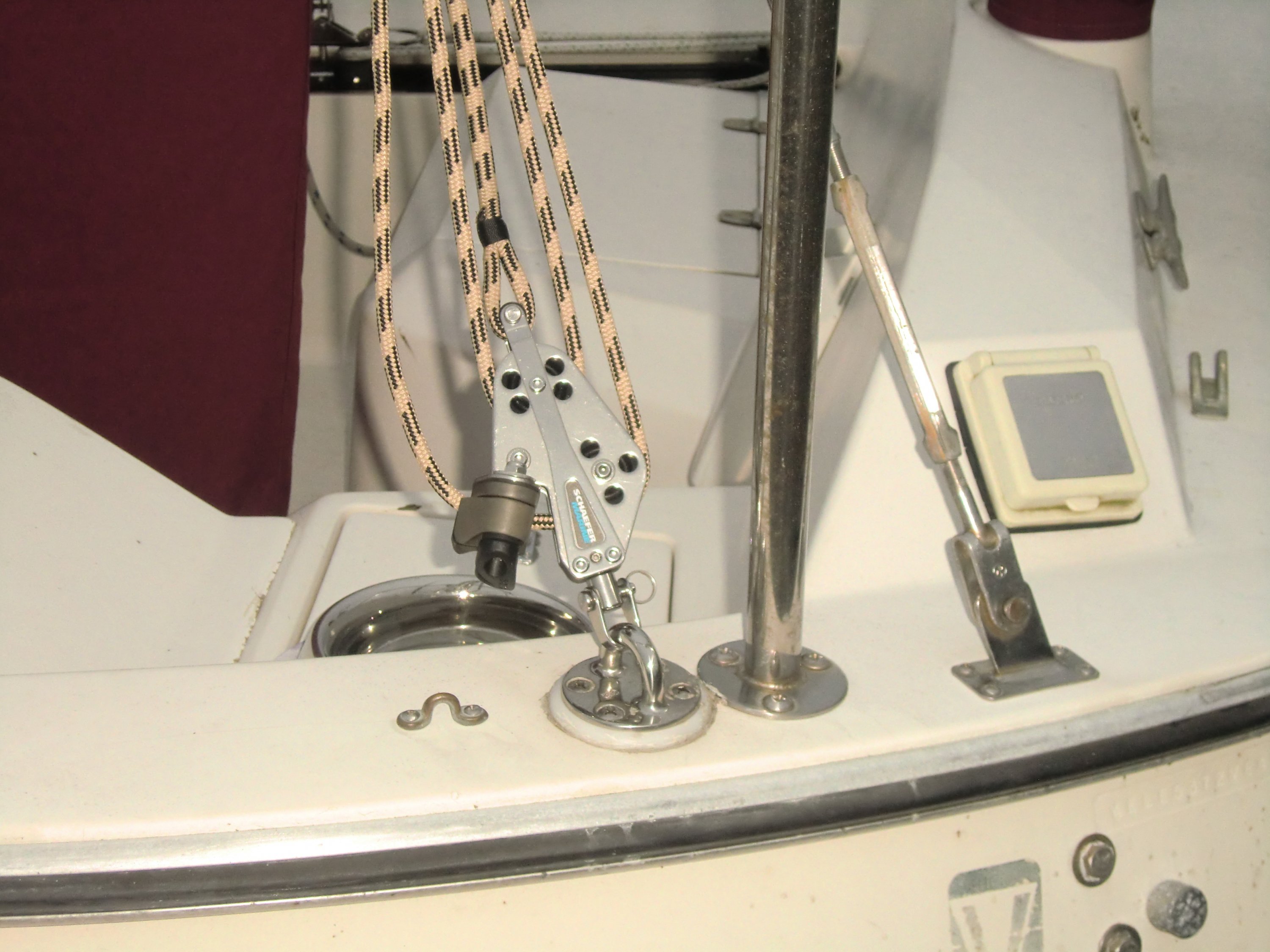

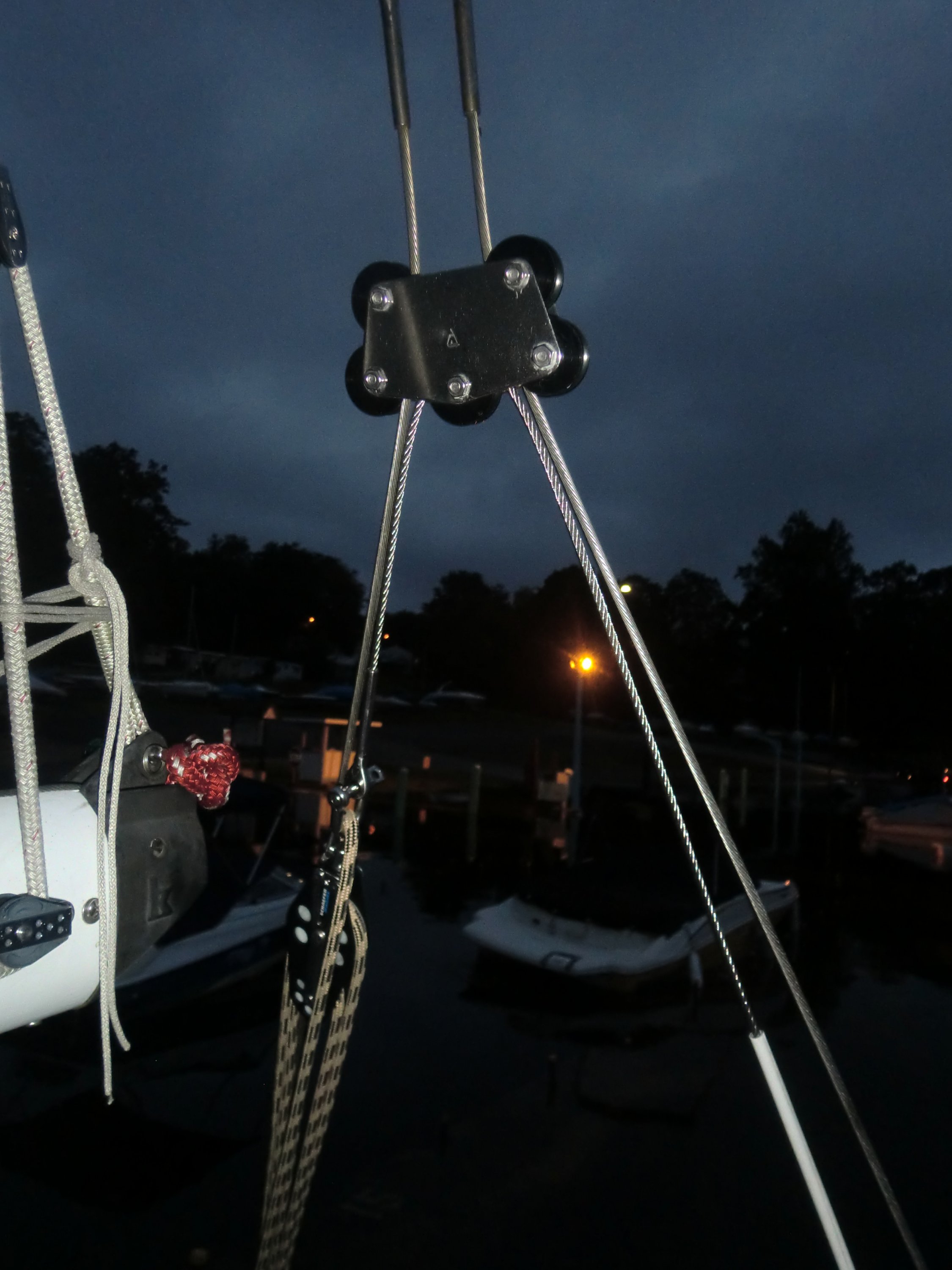

Sailboat specs Beneteau 323 indicate that you have a masthead rig. Is that correct? No to bend, yes to add adjustment for forestay tension.
Here is how I did mine ... and how it looks in action. I used a backing plate below the deck.
The new configuration pinches the bimini when in operation. I finally just cut the fabric to show where the new opening needs to be and am having a new bimini made.
