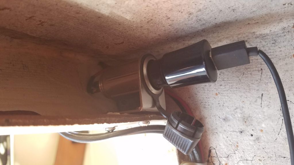

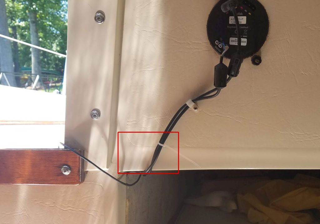

There is a good place inside where the finished fiberglass ends just past the bulkhead. If you can find a socket that attaches from the bottom you'll only need to drill 2 screw holes in an out of the way place. It is kind of hidden in this location but it is convenient both to the power panel where it can be run to a switch, and also it is a short run to the cockpit to power a device. It is nice to have it switched since many USB chargers draw current when not connected.
