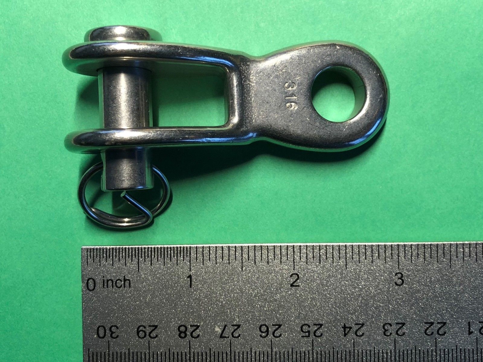

Even with these extra links I can adjust up to more than 800 lbs found some stainless climbing links to replace these cheap ones. I could not get the mast rake right with out them.

Since I am not an H26 owner I cant say who is right or wrong, but the toggles I posted should be much better that what you are using now. Good luck.
