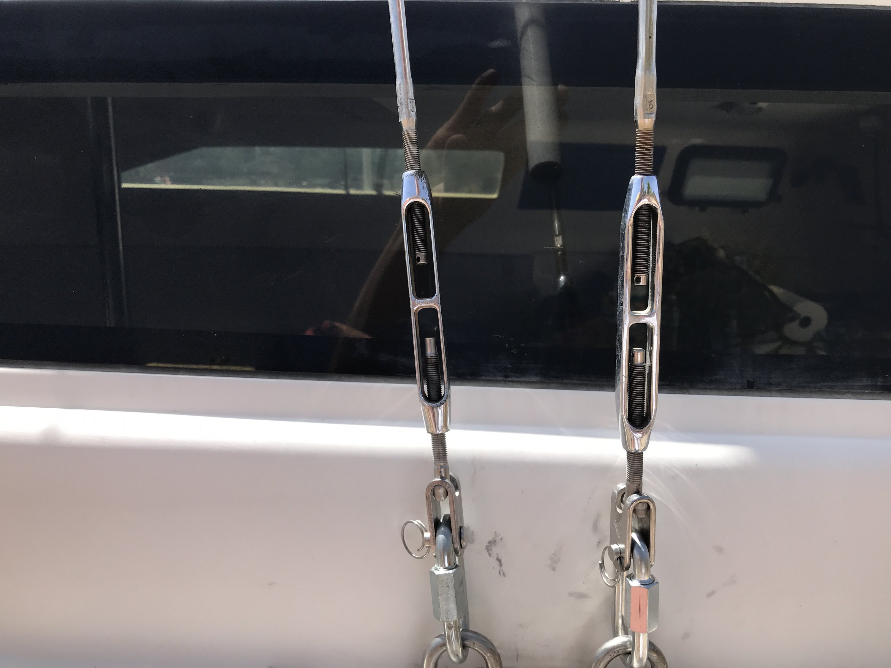

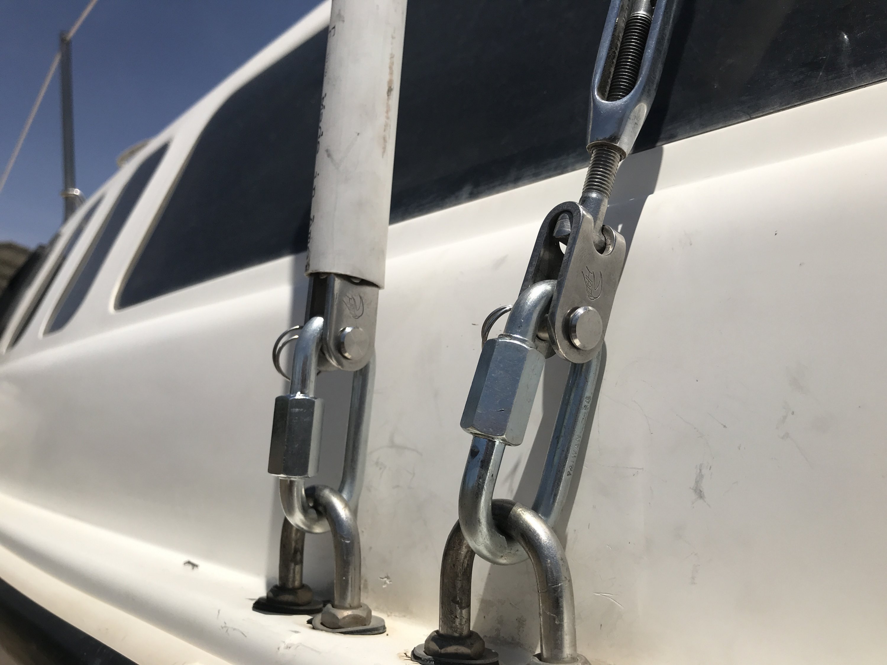

I finally came to the conclusion that my upper and lower shrouds are to shortused some trailer chain links to confirm. I need something that I can extend these 2 inches as I don’t want to leave these safety chain shackles on they are probably strong enough but not stainless anyone have any ideas one day I will be able to answer other people’s questions I hope.

There are longer toggles and toggle extenders. I can’t really tell from the photo but it looks like your turnbuckle is at it’s maximum short position. If that’s the case, extend it to mid position or even a bit longer. That may be enough.
7,748
that's what it looks like to me too. Also, your rake looks non-existent. Maybe extend your forestay a bit too. Photographs like that are hard to gauge.

Sounds like you need to get out the rigging guide and start from square one. I looks like you have 2or 3 inches of adjustment available on your turnbuckles anyway. If they are 1/4" they'll have 4 to 4 1/2 inches of adjustment. Btw, mast rake isn't the only reason for weather helm. Trim the headsail or ease the main. Put on the outhaul, impart more twist (mainsheet).

I think 800 lbs of tension is to much am I wrong I have it set now at 580 upper 480 lower ? The extension I have on is 2 1/2 inches I could probably get by with 1 1/2 before i could barely get a cotter pin through to lock the turn buckle and a quarter inch gap at the front of mast foot.

So, if you extend the turnbuckles all the way, they're still too short? As long as the holes are showing and you can get a pin or cotter ring in there that would be okay. Looks like you have a lot of adjustment there.

At the very least I'd suggest replacing those cheesy carabiners with marine grade toggles.
Something like this will give you enough length. BTW, is your rigging rubbing against your cabin sides. Keep an eye on that... it's not right.

...I need to find something other than those cheap quick links I have on there.
I don't know where I saw it, but there are extended-length turnbuckles. Or maybe the screw part is just longer?
No it’s not
