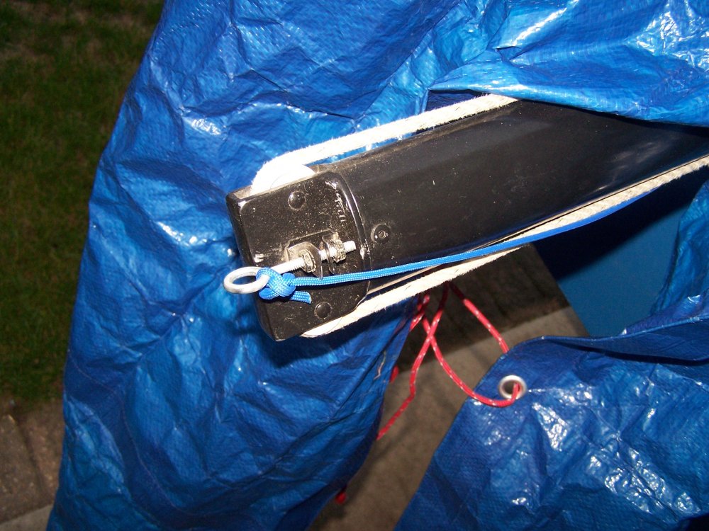

What is your favorite modification or upgrade you have made to your old Daysailer? I recently rigged a boom vang using a Laser block w/ key from APS. I Velcroed some flat pool noodles to the seats to help avoid sore backs and butts. I swapped the lower mainsheet block for one that has an adjustable cam cleat and a locking swivel. Next time on the water we'll see what really makes a difference to handling & enjoyability!

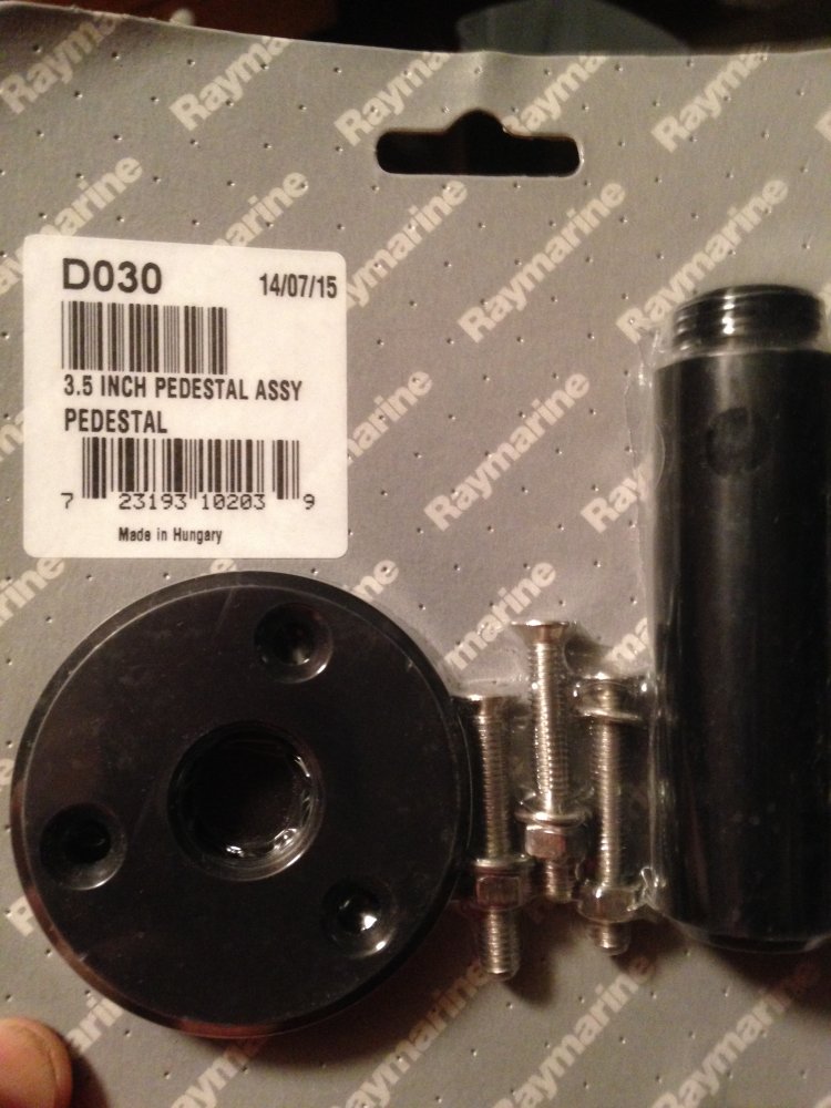

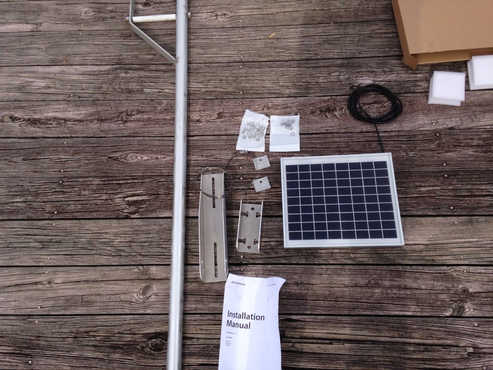

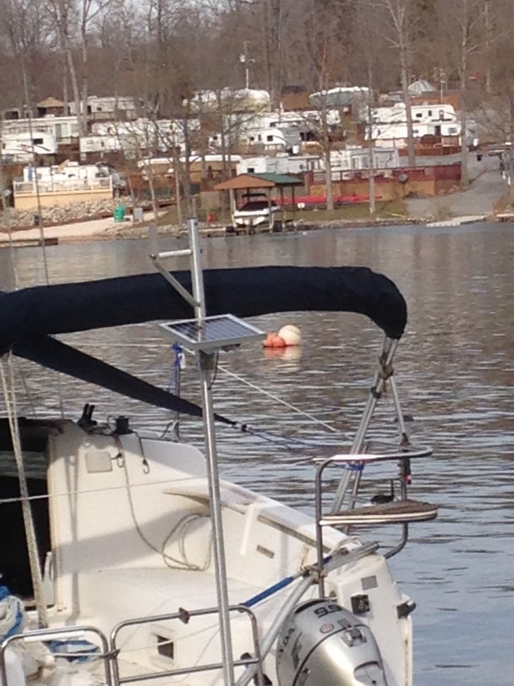

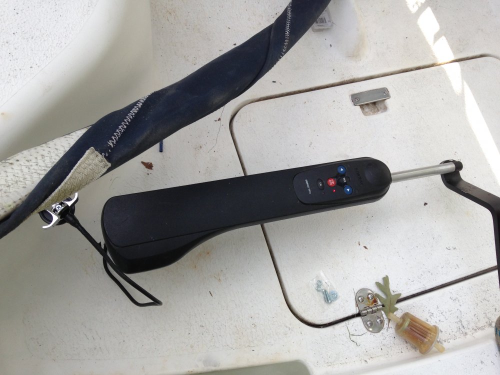

I have made a lot of upgrades over the years but the two that are the most useful have been the instalation of a solar panel & charge regulator and the installation of an auto-tiller.

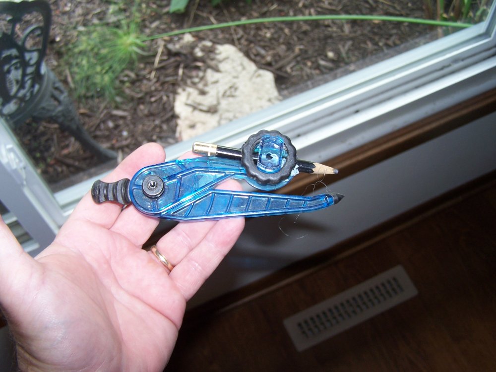

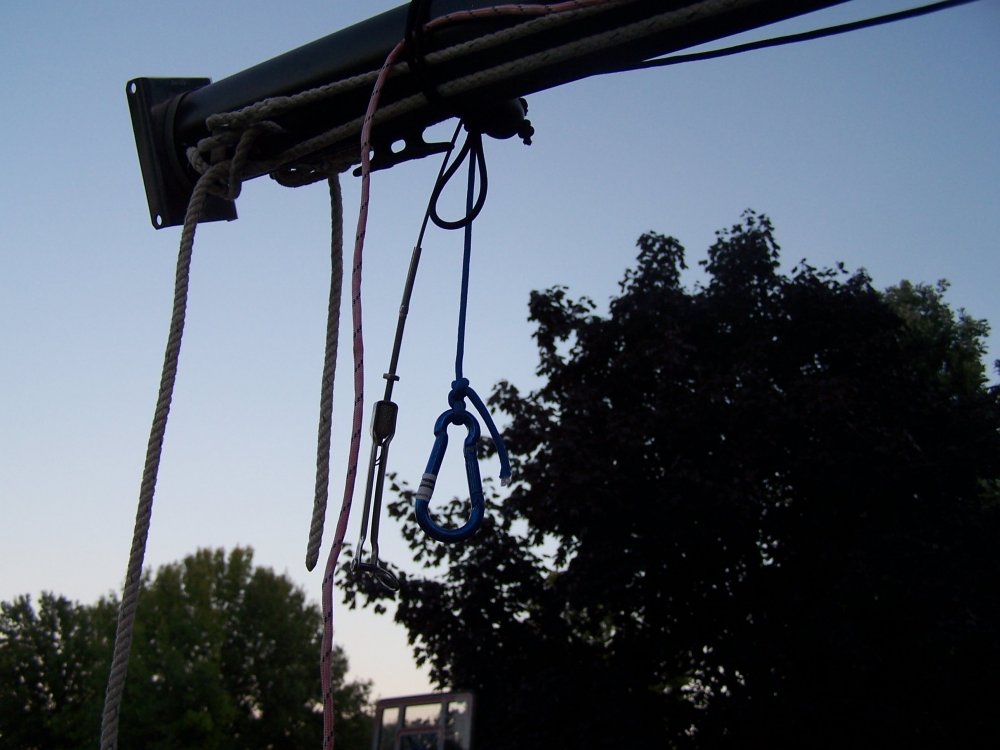

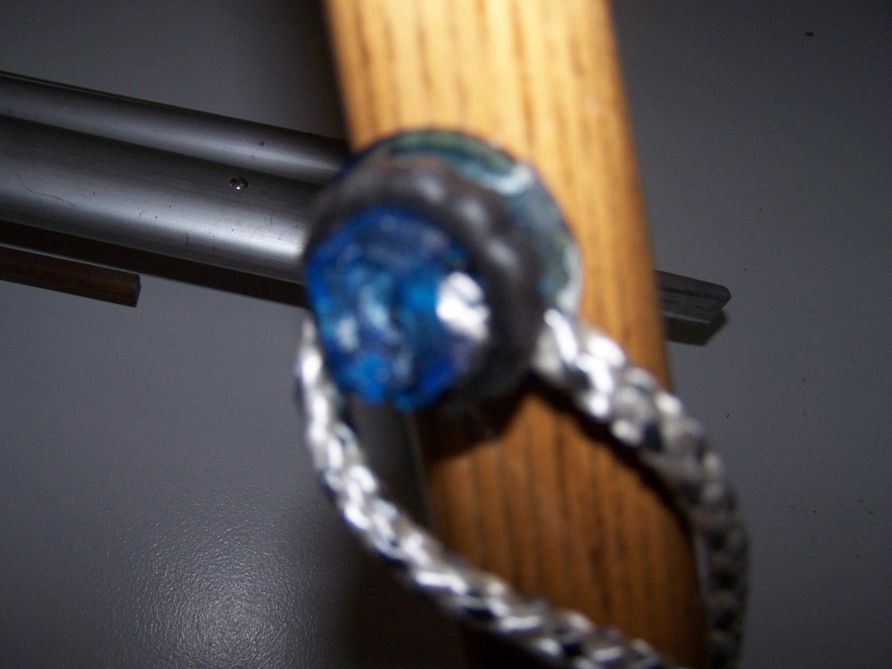

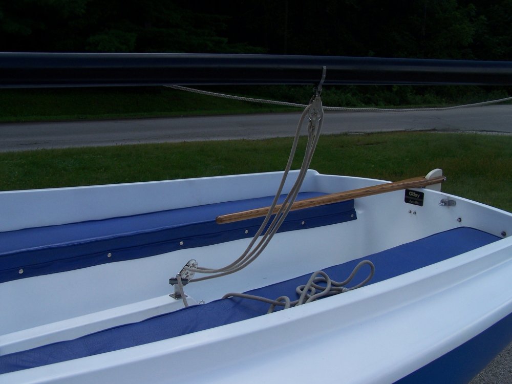

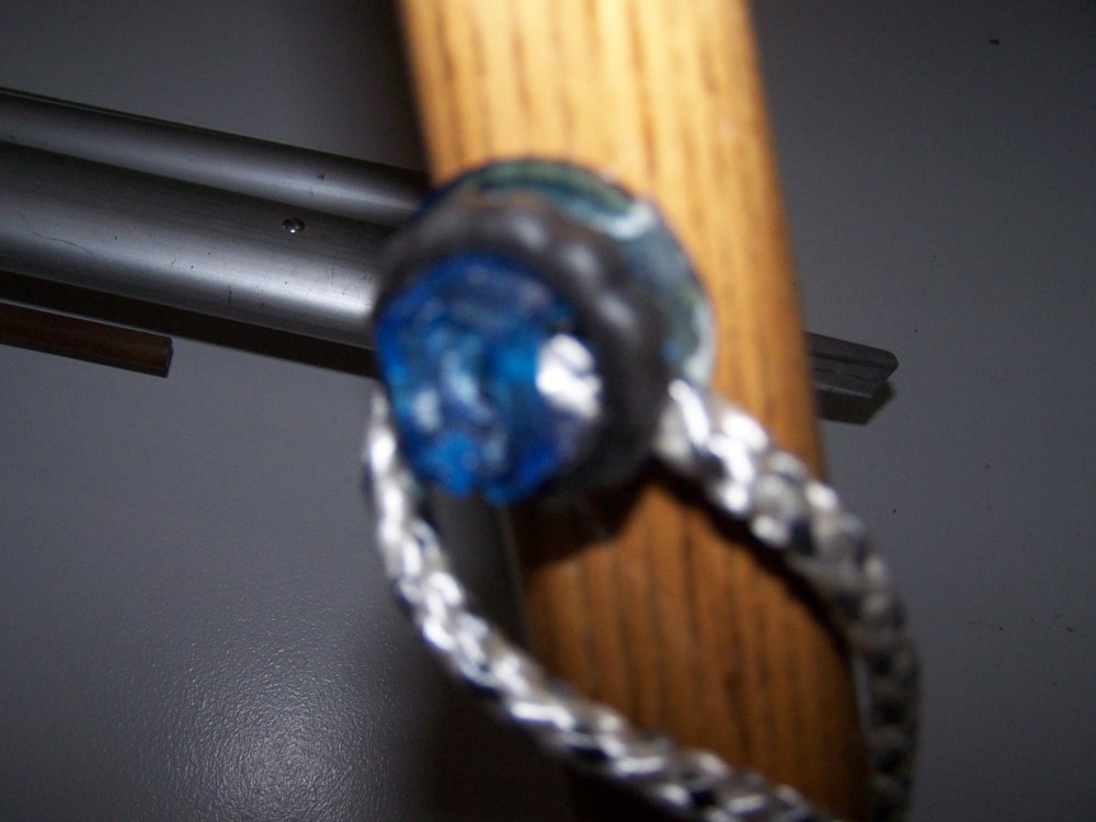

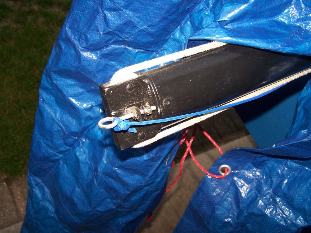

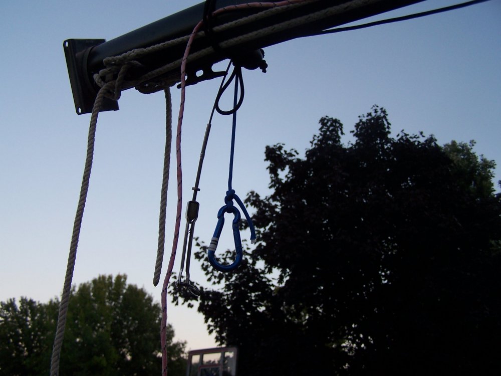

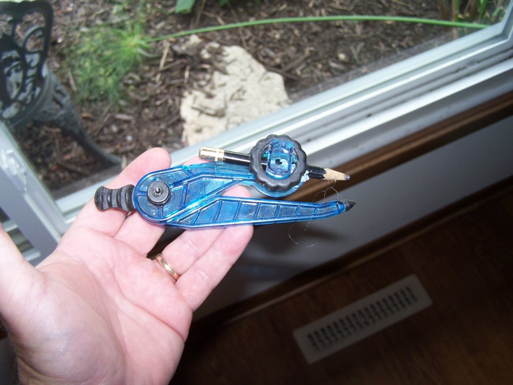

My 2 upgrades certainly didn't upset the bank , The first a tiller tamer made from a school compass and use my spinnaker pulleys for the rope ends. ,the 2 a much needed topping lift . Repurposed a bracket from navigation equipment the P.O had installed with an eye bolt tied not and used carabiner on other end. Holds boom nicely Been in 20 mph winds no problem.

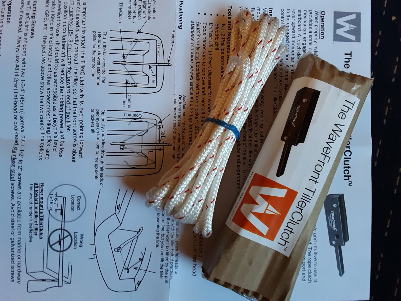

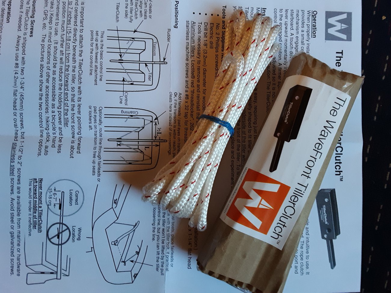

Clever! I read somewhere that you should release the topping lift when sailing. I have sailed with the topping lift attached and didn't notice any difference though. Here is a photo of my TillerClutch that arrived today.
An adjustable topping lift will allow you to shape (with sails that actually CAN be shaped) the amount of twist in the main sail. In light wind, you need generally more twist, as revealed by leech telltales, to capture max drive at the top of the sail. The problem is that the weight of the boom often pull too much leach tension and thus removes twist. Conversely, in higher winds, you need less twist to keep the whole sail optimally trimmed, so if the topping lift keeps the boom too high, the top of the sail will be undertrimmed and possibly flapping. In higher yet winds, you can depower to an extent by allowing the top of the main to twist off more, thus providing less drive high up the mast, and less heeling.
