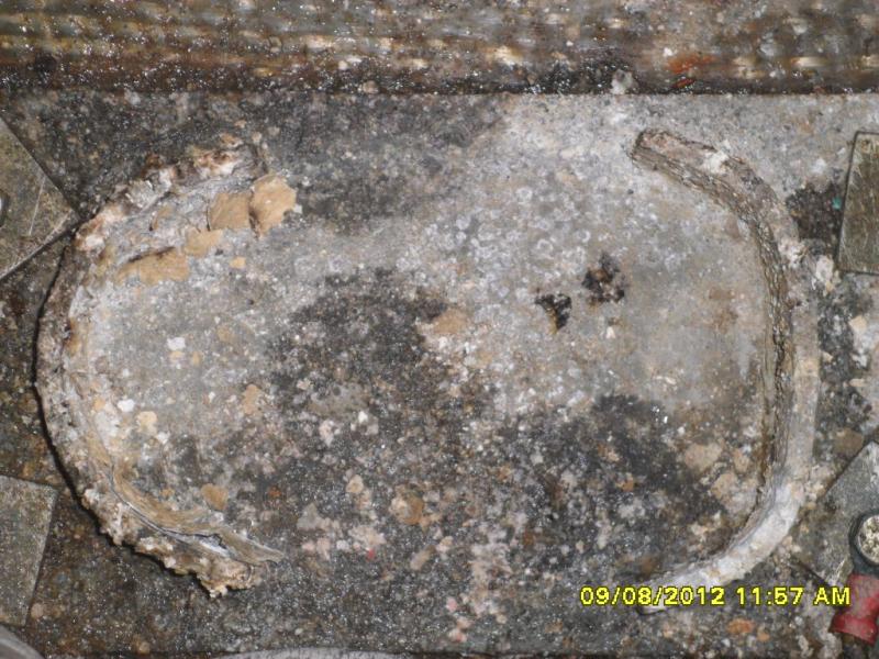

The mast foot on the 303 sits in the bottom of the bilge were it corrodes because of the bilge water. On our 1985 303 we had 2" of the mast cut from the foot and had an epoxy block made with through holes for the mast shoe. The mast is out of the bilge water most of the time. If you pull the mast check the foot for corrosion.

Yes your right right GarEi! That was a bad design. Luckily, the owner had them design it differently. and has not been a problem for me. Here is some pics for you all. Thanks StarGazer II Capt. Rob
NOTE!!!!!!! The 2 bad pics where from another 303 out of NY we looked at called "Rascal 111" After a review with the Surveyor we ran away from it.. literally!

Yes... that was a bad design. Luckily my spar was not effected... however I had a new mast step fabricated out of aluminum as it had deteriorated badly.
