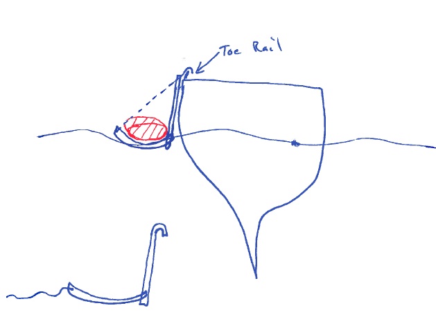

I too have been interested in a convenient way to board a sailboat from a Kayak. Appreciate you mentioning the outriggers, any pictures from others, especially when next to a boat showing it in action?
One approach I was exploring is a rig that temporarily secures to the toe rail, and when pulled tight, hopefully stabilizes the kayak......haven't progressed beyond the note pad stage, will try when the project boat is in the water.

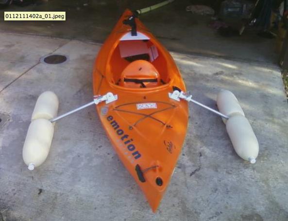

Attached is an example of a single kayak using adjustable flag holders bolted to the skin of the kayak, and attached to pVC tubing arms. This person used lobster buoys, but another person used plastic soda bottles spray painted the color of his boat.
In addition another set of arms could be used to attached directly to the sail boat. In a tandem yak there would be enough space for a small homemade step stool between the seats. With a stabilizing rope attached to the rail on the other side of the cockpit, climbing in would be quite easy. The boat and the yak would be moving at about the same rate, not at different rates. Also in a tandem, the outrigger stabilizers would be off the stern of the boat since the tandem is 14 feel long. This is a single and would require a bit of modification.

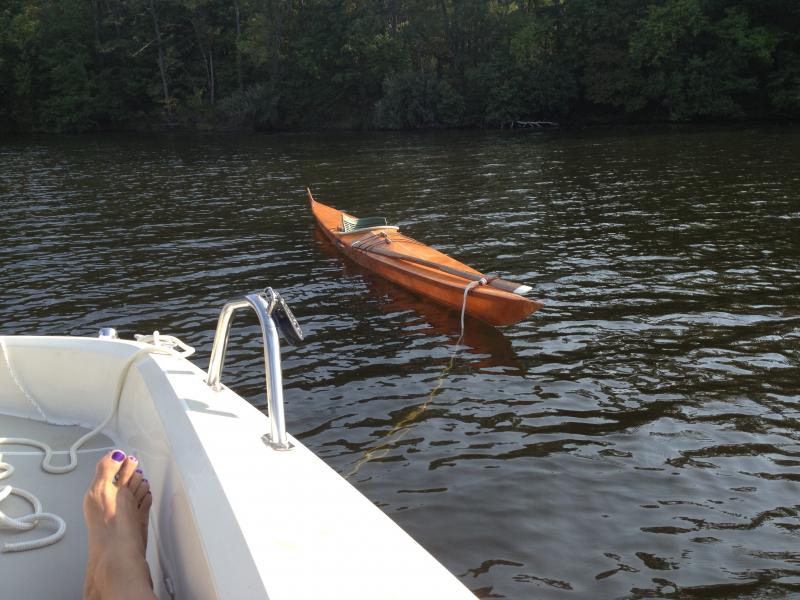

Second to what Thinwater says, I tow my skinny kayak behind the boat, and get in and out of it at anchor. I admit that my 192 is lower freeboard than a WWP19, and I also do not have mobility issues. I paddle this skinny, low volume kayak, and practice stuff like bracing and rolling in rough water (including surfing this boat over sandbars in the inlet), and climb in and out of it off docks. So, let's just say I'm experienced… But, hey, learning proper techniques will allow you to use a kayak with a sailboat. Take some good kayak classes, and discuss your goals with the instructor. When I was asked by students, I would take a few minutes to go over dock boarding/debarking, as opposed to only teaching beach launches.

Will I need to paint my toenails purple to get it right, do you think?
Thanks for the vote of confidence. I'm sure my eife appreciates it.
