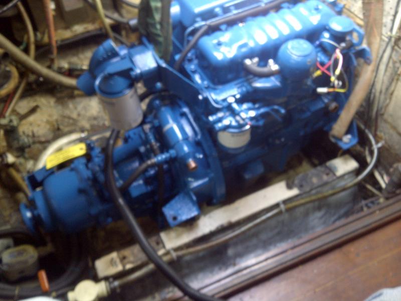

ok so i went into marina here in barra de navidad in june, towed in, ignominiously, by panga due to runaway diesel experience... fun.... we even grounded softly on way into marina and lost steering..lol cable jumped off quadrant -- is fixed .
we have been fixing everything except engine over the past 5 months, and now we get around to the problem we dont wanna deal with. i even has some , err, one set ratlines on main mast shrouding. found wood for belaying pin rails fro december for my christmas present to boat.
we looked all over block for numbers. finding none of the indented variety, we decided ours is a bastid perkins sin numeros and therefore deserves different colors.
ok and parts will look even different after our artist is dine with certain lil bits she is painting with pretties and intricate lil stufffies which will not be known even by me until it is done.
so.
so far engine went back together nicely...had to fab some bushings for fuel line...went to injector place for diesel bits//funny how they were closed, so we went to a transmission shop and had some made... price was excellent..nada/ gratis.. wow. i love mexico. try that in usa!!!
so my boat is one with spare bushings for injetionsystem. lol
then we go to start the beastie.
KALUNK
ok. corrosion on terminals. fixed.now i has better battery power.
next day we do some more lil stuffies to engine beast....
KALUNK
now i am asked if i have a pry bar. (some of you know what is next..lol)
no pry bar in marina. ok. so all boats here are megas and some very few cruisers who left for summer...
OK GUYS, WHY DONT YE CARRY A PRY BAR IN YOUR CRUISING BOATS!!???
SOO..... spozedly today we lube beejeeziz out of the interior of engine and wait.
prybar is being built. is raining like crazy today as we are under a pretend tropical storm wannabe(is too late in season for a real one) so work may have to wait to tomorrow yet again....(see how it coulda seized up , as we had to wait a lot this past season. we had letters A-S form over us in some fashion, as we are southwest coast of mexico, 20 miles north of manzanillo)
yeah . the engine seized up while we waited after runaway so we get to unklunk it and make it new inside. ok
is only money...
meanwhile, i could be stuck in a worse place.
but i WANT noise and smoke and drippyness and leakiness and smoke......and....NOISE.
i WANT noise!!!!!! i WANT stinky......ggrrr
is gorgeous here. is actually a good place to stash a boat for summer, as long as rates are low in summer...for me the rate differential summer at 4400 pesos to winter at 14000 pesos.... peso is being charged here in marina at 12.15 to one usdollar.
rate is 13.0 at present.
good thing it is gorgeous here.
and parts are findable.

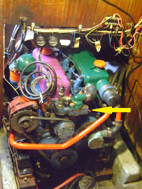

From my experience with 4-107 and 4-108, the number is stamped into the block below where your reservoir is mounted. Of course in a place that's hard to get to but a mirror and flashlight will help. Maybe just stick a digital camera down the and snap away.
It's around the pointy end of the yellow arrow. If you need a owners manual, shop manual or parts book you can find them here (4-108 and 107 are same books): http://www.endeavourowners.com/dscsn/info/manuals.html

it is going up against the canuckistanian monster leprechaun engne repair guy. it will work. eventually.
much prefer noise etc to corrosion in 2 cylinders and dirty injectors, which is what we have so far discovered. like we didnt kinda expect something... but where is that corrosion being made and why.. what broke inside engine to make corrosion in those 2 cylinders.
we will find out.
at last there are many 4-108 engines here, so parts exist. is up to us to learn where and how they are found..lol...
the saga continues......
yes it is gorgeous here.....summer rates are good, winter rates jump by 10,000 pesos....i need to leave marina asap.
there are no indented numerals whatsoever on this engine. we have had it apart enough to have learned that. is why i call it a bastid. the drop date was 1982. august sometime, i forget the exact date. those are forged in numerals which perkins disregards. so,, as there are no perkins numerals, is pure bastid..lol hence coloring as such.
coloration of this engine is not yet done..there are parts being made intricate.... she or he will be proud or gay..lol i dont know gender of my perkins. artist ill come to my boat to finish the parts unable to be easily removed and i dont know which parts she will decide to paint. this will be a surprise even to me.
yes i have shop manual, and we looked exactly where it said to look with no luck.. my repair guy borrowed my hard copy, i also have one in computer....the manual is from a 1986 bene owned by a friend in nuevo vallarta.

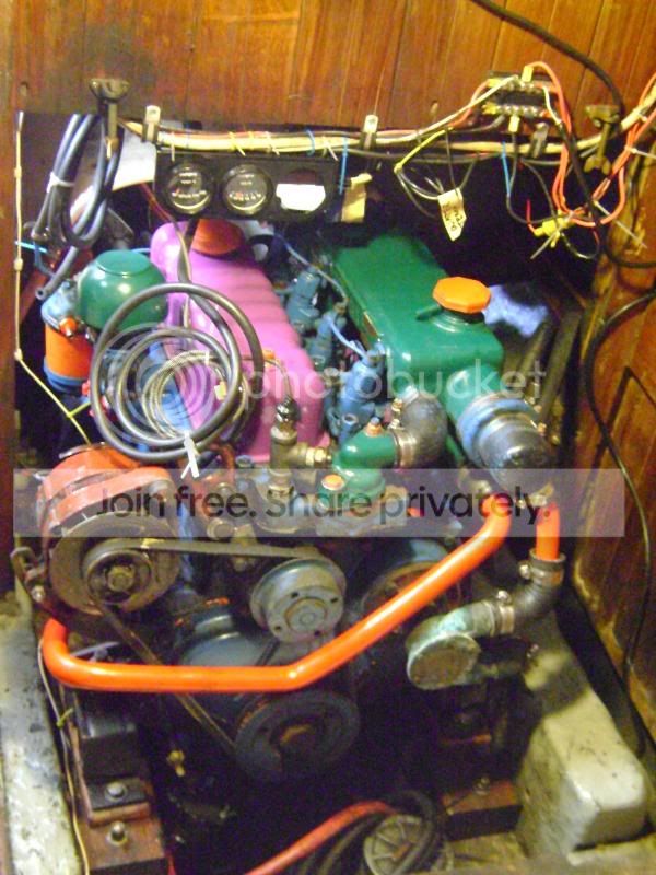

Green Thing on right side => heat exchanger?
Is the "green thing" on the right side (as one is facing the picture), with the orange cap the heat exchanger? If so, it looks like there is a stub of a tube coming out the side just under the cap.
You write that this is a work-in-progress, but if it is, then should there be a hose to a container for antifreeze?
Otherwise, I have to say that this is the most colorful inboard engine I have ever seen.
One way an engine could get salt water in the cylinders is by sucking it in through the water lift muffler. One way this can happen is by cranking the engine too long without it starting. Has the oil been changed yet? If so, was there any signs of water in the oil?

never did have a overflo hose..might actually install one before we are done. yes that is where the antifreeze antiboilover and antirust stuff goes into manifold which contains heat exchanger.
riser is of adequate height to not cause ingress of water. engine never was hard to start. no water in oil, merely diesel fuel in oil. we had black diesel in return line. never cafe au lait nor mayonnaise. out exhaust was only ever black smoke...40hours into that last passage from zihuatenejo to here--took 80 hour-- we had huge black effluent and smoke. the effluent looked like carbon. solid black.
immediately after runaway we changed oil, and again when we removed tankage for fuel. there was fuel in oil -- and return line fuel was black into tank. we figgered we had a fuel delivery problem as runaway ceased with cracking all 4 injectors. repair guy was there and said we were at max rpms, but i thought it was still increasing. at any rate, runaway was less than 5 minuets and stopped with cracking the injectors. no detonation and no water overheat. seizure was after runaway while sitting 5 months patiently awaiting repairs. we had both fuel pumps rebuilt and th e transmission heat exchanger, the housing of which fell apart in hand, and innards were beautiful. we also inspected the water heat exchanger..took it all apart..looks clean and beautiful.
i am hoping it is merely head gasket resulting from runaway crossing fingers and praying to neptune and alll the sea going gods and guardian angels...and pirates of caribean and even the aliens.......BUT.......will let ye know what it is when we know.
the green mushroom on other side is out for decorating at present..lol....

all of what you guys said is all well and good. this was not a fuel line fix. this was a crack injectors fix.
it wasnt the engine blowby causing this it was injector pump grande fail.
then came the rest.
yeehaaaw.....
and so ka lunk , as i shall rename my gremlin riddled engine, is going to be silent for yet another month until we get more parts. like a head gasket.
we will also have the head examined...not the toilet, the engines head..lol
the appropriate wrench has been painted green and shall live on an attachment to engine in appropriate location.
who has time to don appropriate safety apparel when your engine is running at 28000 rpm.. rodlmffao.aint happening. you die with it if you are there.
is why my repair guy had pallor not color.
no it cannot be stopped by pinching fuel line.. that is wasted time and energy. go for the engine FAST or both you and boat will DIE.
pinching fuel line only does that which the now nonfunctional kill switch does. now , as you are burning only what is or was in your oil tank, kill the engine. injectors will do that. they are readily available and fastest way to kill the 29000rpm grenade to be.
tennis ball in a mushroom shaped air cleaner..not just no but****NO, as you first must remove that lovely mushroom and that is also wasted energy and effort. go for the first thing you are able to kill. injectors. or stuff a shirt into the mushroom and pray you havent any air leaks into engine...
do not wast time.
mine ranaway for less than 5 minuets.
no registered overheat(water system) and no BOOM.....now is just stuck.
nothing an old derelict boatwright cannot fix, at this time. it will just take a bit of time, as money is rare when disabled..lol...poco a poco.
