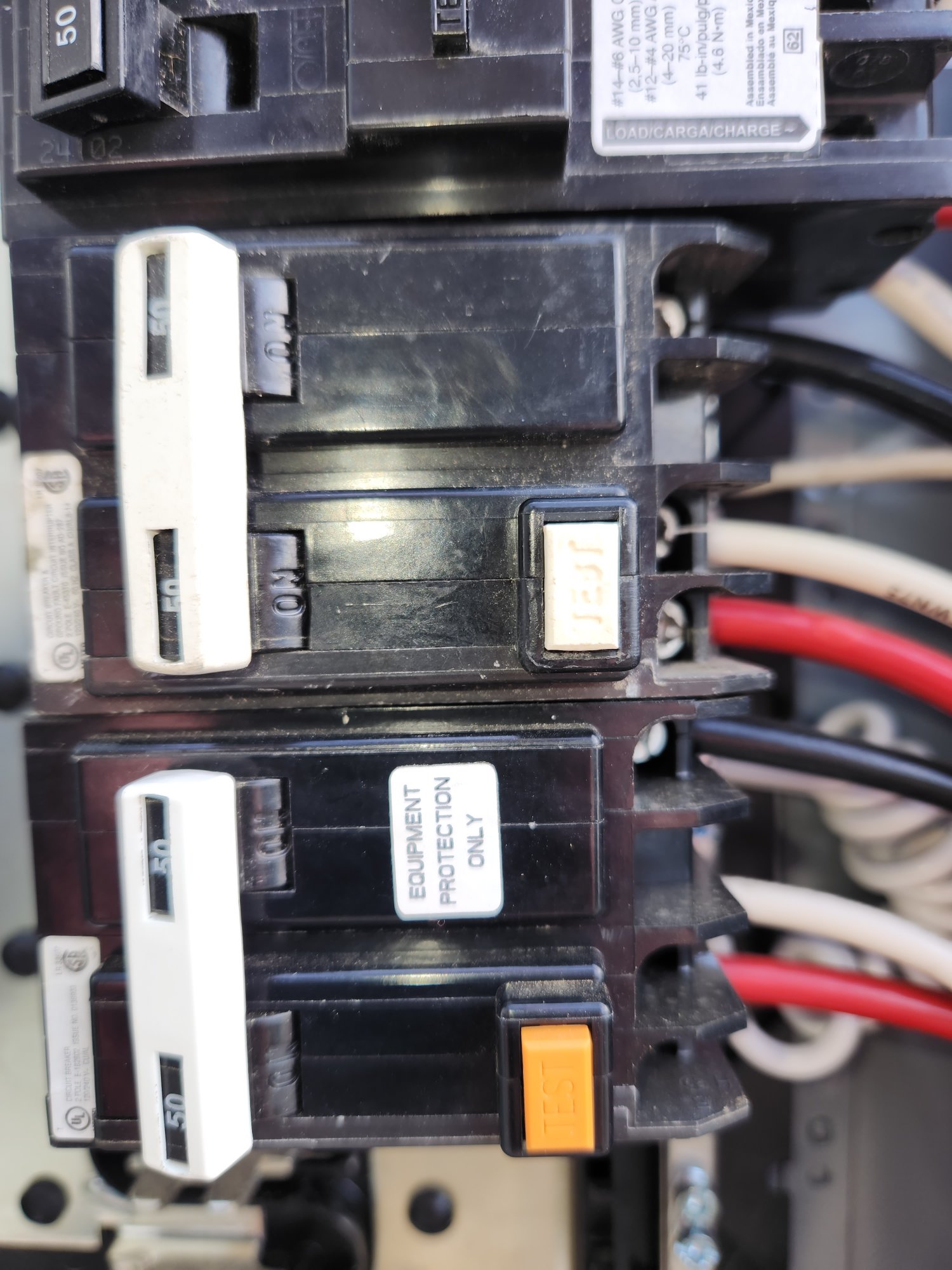

I think I stepped on some toes today when I got into the main breaker panel. Apparently I spoke to everyone except "the man" about my power issues.
The power was off at my boat again today. This is the 2nd time my house batteries have been ran below 50% & they've been ran flat twice.
So I did a little research and opened the main panel and took a few pictures. The breaker that feeds my set of pedestals is a 5ma GFCI it should have at least a 30ma GFPE breaker. After I shared this information with "the man" and the electrician was called and the breaker will be changed tomorrow. Hopefully this will be the end of this issue.
In the picture the breaker on top servers my pedestal and several others. Notice the breaker under it is a GFPE breaker and has a different color test button. I'm not actually sure the color means anything, but I suspect it does. The lable on the bottom breaker clearly shows the its not a standard GFCI.

An electrician came out this morning, he is also a club member. He didn't really want to replace the breaker but it tripped immediately after he reset it and I think he changed his mind.
Time will tell if this solves the issue.
A couple of of things to note:
1. He got shocked and the club is worried about me messing with it.
2. He said "a GFCI is a GFCI" implying that a breaker with a high leakage tolerance won't help. He could be right, we will see.
