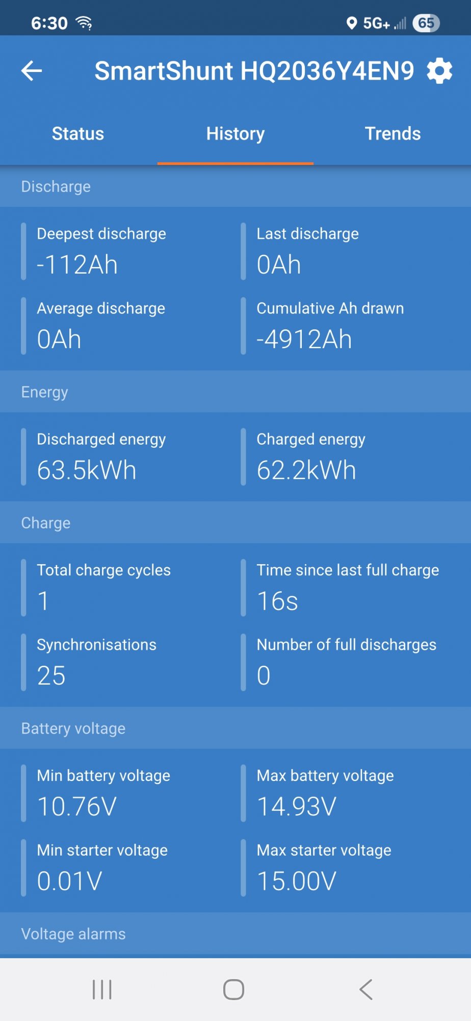

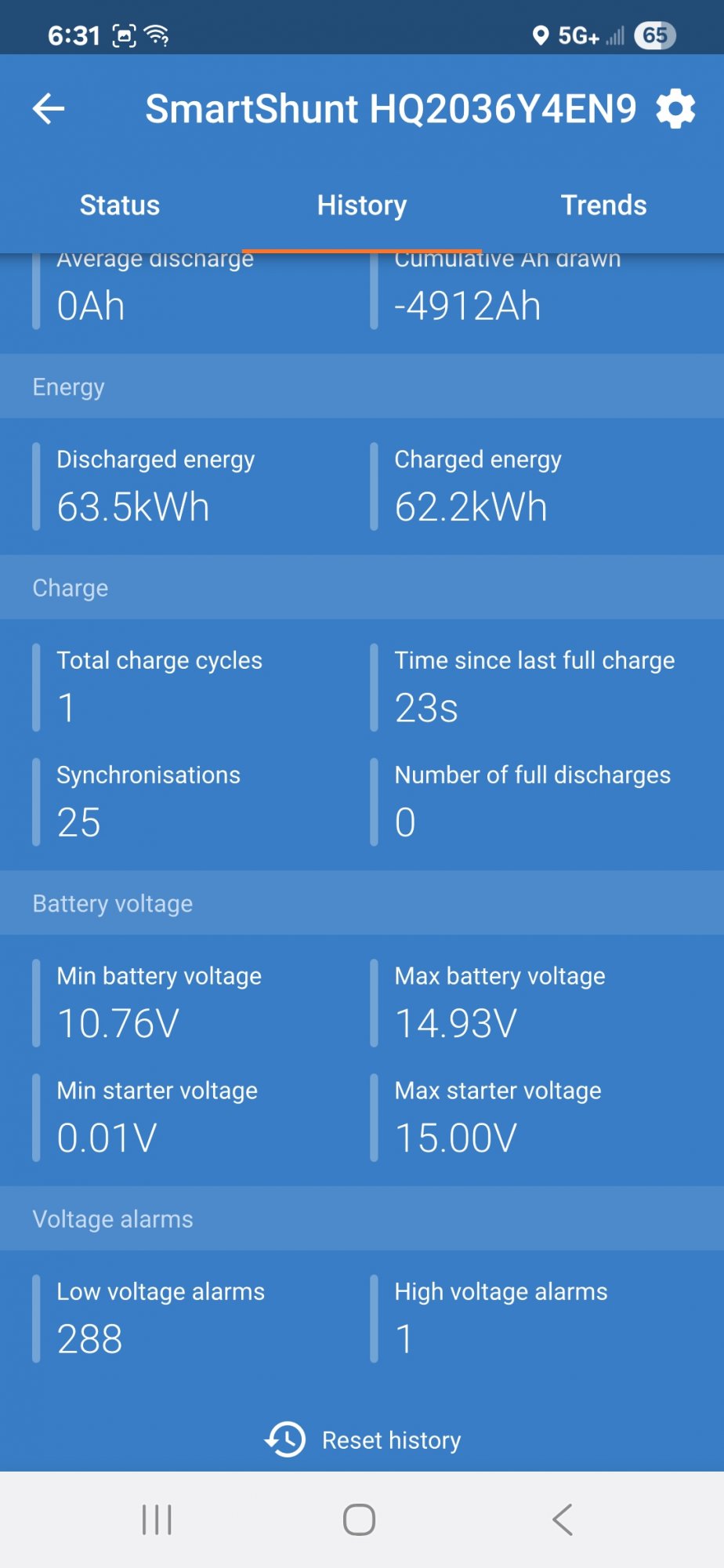

I moveed the boat to a new location, a sailboat club. So far my only complaint is the longer drive and the unreliable shore power. It seems that the main breaker for dock C, my dock, is tripping.
I keep a few things in the fridge, mostly drinks, and I keep the fridge on year round. This is now a problem because it runs the batteries flat,112Ah from 110Ah bank down to 10.7 volts. Another time 47Ah. This is gong to kill my house bank.
