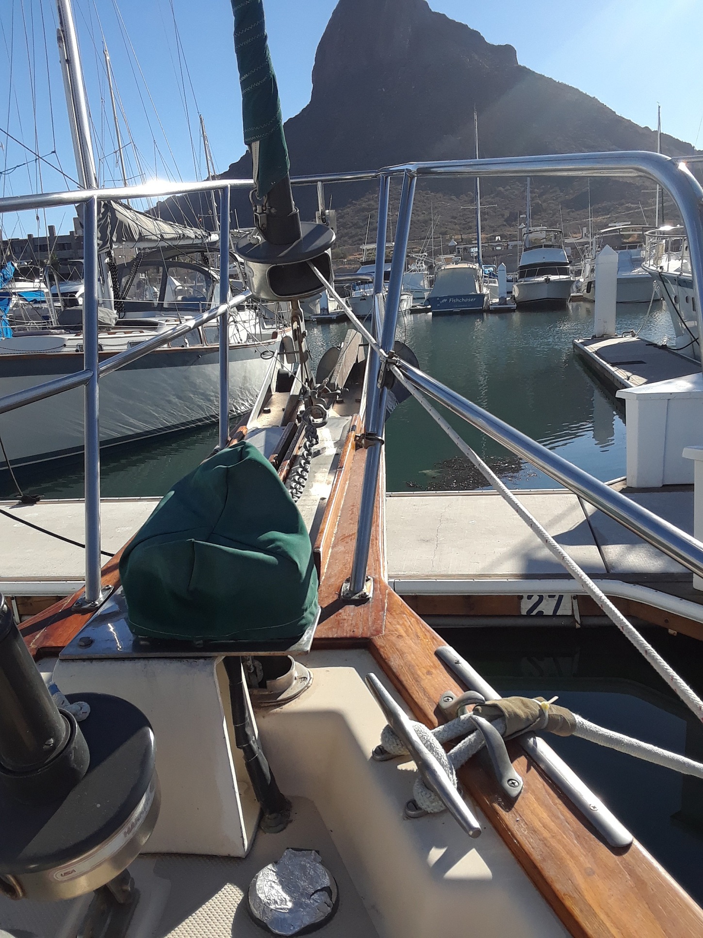

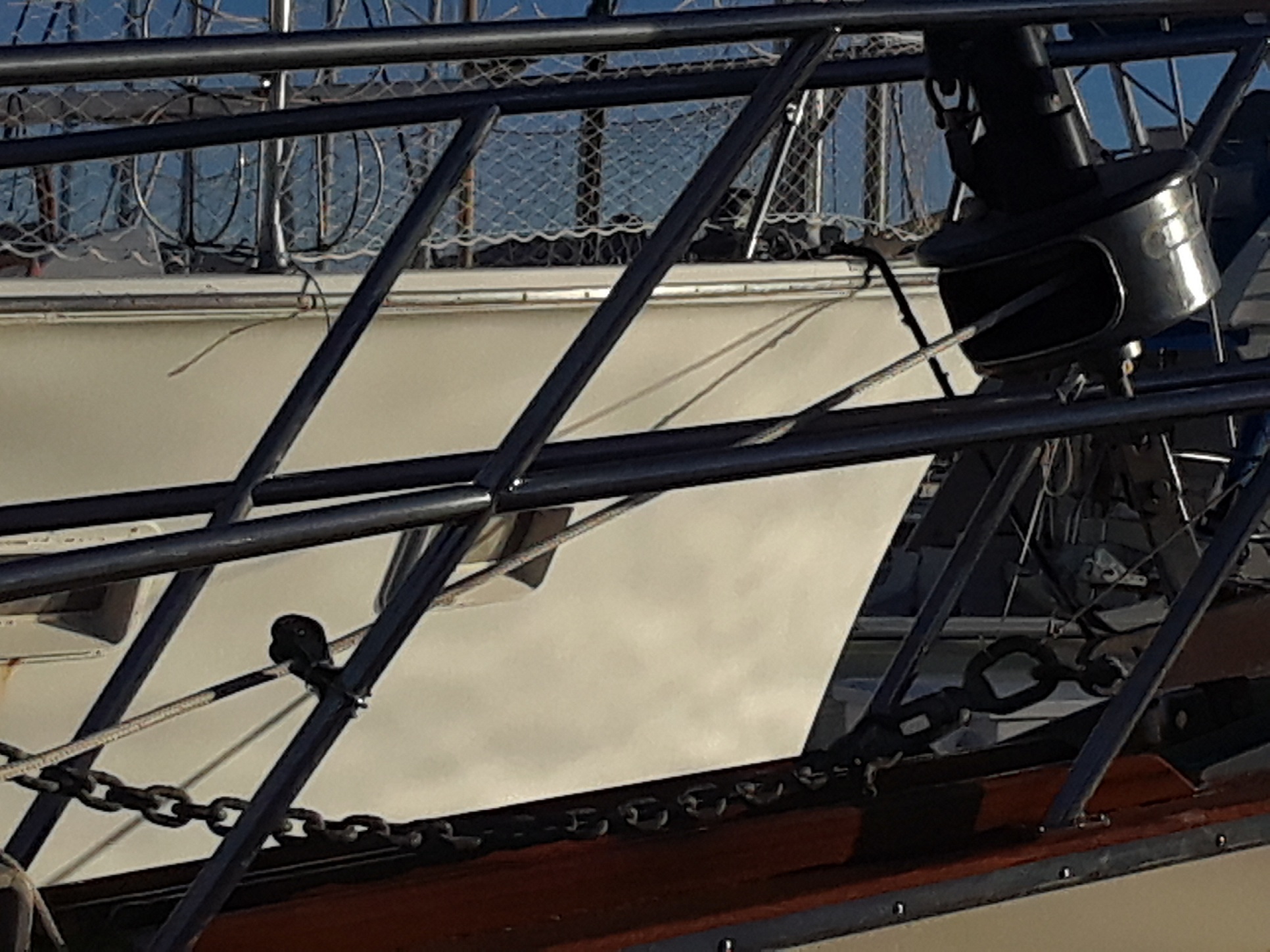

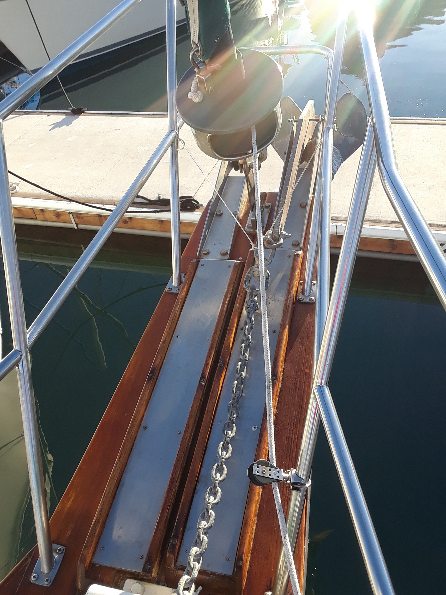

I've a stanchion-mount block on the pulpit that routes the furler control line. From the photos, you may be able to see that the line doesn't ride on the sheave.
What I'd like to put here is a fairlead of this type, but with the ability to overcome the pulpit's control of the AOA of the fairlead.
https://shop.sailboatowners.com/prod.php?13920
Has anyone seen a fairlead that has a swiveling/rotating hole for the control line to pass through, allowing less deflection, or would I have to engineer something?

The angle between that fair lead and the furling drum is precise in order to assure proper furling. It is the most important fair lead in the system. Looks like someone swapped out the OEM with that swivel block. The SBO fair lead looks like the original.

But when mounted on the pulpit, the SBO fairlead may deflect the control line's passage parallel to the pulpit rail angle. That's what I'm overthinking about here. :biggrin:
Could be that the hole in the SBO product is large enough for the smallish (3/8ths?) control line to live with the deflection.

I do need a fairlead there. Here's another photo showing the lead from the next fairlead back.

Like I stated earlier, I may be overthinking the whole thing. It's the bullseye's orientation in relation to the control line's preferred angle that's giving me pause.
I think I'll still buy the bullseye and have a go at Jerry-rigging the proper angle of the lead.

If that block is fixed in position could you run the furling line through the bottom of the block instead of the top. I know it isn't "Right" but the line would lay over the sheave before subtly turning past the stanchion. The extra distance away may keep the line from rubbing on the stanchion as it appears to do now.

it would seem that the fixed bullseye lead would be perfect there... so im not sure why it may be preferable to have it articulate.
the lead on the line to the drum is so slight that there would be very little friction, and my view of it from the photo, shows the line could nearly run outside the stanchion and not need a lead at all... EXCEPT the sag in the line between the drum and the turning block (that we cant see) that is aft of the lead-in block would cause the line to spool at the bottom of the furling drum.. which is why the bullseye should be a fixed mount, to hold the sag out of the line so it leads perfectly to the middle of the drum, rather than a mounting that would allow the line to furl in any way gravity wanted to lead it on to the drum...
