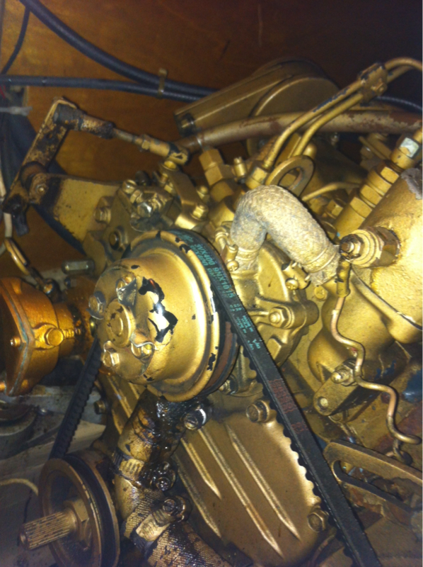

This is related to previous post pump failure.
I've found about 4 different Kubota part numbers to replace Universal part number 300203, coolant pump. Motor is m18. 300203 also fits m25.
One Kubota pump had threaded outlet, another is nipple. Also revisions.
Which one do I need? My pump is all hoses. I can guess nipple but need expert advise from someone who has done similar. I've attached pics. BTW Check out the black liquid on the hose, throttle linkage and elsewhere, that's not oil but burned coolant and belt bits mixed.

Yeah. My confusion too. I think it may (or may not) have to do with the top bypass output. One has a threaded output other is a nipple. Some use that for a water heater circuit. But my water heater hoses insert at the heat exchanger. So the pump bypass just goes to the thermostat 3 inches away (see pics). Therefore I guess need the nipple version.

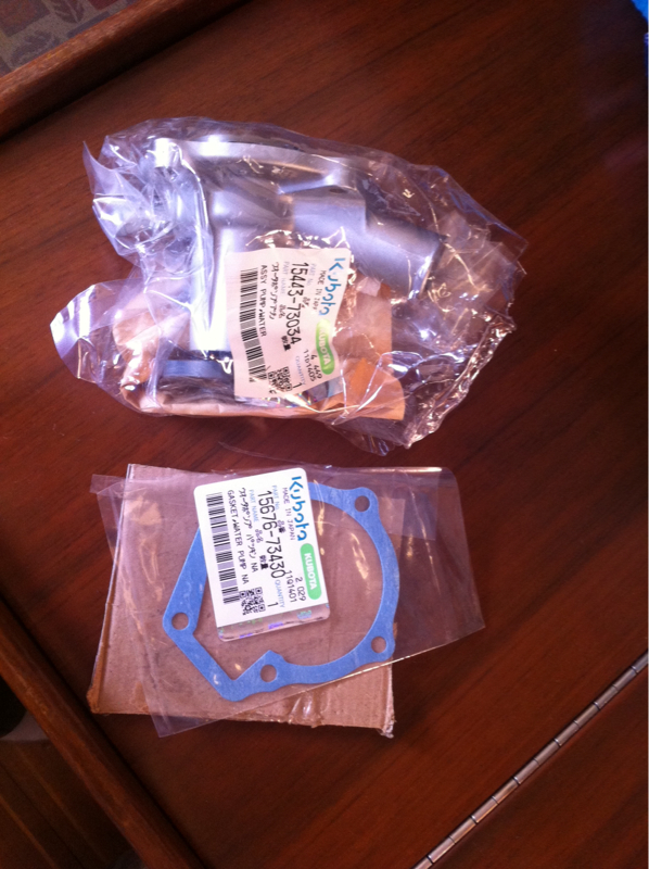

Ok obtained the pump.
The latest version is part num ending in 34 instead of 30. Pics. This is the one with the nipple for hose bypass to the thermostat.
The pump from Universal (TOAD) num 30023 was $424 plus $10 for the gasket. I got original Kubota from Yachtsupplydepot for $122. And they tossed in the gasket no charge - reg $1.90.

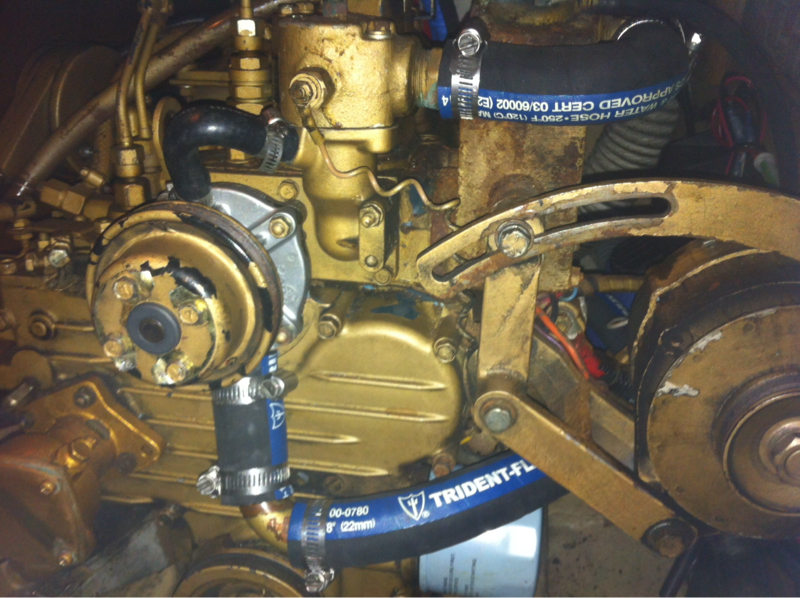

Yay! New water pump and hoses. Pic. Pump thanks to you all.
The hoses were a disaster. It raised suspicion with the original gold paint from when the motor was made 31 years ago, but when I got them off there were protruding wires, rust from the wires, depressions, and general fatigue. All hidden. Yet, they never leaked a drop.
Yassir, I change out my hoses every 31 years, whether they need it or not.
