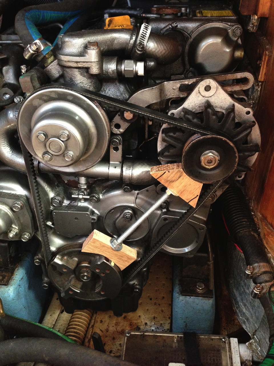

This is a pretty simple job. It involves 2 bolts. The challenging part is keeping the tension on the belt while tightening the belt.
  1. Loosen the adjusting bolt at the top of the alternator.
  2. Loosen the pivot bolt at the bottom of the alternator.
  3. Remove the old belt, the alternator may need to be slid to the left a bit to get it slip off.
  4. Install the new belt.
  5. Slide the alternator to the right to get to the proper tension.
  6. Tighten the adjusting bolt.
  7. Tighten the pivot bolt.
  8. Go Sailing.
To make tensioning easier, for a couple of dollars you can make a tensioner or belt jack. It is a piece of ⅜" all thread, a couple of washers and nuts and a couple of wooden blocks, hard wood like oak works best.

The belt jack he suggests will make it a lot easier than trying to tension the belt with a prybar.
The krikit guage shown at the bottom of his second attachment is useful to take some of the guesswork out of setting the tension. Since you "hate guessing" you might get it. You would want the one that goes from 30-160 pounds.

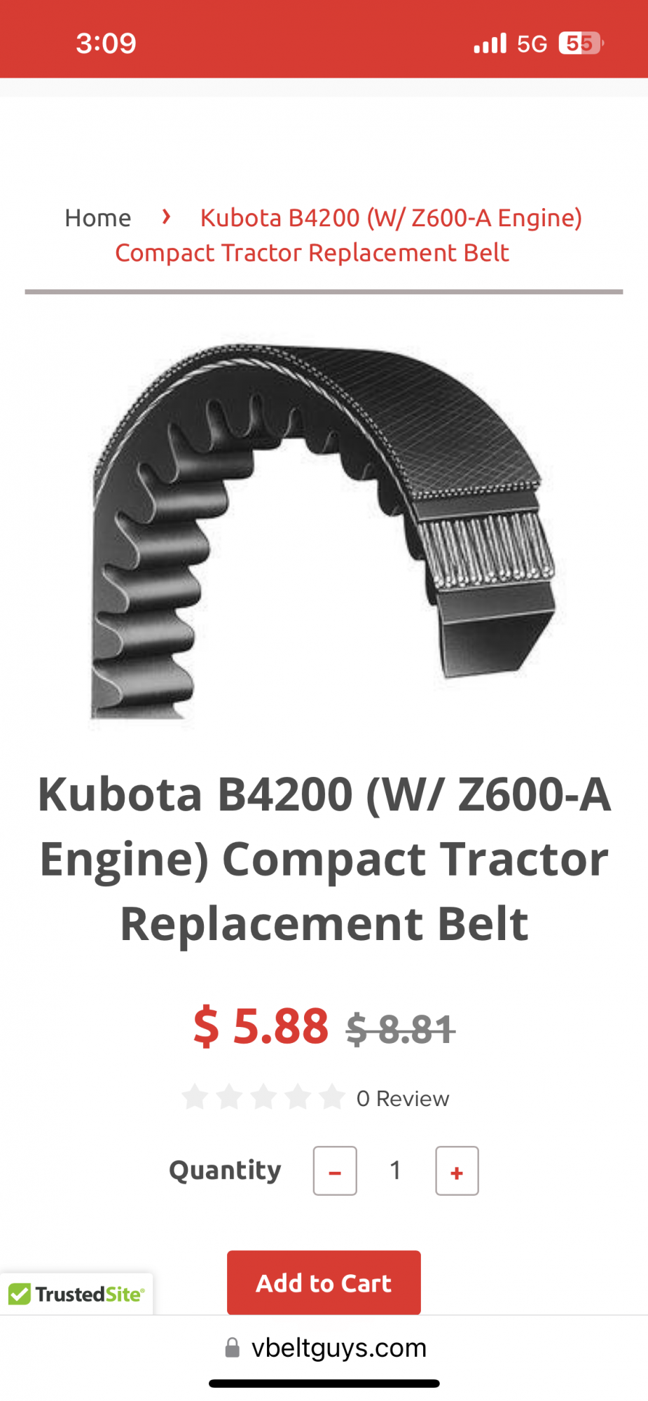

I think I figured out how to post to the thread. I hope this works. First I am in complete awe of the help that people offer on this site. It’s inspiring and reminds me of all the good in the world. There are a lot of incredible people in the world we just hear too much news about all the bad things. I posted a video of my loose belt on a separate post…that’s where the belt dust comment comes from. It looks like they changed the number on the belt it’s now Kubota B4200… see photo. After I install the belt should I post the results on how it went ? In case you are curious. Once again I really appreciate all the help…you guys ROCK !

NAPA belts are good, made by Gates and other reputable manufacturers, just as with their oil filters. If you are getting dust from a properly tensioned, good quality belt, you probably have a pulley alignment problem. For tension, I bought a Gates Krikit tension gauge.
