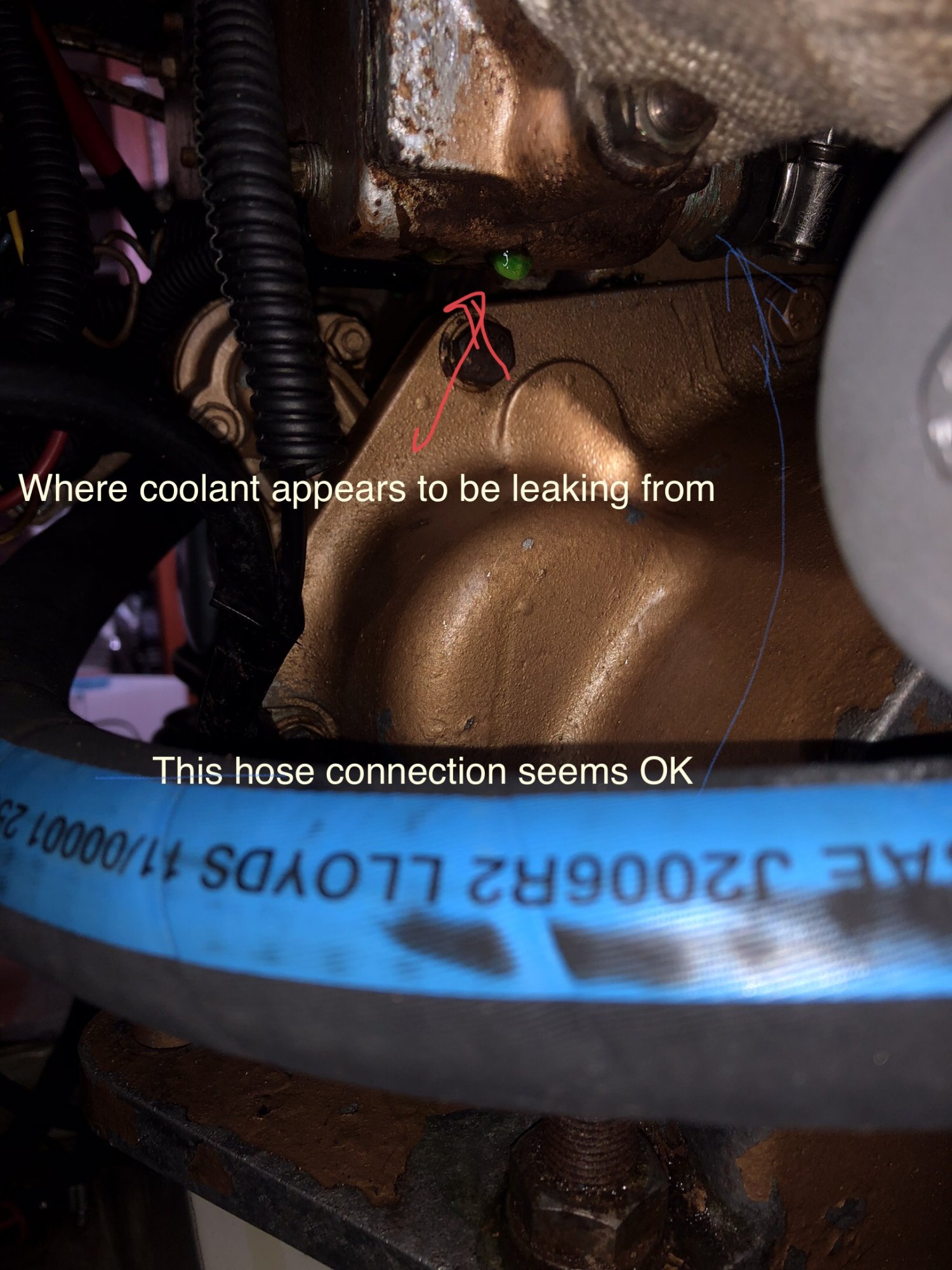

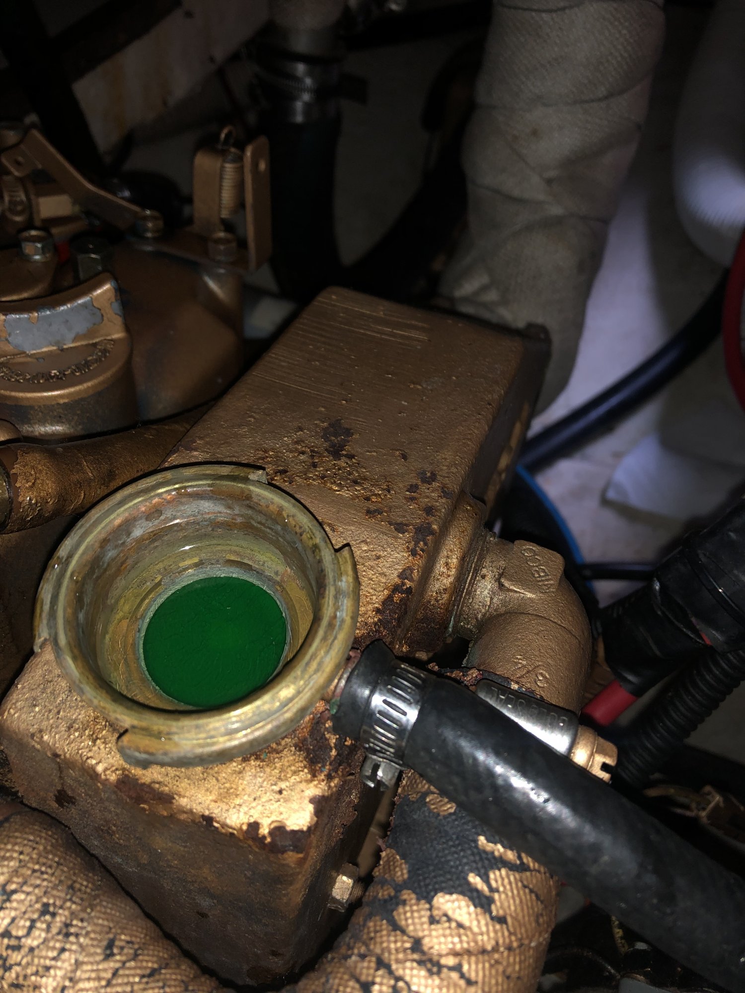

M18 manual says the coolant capacity is 3 quarts. I changed the hose. I added about 1.5 quarts which filled to about 1 inch below manifold cap as shown in picture 1.

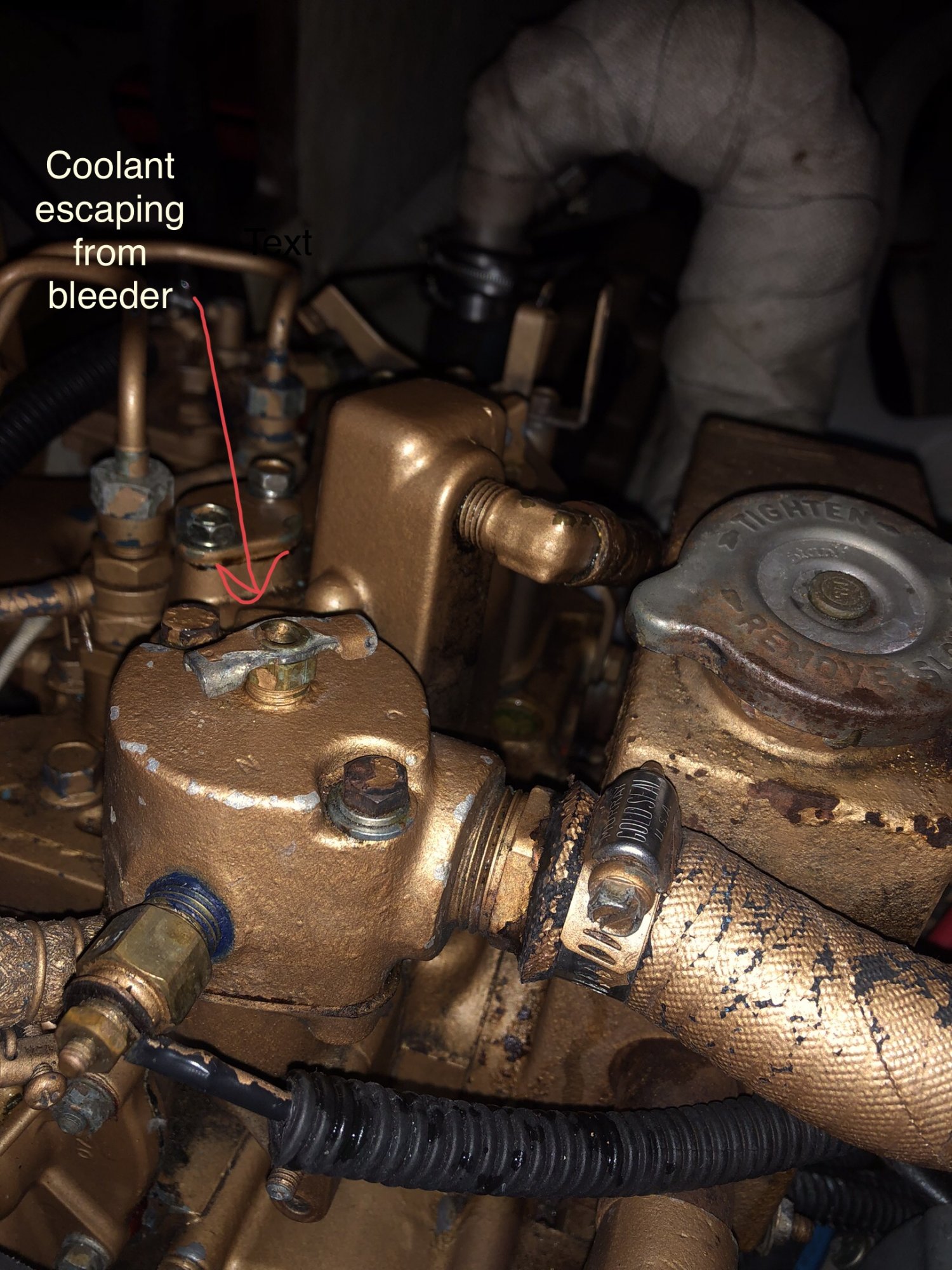

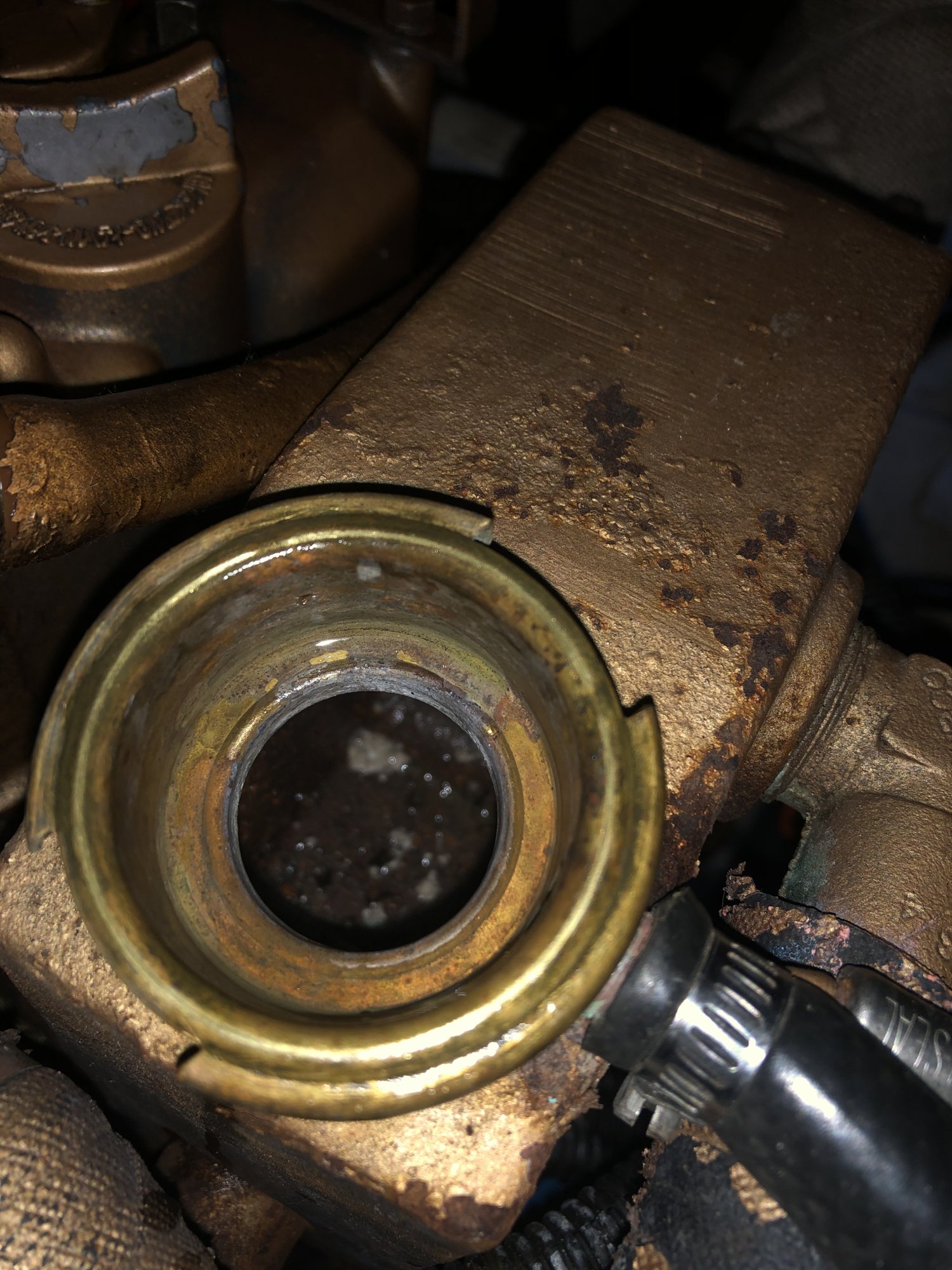

I ran the engine at idle waiting for temperature to rise but the temperature gauge was sticky and jumped from < 120 F to > 280 F. I immediately shut down the engine, waited for it to cool down and checked the manifold which looked empty. See picture 2. I added more coolant back up to 1 inch below manifold cap and idled the motor again.

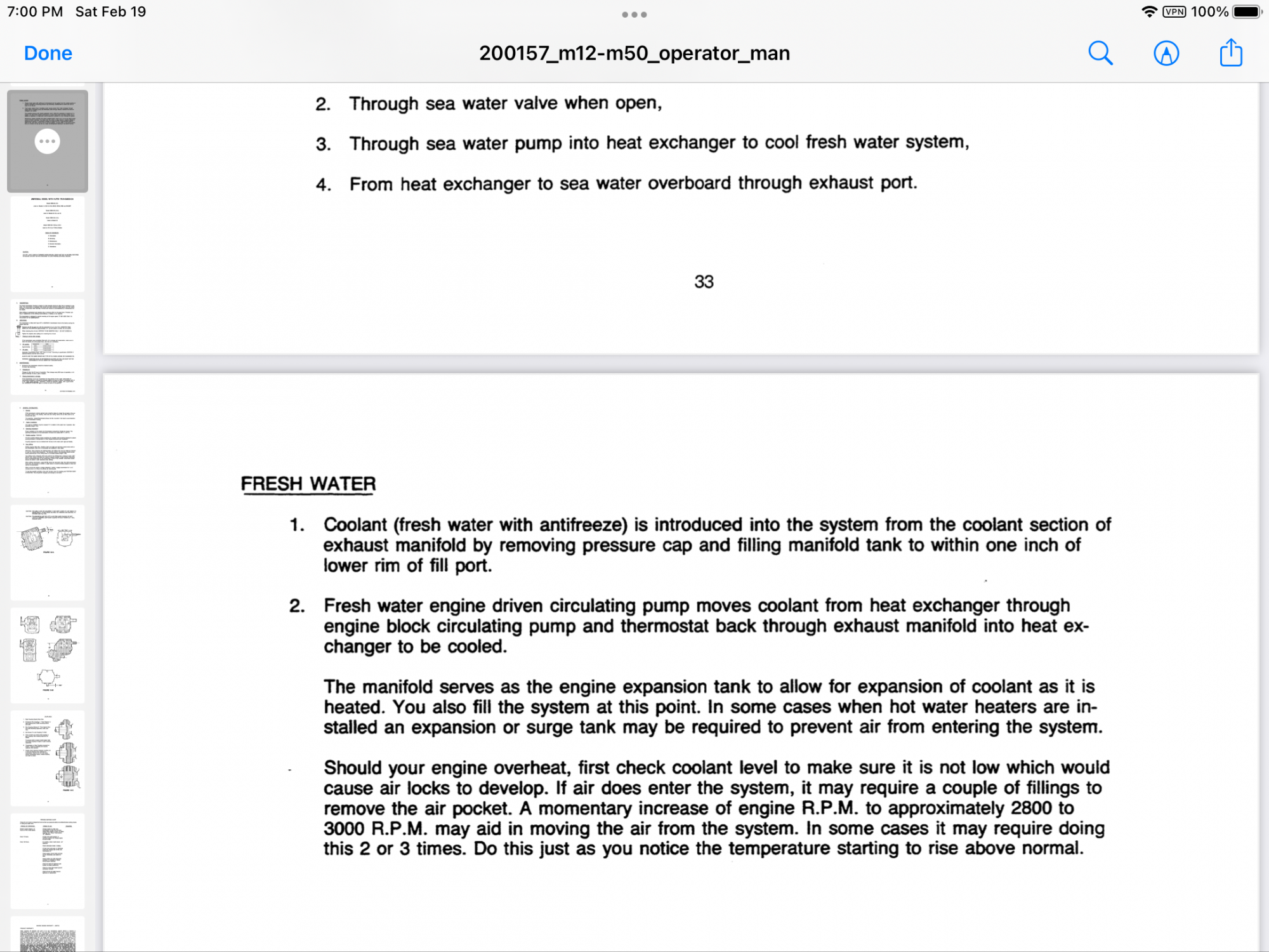

At low idle and low temp no coolant would escape from what I think is the coolant bleeder. I’ve run the engine at idle for several minutes while warm but not hot with coolant bleeder open and closed. As soon as I increase above idle or temperature starts to rise, coolant will start to leak from the coolant bleeder valve. I’ve tried running the engine to 2800 to 3000 rpm for a few seconds to try to remove air as described in the manual but coolant continues to leak from the bleeder despite trying this several times.
