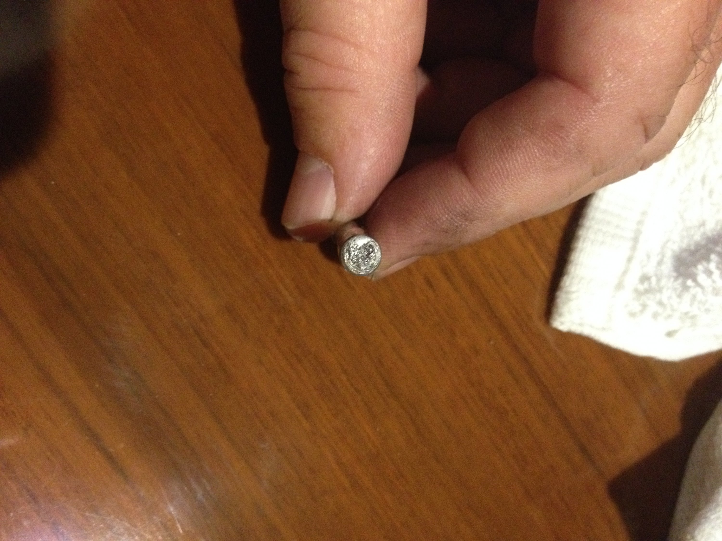

First thing I did was check that fuse holder again. This time, I looked at the fuse. Something odd - Saw it had been arcing. For a long time. (Picture)
Replaced the fuse holder with a heavy marine grade thing I had in stock.
Aaaand.....
It was the fuse holder the whole time.
Motor starts right up repeatedly now. It even sounds different. Like it's engaging faster. A clean snick and start.
