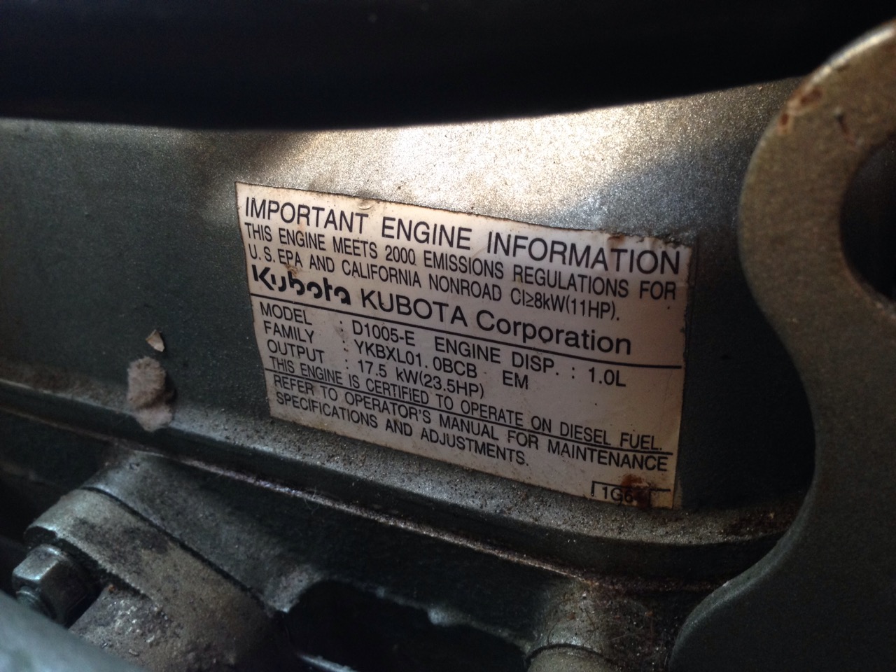

Look for a sticker on your valve cover. It will tell you what model of Kubota you really have.
May 2, 2012
276
Catalina 310 Toronto, Ontario

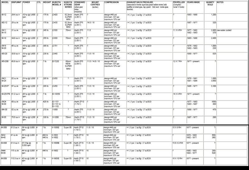

M-25XPB - Kubota D-950 - D1005.
I've got to a point that I just go to the Local Kubota dealer with the actual part and they have so far been able to match the parts. The BIG plus it is usually a 1/3 of the price.

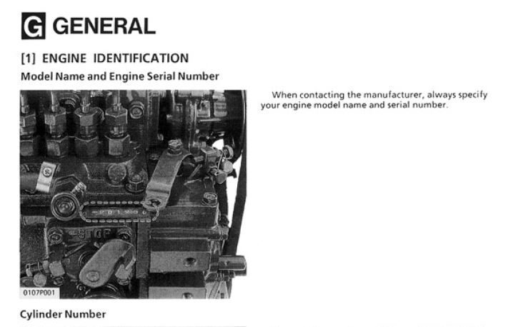

Bingo. Another source can be a local industrial diesel repair shop. A few years back when my M-25XPB injector pump failed (instant shutdown, no hesitation or sputtering) the marine distributor wanted over $1500 for a rebuilt pump, the local shop had the parts in stock and did it for $540 parts and labor, and did it in 2 days.
I was able to give him the Kubota model number cross reference.
Attached are a couple files with engine info I found. Sorry about the poor resolution on the engine data file, it was the best one I found.

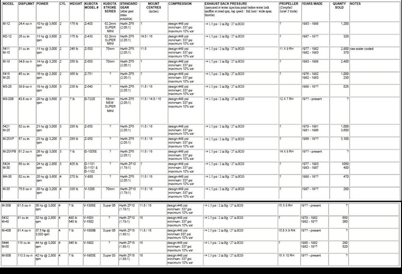

Good day PlaneTom .......... any chance of getting the URL address where you picked up the Kubota engine Data sheet.
Cheers
2 Old Pirates
Oct 4, 2014
90
Catalina 310 73 Monterey
Cheers
2 Old Pirates
Sorry, I just did an image save and changed the title, so I don' know where it came from.
It was 5 or 6 years ago, and I came across it on a forum somewhere as I remember.
I tried a Google image search and came up empty, but I'm not familiar with that kind of search and possibly didn't do it right.
