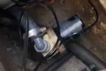

Don't bother, here they are;Maybe you can find you engine manual in the "downloads" section on this site.

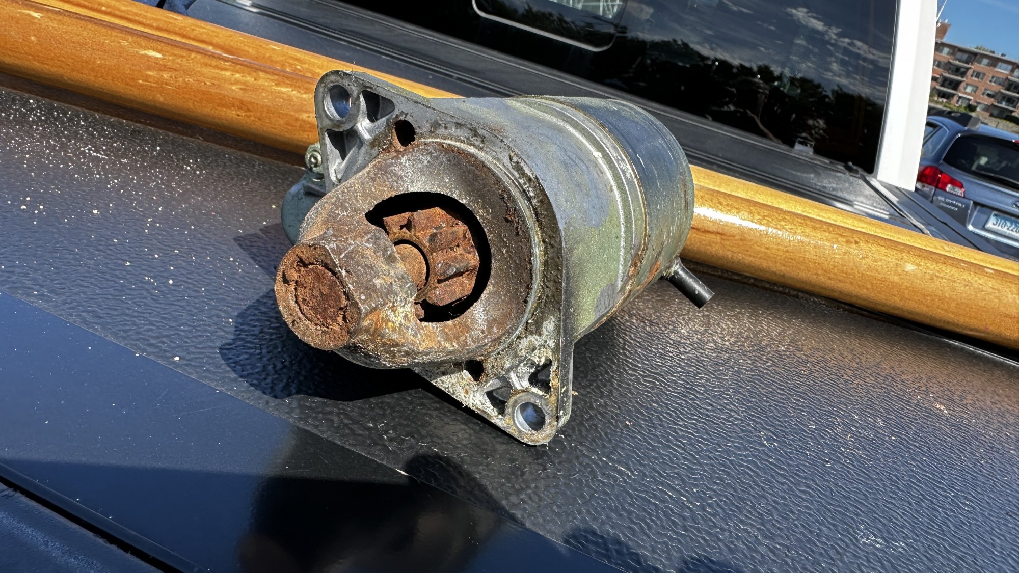

I wish I could say that will polish right out but I don't think that's the case here.Think this the problem?
Yikes! There must be salt water leaking in there, no?Think this the problem? Thanks all for the insight! Well, this wknd shot. Next week we’ll be up and running.
The starter solenoid is not engaging the motor, the motor is spinning but pinion has not been pushed out to contact the flywheel, replace the solenoid if it has one, it could be a rusted pinion shaft. try to move the pinion on the shaft, it should be easy movement.Anyone recognize this sound from starter? Was running fine 2 weeks ago.
