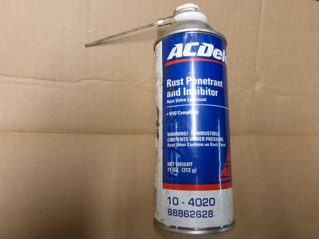

PB is ok, but try the GM product I posted above next time. I've built many many street rods from the 30s to late 60s, over the past 40+ years, so I've pretty much tried every rust buster ever produced ;) . The GM product beats them all, hands down, and also works well on stainless bolts and aluminum bits. Kroil would be a close second, but it's harder to locate locally for most people, and some have said they think Kroil actually makes the GM stuff for them anyway.

I have many products in my tool locker that are 'penetrants' I'll have to get a can of that GM product and give it a try thanks.
