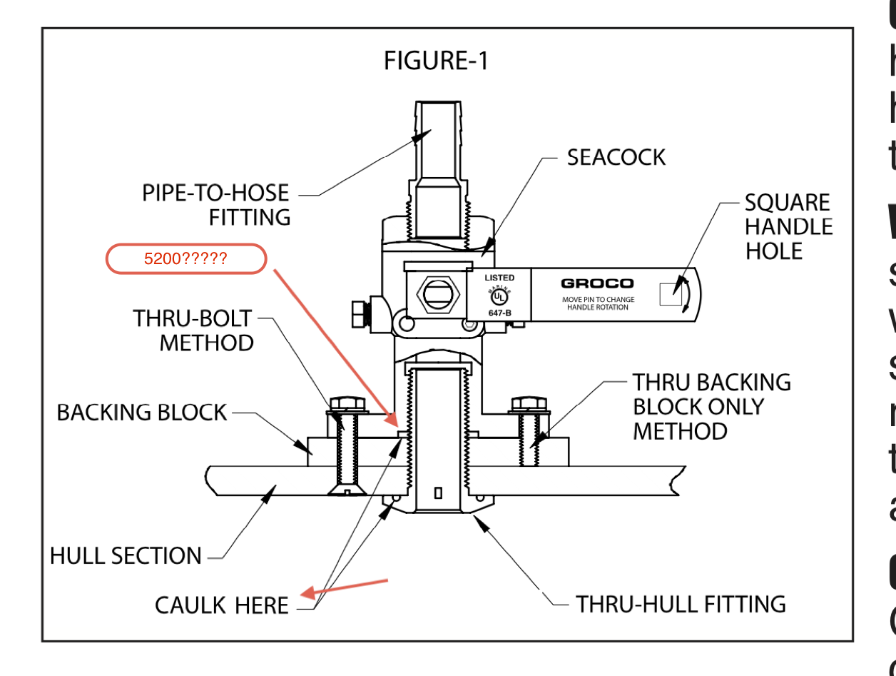

Second Star has a leaking Groco ball valve. The leak is not in the ball valve mechanism rather it leaks around the tailpiece. It only leaks when the valve is open and it is sufficiently below the water line so that there is water in hose when the valve is closed.
I've tightened the tailpiece and replaced the teflon thread tape, neither of those have worked. Over the years the leak has gotten worse. My suspicion is the threads have deteriorated and can't be sealed well enough any more. The valve needs to come out.
The problem is that it won't unscrew from the through hull fitting. Even a big pipe wrench can't budge it. There is no access to the threads so PB Blaster won't work. Any suggestions on freeing the valve from the through hull? An oscillating tool and metal blade will work, but I'd rather take a less destructive path.

Thanks for all the suggestions. First, the only way I would attempt to remove this while in the water would be if the keel was firmly planted in the mud. I have seen how much water can come in through a hole in the hull. Also, I live in Central NY, the ice has just gone out and it snowed a 2 weeks ago. Too cold to put the boat in the water.
I am quite certain the water is coming up through the threaded portion of the tail piece and not coming down the hose. The hose is new and is removed and inspected every fall, it is the intake for the head. I can see the water coming up from the the hole. It has also gotten worse each year which would be consistent with corrosion or threads failing.
Heating isn't really an option, the seacock is located in a small enclosed space. Easy access to open and close it, but not so much for a large wrench.
I was hoping for a non-destructive way of removing the valve so as to not destroy the mushroom through hull fitting, but that is only a $20 fitting and if I am correct the valve is toast so destroying it isn't an issue.
Finally, I took some of my own advice and RTFMed. If Sabre installed the through hull per Groco's instructions there is a sealant (5200?? :() on both the outside of the hull and the inside so that the valve is glued in place. See the drawing. The valve flange is lag bolted to backing plate.

Can you heat it from the outside? Take the hose off, open the valve and stick a heat gun (or hair drier if you are worried about melting the boat) in the thru-hull. Hold a finger on the hull beside the thru hull until it starts to warm up then have at it with a wrench.
14,192
It is only a ¾" fitting and I don't think 5200 or the other caulks will soften enough to work.

If you are sure its the tail piece and you can remove it, have you inspected the threads? I don't like to put too much twisting pressure on fittings as I don't want it to budge and break the seal. And would be very apprehensive of adding heat as it may soften sealant and damage seal. But if just keeps getting worse take the opportunity and just cut the bastard and replace the whole thing.... mushroom and all!

I have removed the tailpiece and it looks OK, I think the threads in the valve are the issue. Once I found the installation instructions and saw the caulk on both sides of the hull, I realized that a non-destructive approach was going to be more frustrating and time consuming than I have patience and time for.

Dave,
I changed a couple thru hull fittings, valves, and tails on my last haul out in November. I used a grinder on the outside of the hull. Bronze is fairly soft and I was able to cut off the mushroom portion of the thru hull fitting in about 3 minutes. The concave surface of the mushroom that faces the hull is filled with sealant; therefore, just grind the mushroom where it intersects with the actual thru hull portion. The mushroom falls off and you can remove the remaining thru hull portion, valve, and tail from inside.
Simple and quick, no scraped knuckles, and no swearing; of course, you're out a few bucks to purchase a new fitting. Seems that there is never enough room inside the boat to remove them nondestructively.

Thanks, hadn't thought of that approach. I might give that a try if it ever stops raining.
